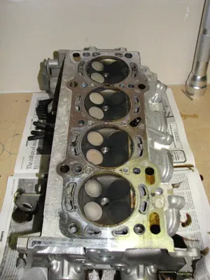

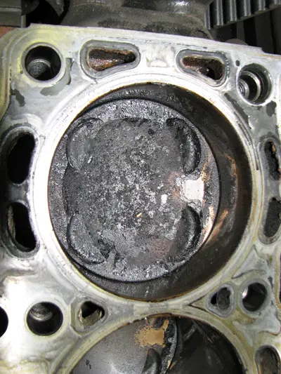

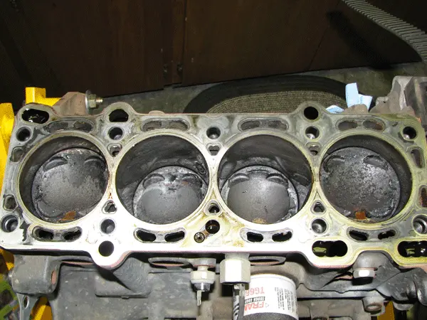

Removed the head found a mess...
I am no expert I am learning as i go along here, number 1 cylinder as you can see has quite the carbon buildup compared to 2 3 and 4 I searched my head gasket and there are no signs of oil leaking through that from the oil passages so if my brain is correct its gotta be coming either A: from bad seal on the rings or B: Coming down the valves. Anyone have any input?
