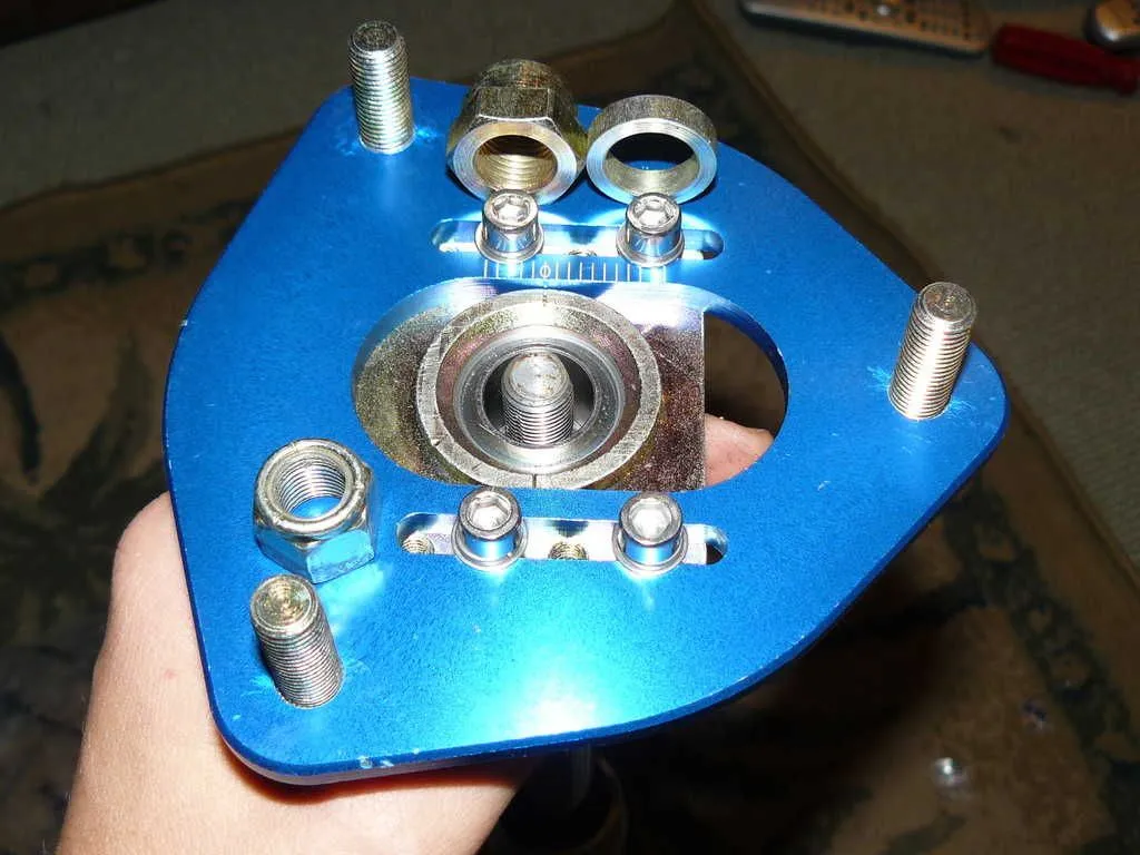

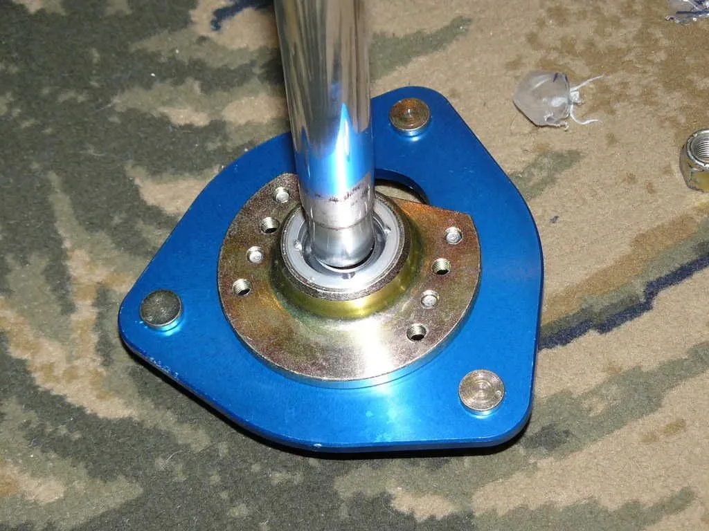

The hole in the pillowball bearing is too small for the strut to slide in. The threads go in of course, but the smooth top 1.25" section of the strut insert is too large to fit. I will take a picture and show you....
Also the hardware that came with the plates is obviously not going to fit anything.
In the 2nd pic the hardware on the top was the included stuff, the original 280ZX nut is on the bottom.
Don't know man, my teins fit perfect. The only thing I can think of is either trying different ones. Or finding somebody with a lathe and maybe mill the strut down to the size of the bearing in the CP. If I was at home I would take some better pics, the two I have don't show it good enough.
Do the ground control coilover kit spring hats have a sleeve that the threaded top of the strut insert slide into? I saw some pictures tonight of some coilovers that had a small sleeve that protects the threads from the CP bearing, and the nut just threads on from the top.
