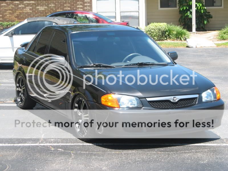

2000 protege with msp front end 03.5 front lip msp side skirts wing west rear lip and mp3 rear wing. so far before body work and paint here's the process..........
when i first got it
some modification
with front end
side view
and soon to be painted.....................

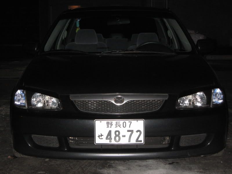

how much did it cost to custom fit dat bumper??? i want to do dat for mines
Hopefully not much because it looks exactly the same as it would look to install the 01+ bumper on a 99/00 without doing any work to the bumper.
i would think the sides of the 01-03 bumper on the outside of the headlights would need to be cut flat. that's the one thing that stands out when i look at it. 99-00 models the sides of the bumper goes straight across. shouldn't be that much, eh. easier to shave the edge off.
IT IS ACTUALLY A LOT OF WORK. I THOUGHT THE SAME THING, JUST CUT THE SIDES WHERE THE SIDE MARKERS GO. s*** IF THAT WAS IT THEN IT WOULD HAVE BEEN A PIECE OF CAKE. THE BUMPER IS ACTUALLY WAY WIDER THAN 99-00, ALSO YOU WOULD HAVE TO MOLD THE SIDES TO FIT WITH THE FENDER PATTERN. THE HEADLIGHT PART, HAD TO BE CUT ROUNDED TO FIT THE HEADLIGHT CORRECTLY. AND ON TOP OF THAT YOU WOULD HAVE TO CUSTOMIZE BRACKETS TO FIT THE GRILL CAUSE OUR CARS ARE A LITTLE SHORTER IN THE HOOD PART AND THE FRONT END IS LIKE 2-3 INCHES STICKING OUT. SO THAT HAS TO BE FITTED ALSO. OTHER THAN THAT EVERYTHING ELSE IS A PIECE OF CAKE. OHH AND THE GRAND TOTAL WAS 300 FOR THE FRONT END FITTED, SIDE SKIRTS, REAR SKIRT, TAP WELD THE OLD HOLES FROM OLD SPOILER, AND MAKE NEW HOLES FOR MP3 WING, AND SOME RANDOM BODY WORK.
Sorry dude I was in a bad mood when I posted that. Still... it could use some more work around the headlight and between the headlights at the hood. Or might be cause its light colored, your car is black, headlights are on and its a night picture.
yea the top of the bumper (between the grill and the headlight) is supposed to sit flush with the hood

btw would u have to cut the headlight part off both bumpers n mold the 99-00 protege part too the new bumper to make it fit???? idk,
o n does n e wun who selling a P5 bumper online
oic, im gonna just find me a bumper and bring it in hopefully it wont cost too much .... man can wait to see ur end results of your car.
wow...jealous, i really wanna do mines now, yours came so clean, look aggressive, how much was it from the dealership?
