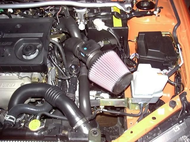

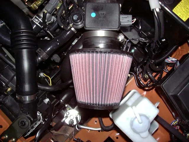

Very simple air filter mod that I did tonight while waiting for my CAI to get done. I just put a K&N filter directly onto the MAF sensor, and drilled a hole in the back for the IAT sensor. Sounds hungry now, can't wait to try it out tomorrow. I think that the turbulence from the intercooler fan may be a problem though. But the air there stays suprisingly cool.
BTW I did notice that the "tamper proof" seals are present on the BOV, however you car remove the entire BOV hose from the piping and replace the entire thing. I wonder what else I will discover as I prod along.
The exhaust is horrible in this thing. I put it on the rack and the radius coming out of the turbo is almost 90 degrees immediately. Then 6" into cat #1, O2 sensor, cat #2 then about 18" into a 24" resonator then into the Racing Beat piece. Something will have to be done here.

Note IAT location.
