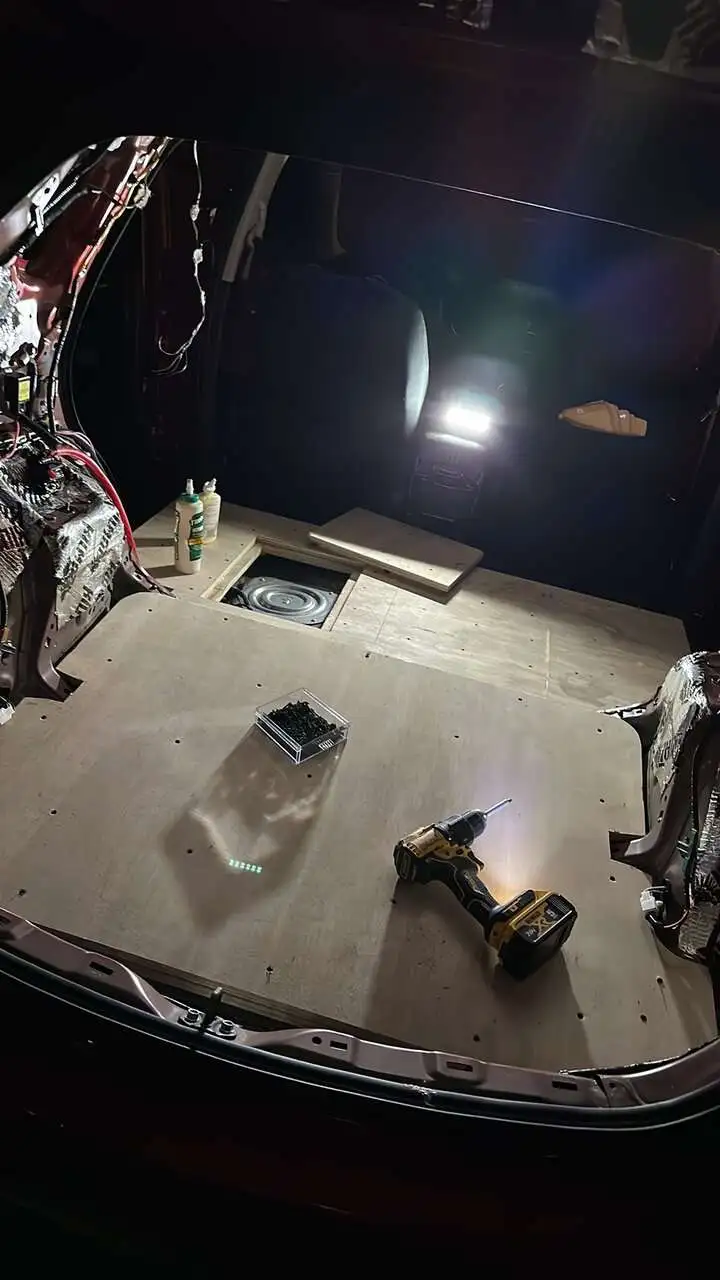

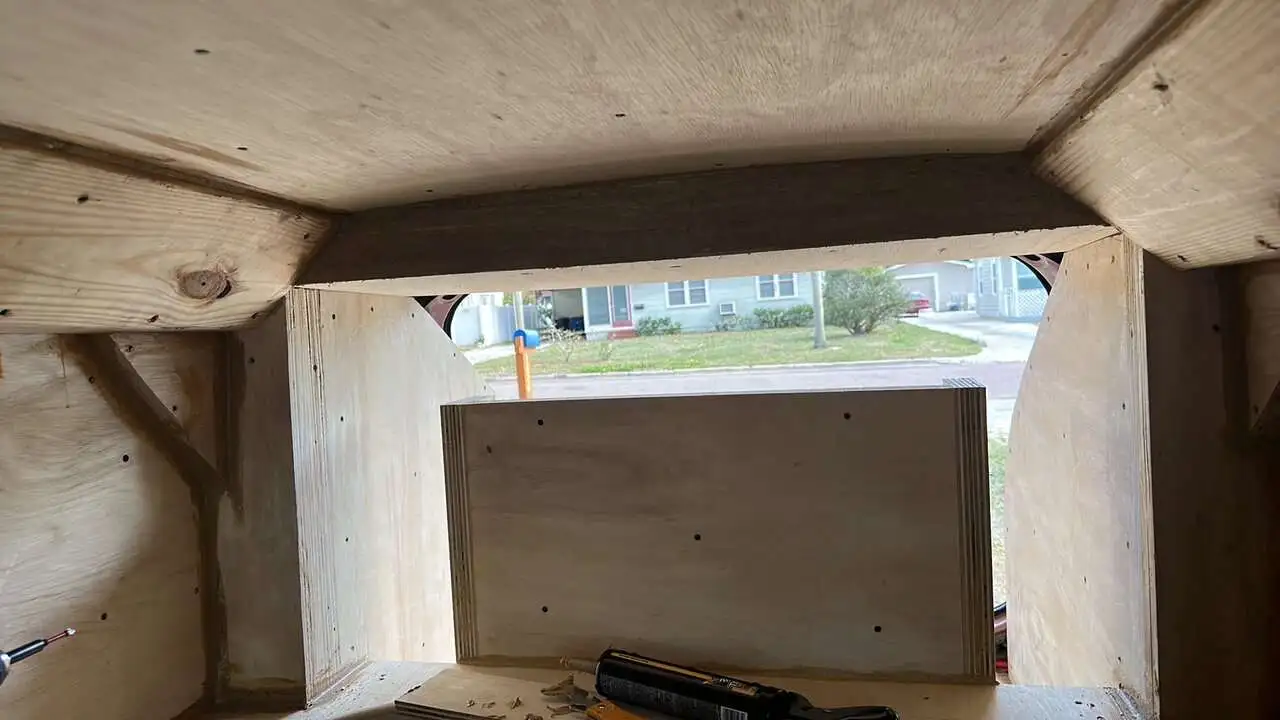

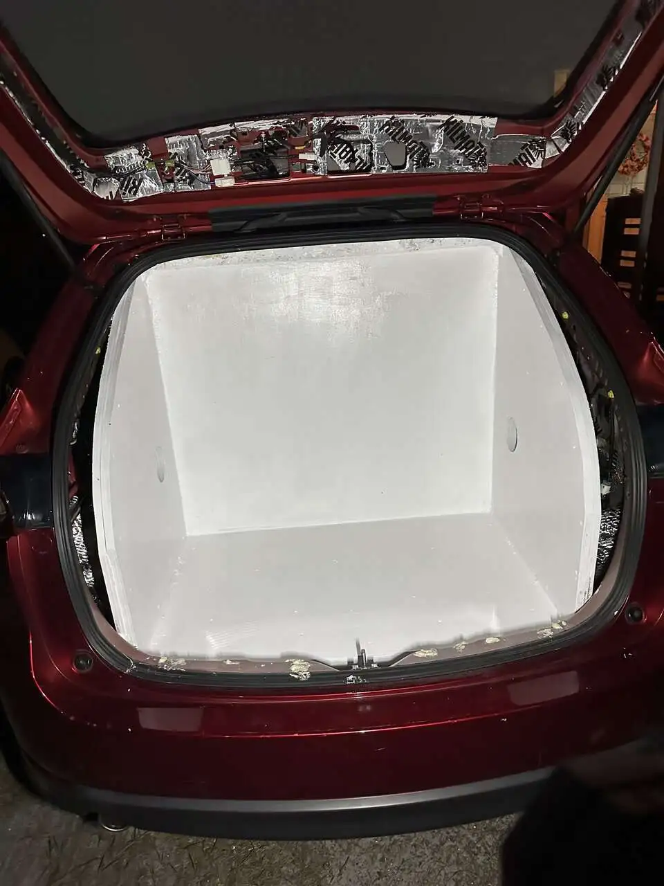

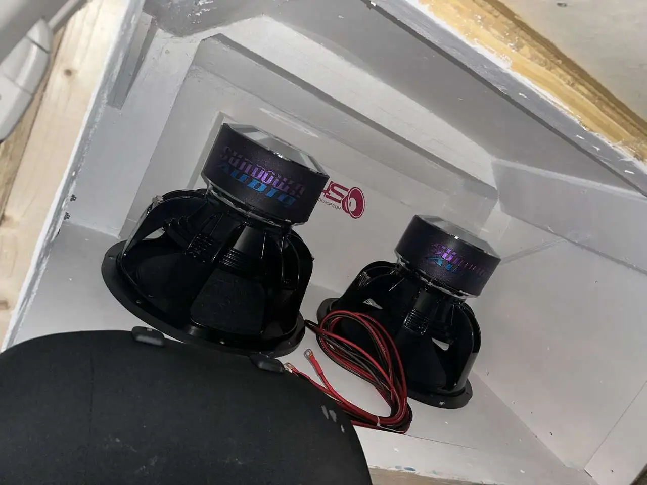

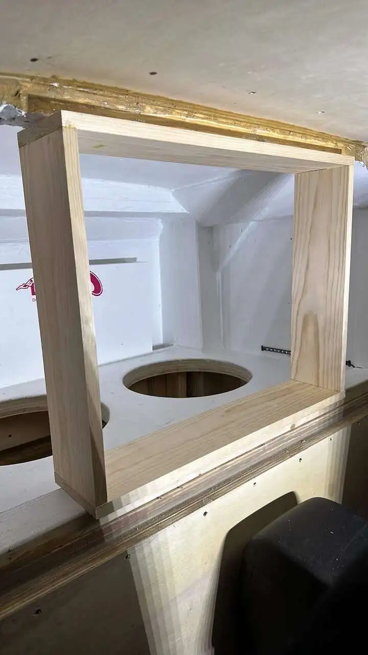

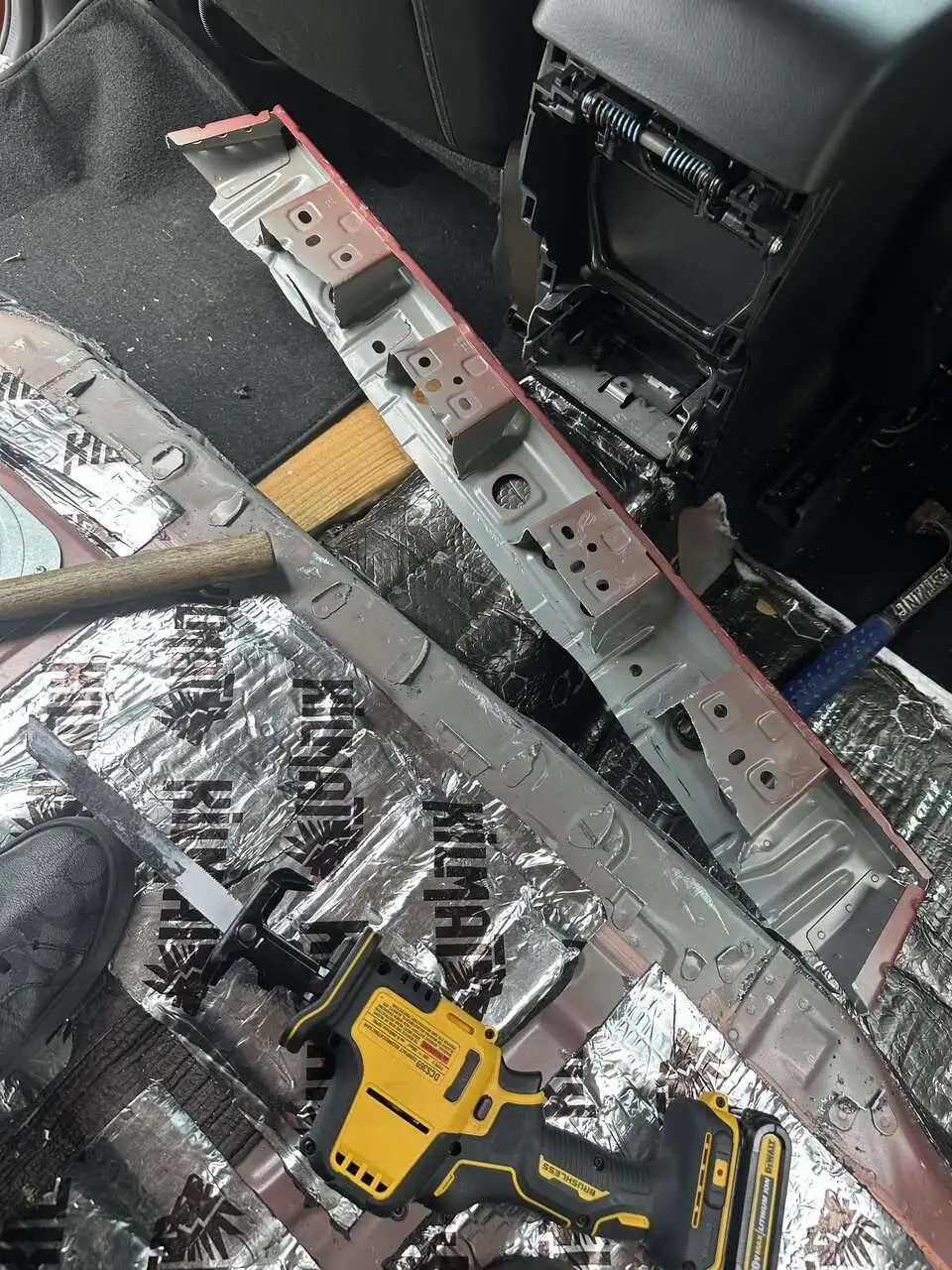

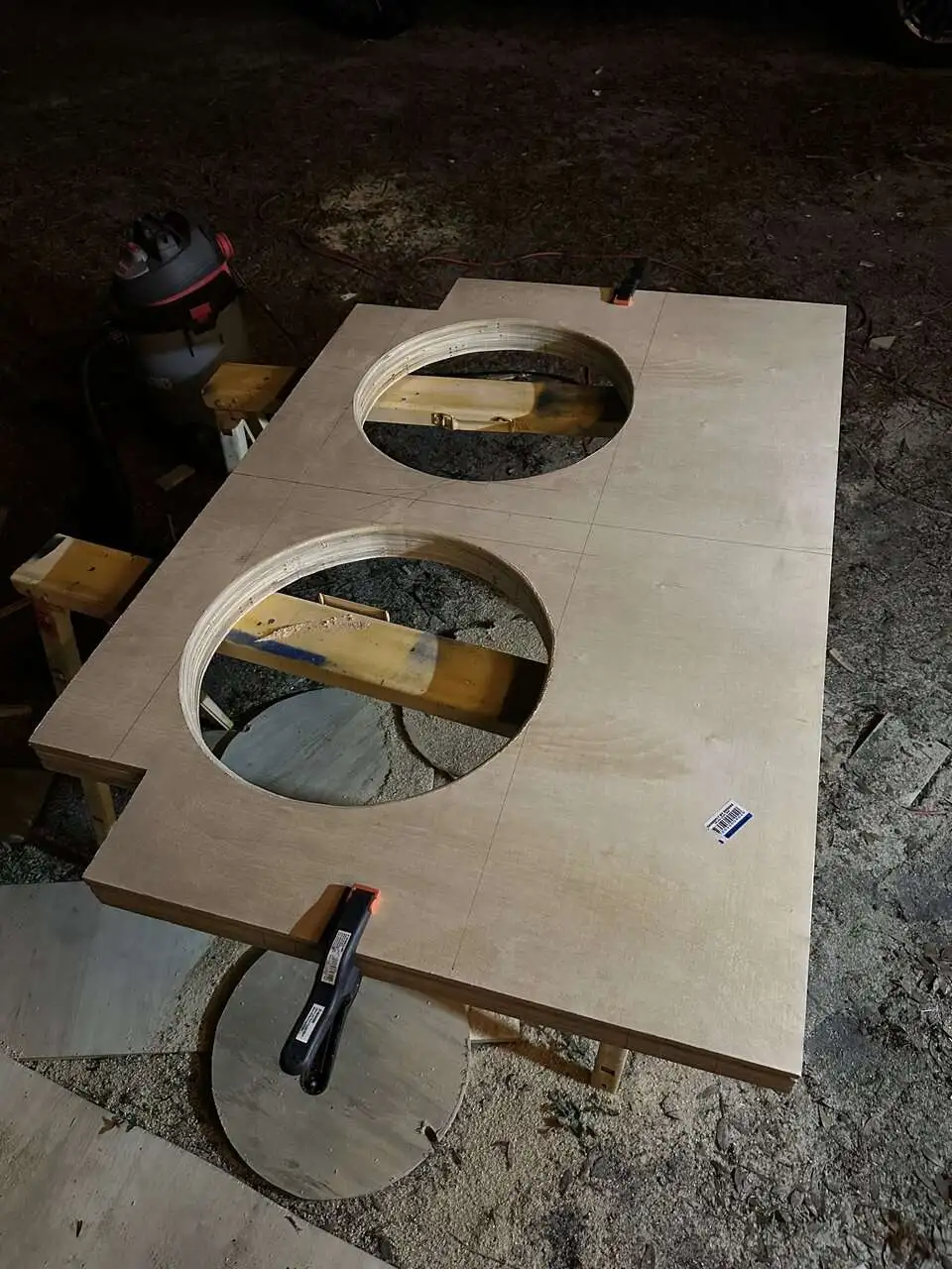

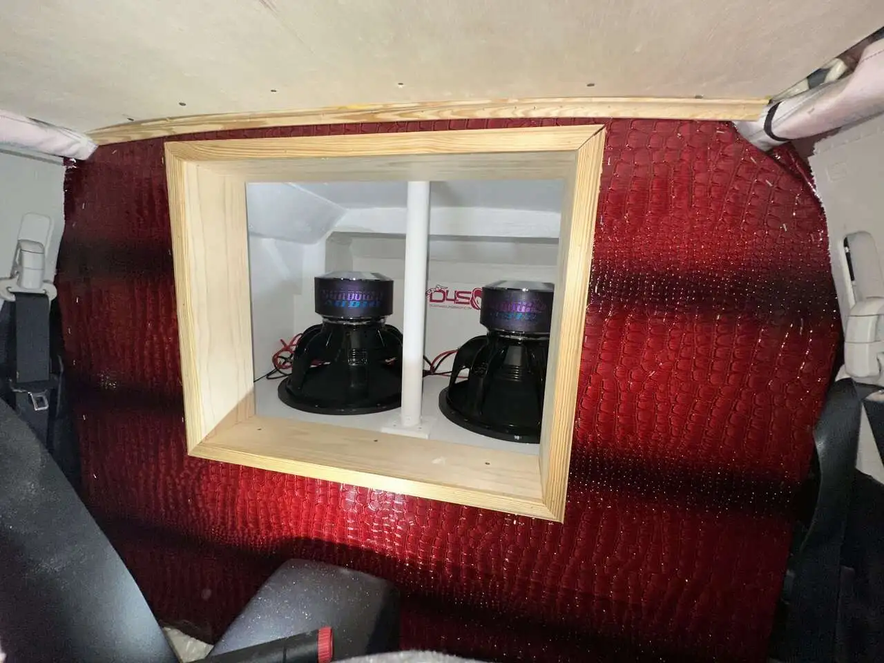

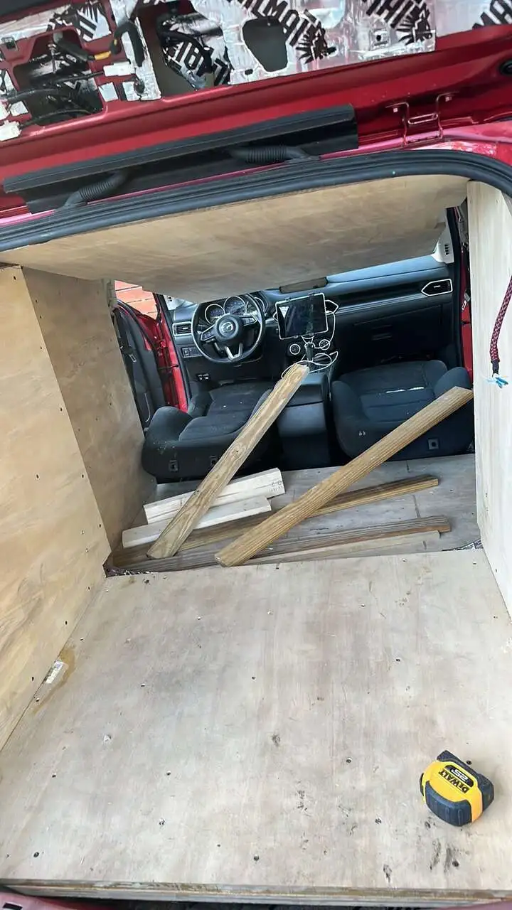

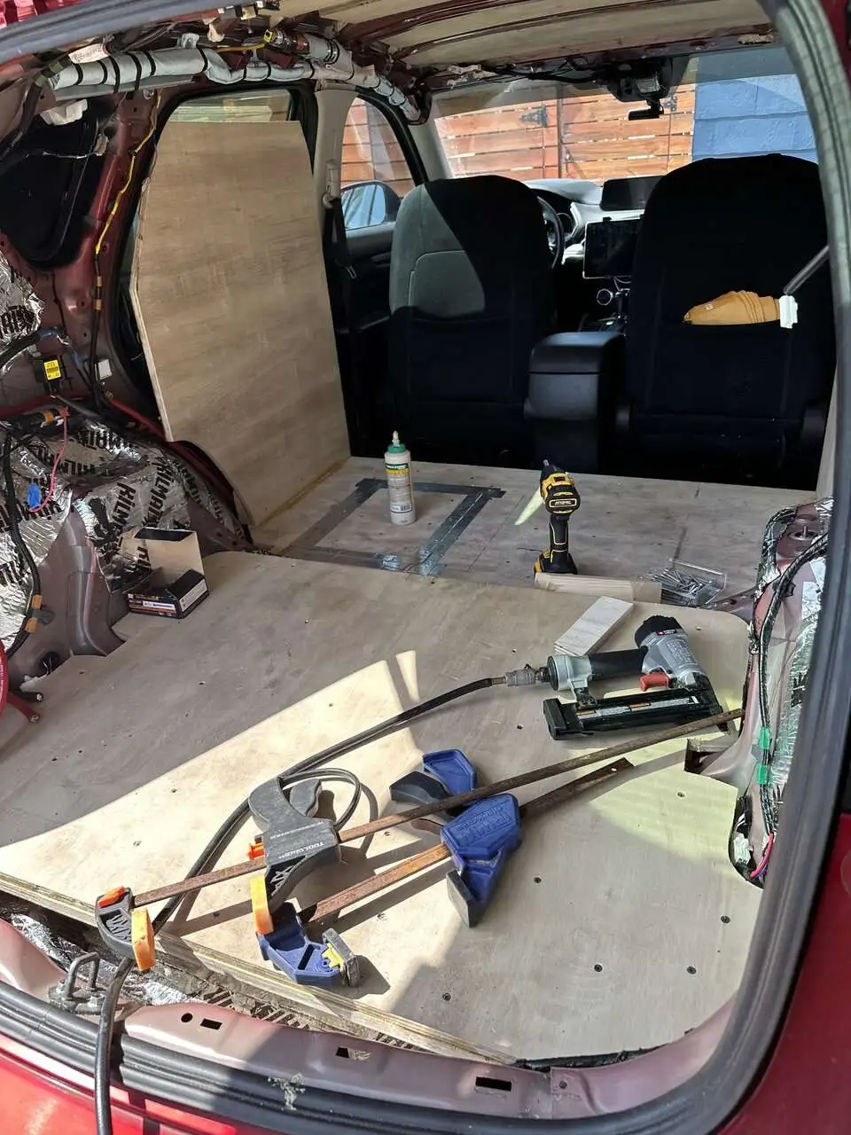

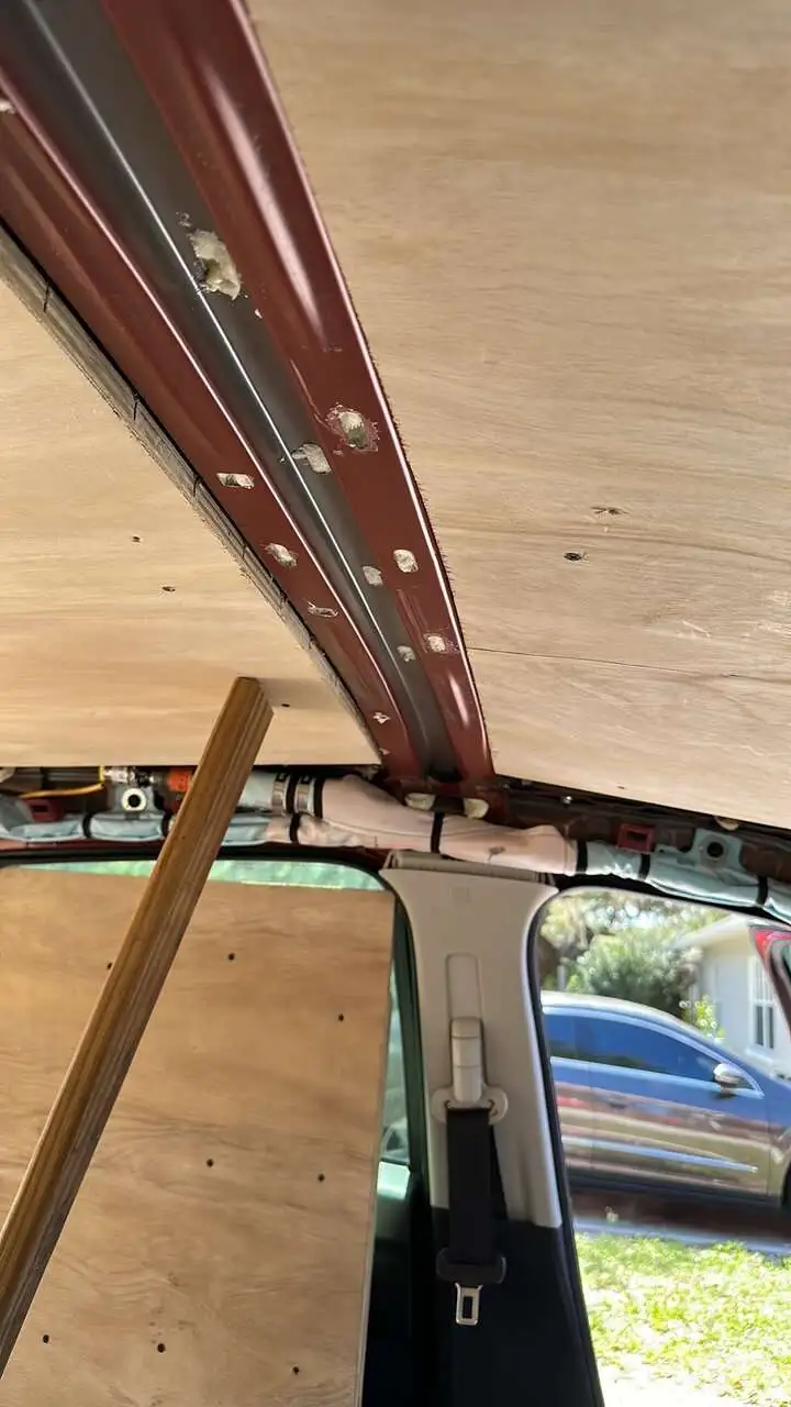

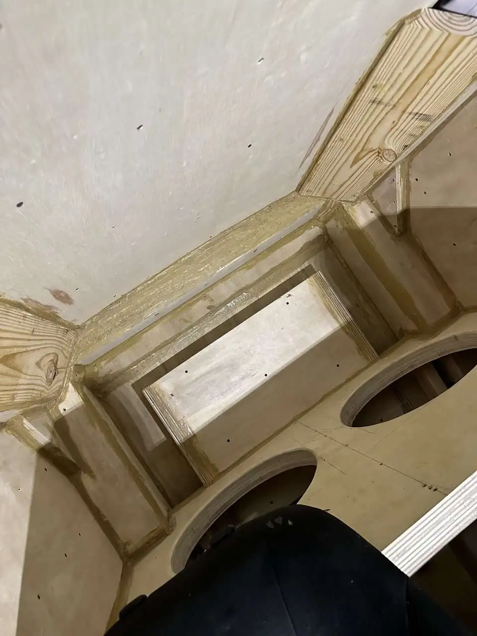

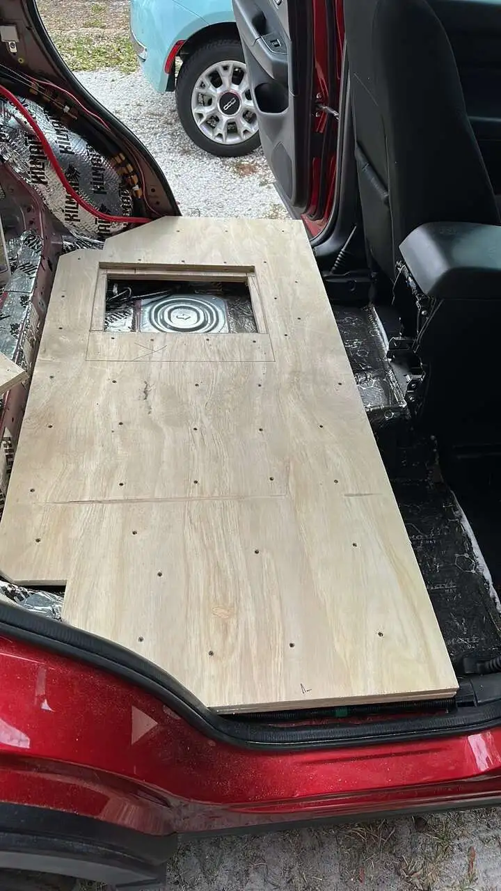

My 2018 CX-5 audio wall build

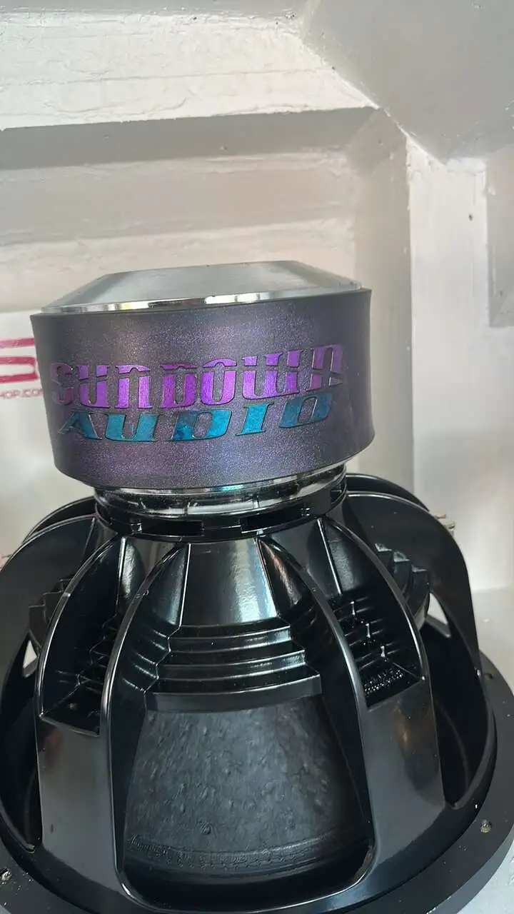

I know this isn’t everyone’s cup of tea, but a few of you followed me in early stages of adding bass so I figured I’d share some photos of my build. I still have more work to do (proper door panels, and adding the other 20 tweeters and 6 more mids, probably moving up to a JP83 and a jp10.4 to replace the jp13.2ab as I feel like I’d benefit from a bit more power, waiting on new alternator to come in still, ). Car is doing 155db+ from 23-29hz, and 157db+ in the mid to high 30s. Total rated wattage across everything is around 13k watts, but if you know these amps they can easily do double that.
2018 CX5 Sport
Dayton 408 DSP, stock stereo bypassed with iPad.

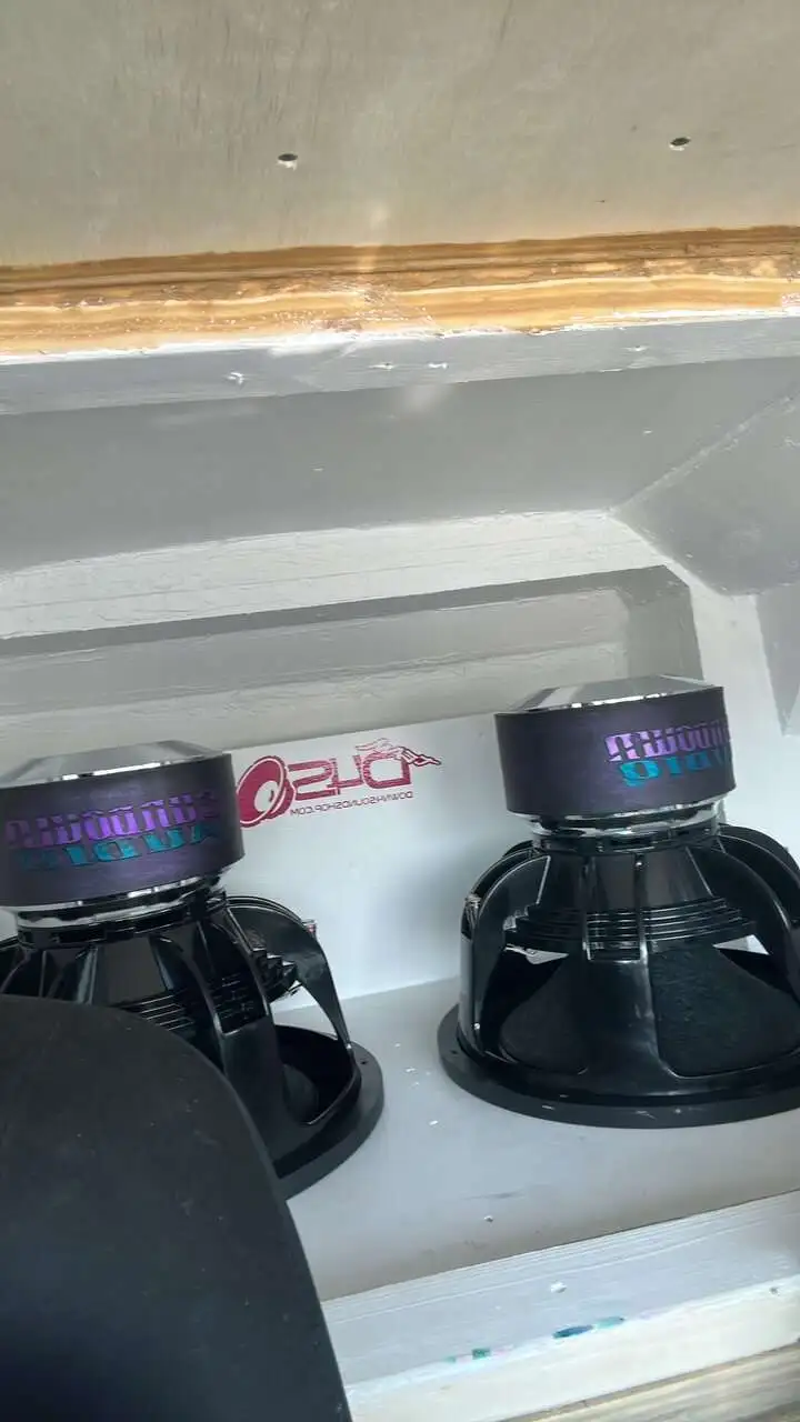

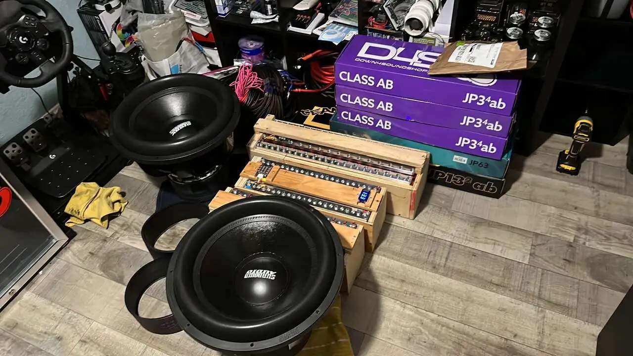

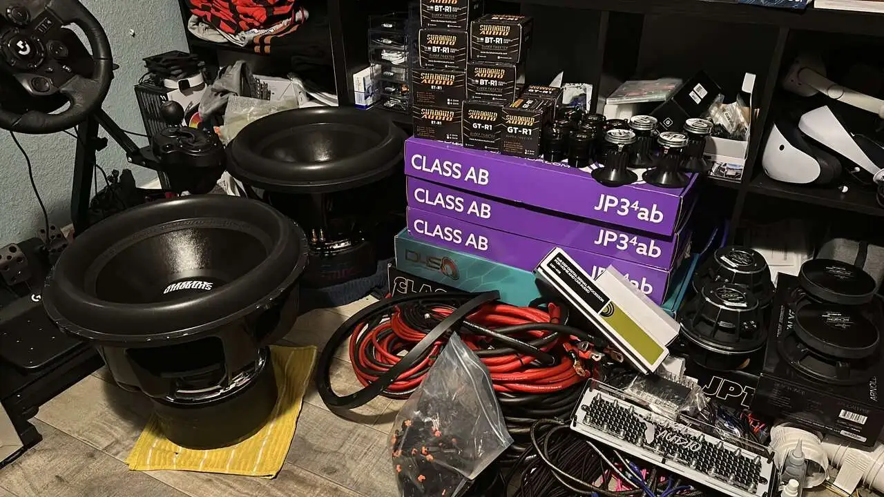

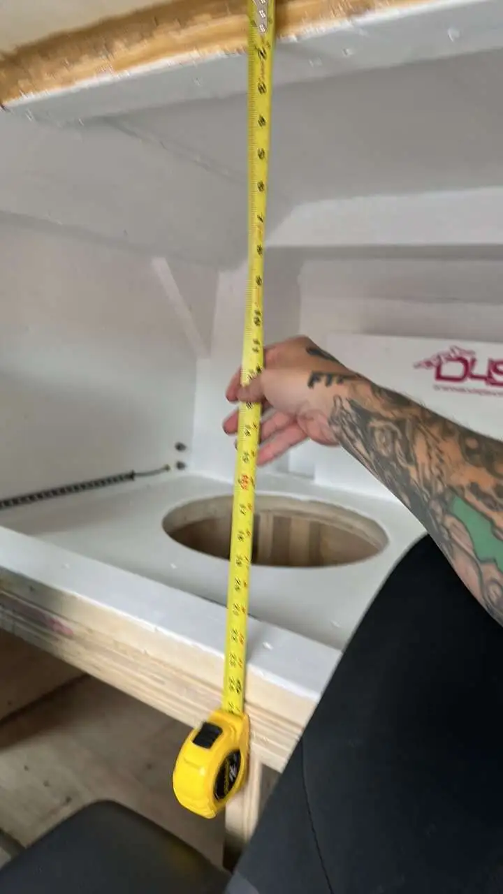

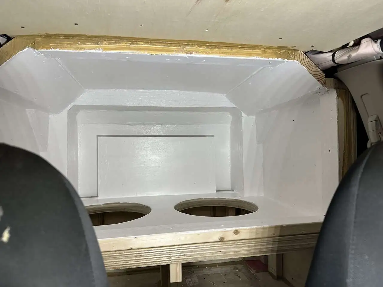

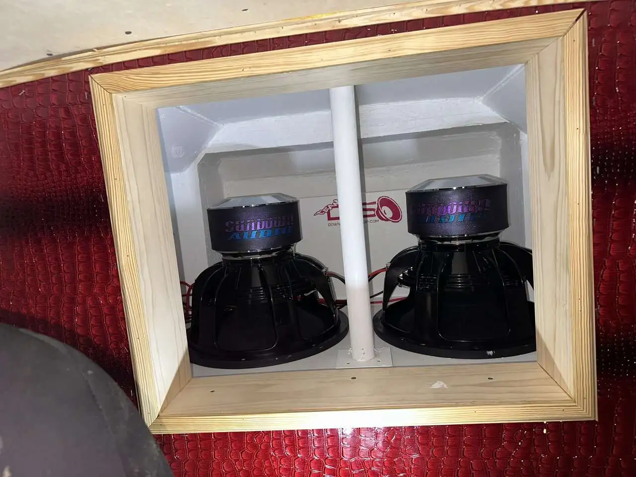

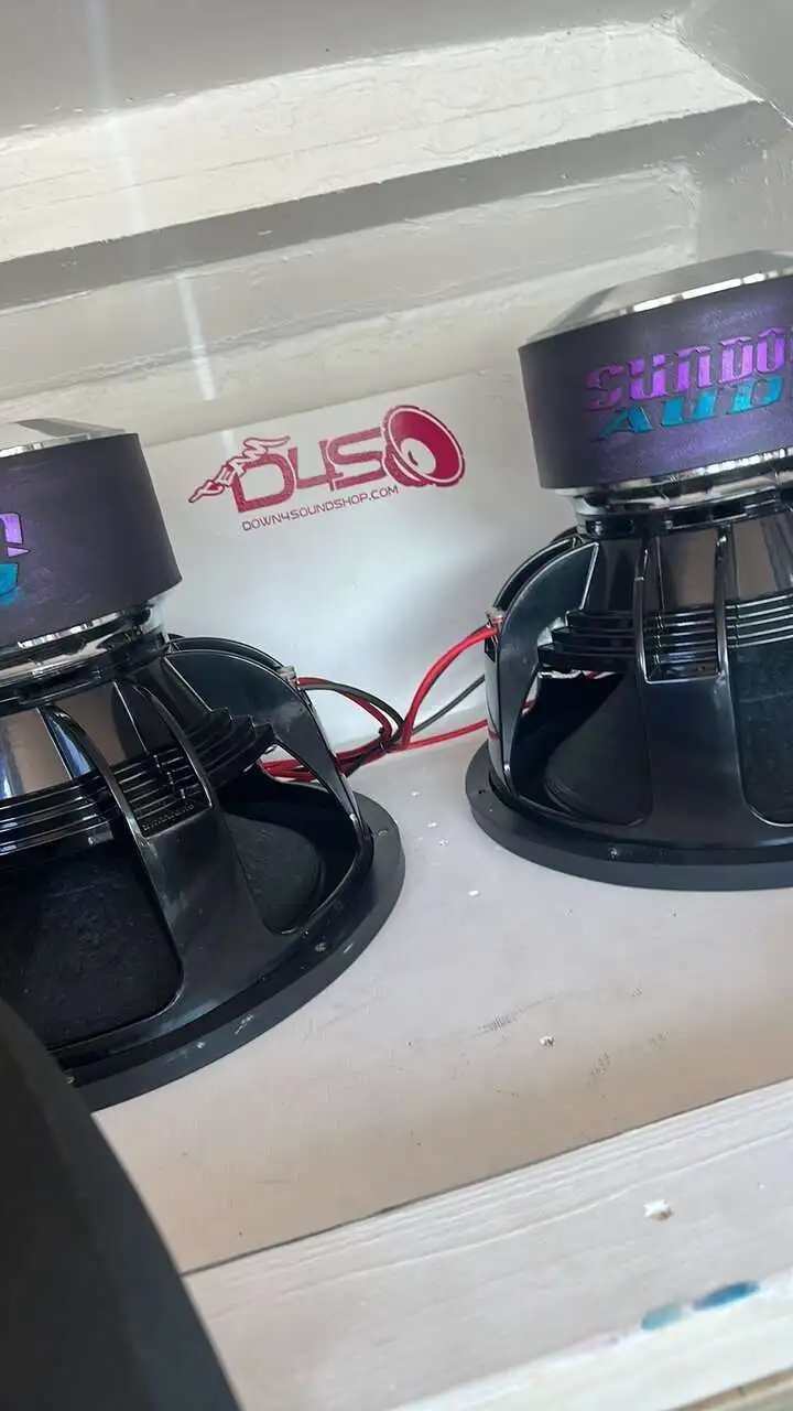

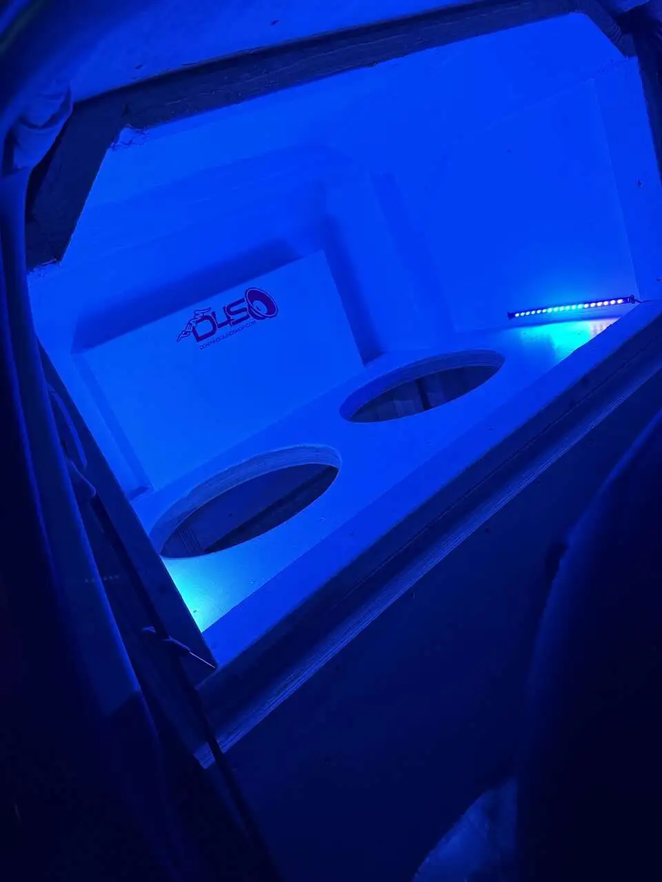

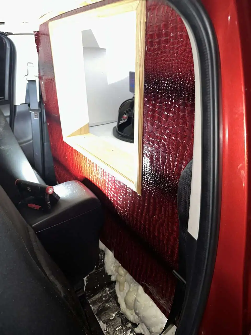

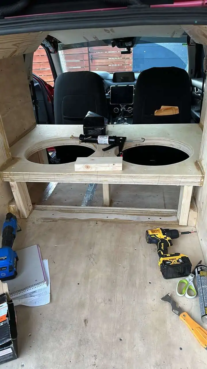

2 18” Sundown Zv6 in a B Pillar 6th order, tuned 25hz rear and 50hz front. Built to smash 20s and get windy.

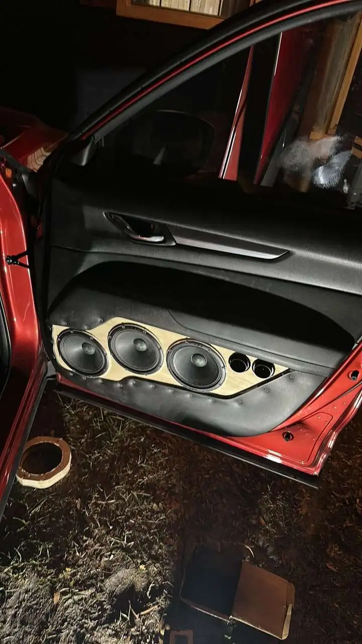

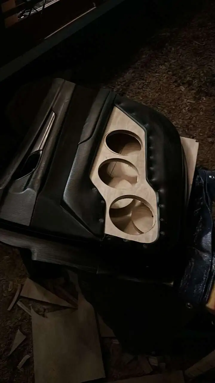

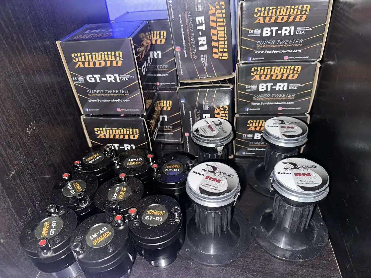

12 Deaf Bonce Arnold Neo 6.5s
18 Sundown GT-R1 tweeters
4 Sundown BT-R1 tweeters
2 Sundown ET-R1 tweeters
4 Rogue RN-1 horns

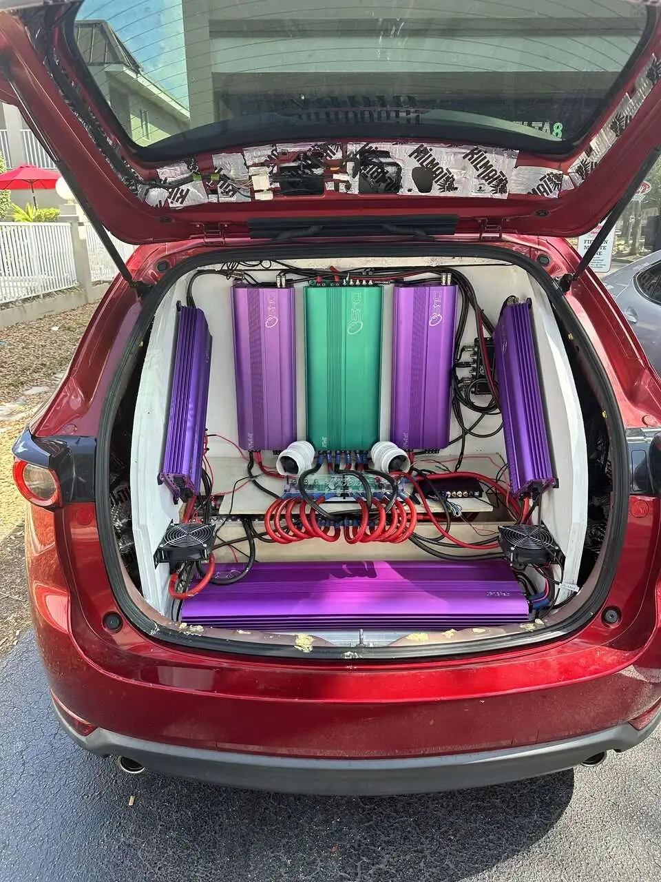

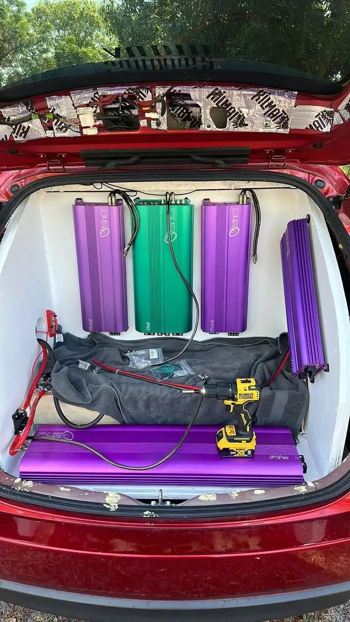

4 JP34ab amps for the highs
1 JP13.2ab for the mids
1 JP63 @ .5 ohm for the subs

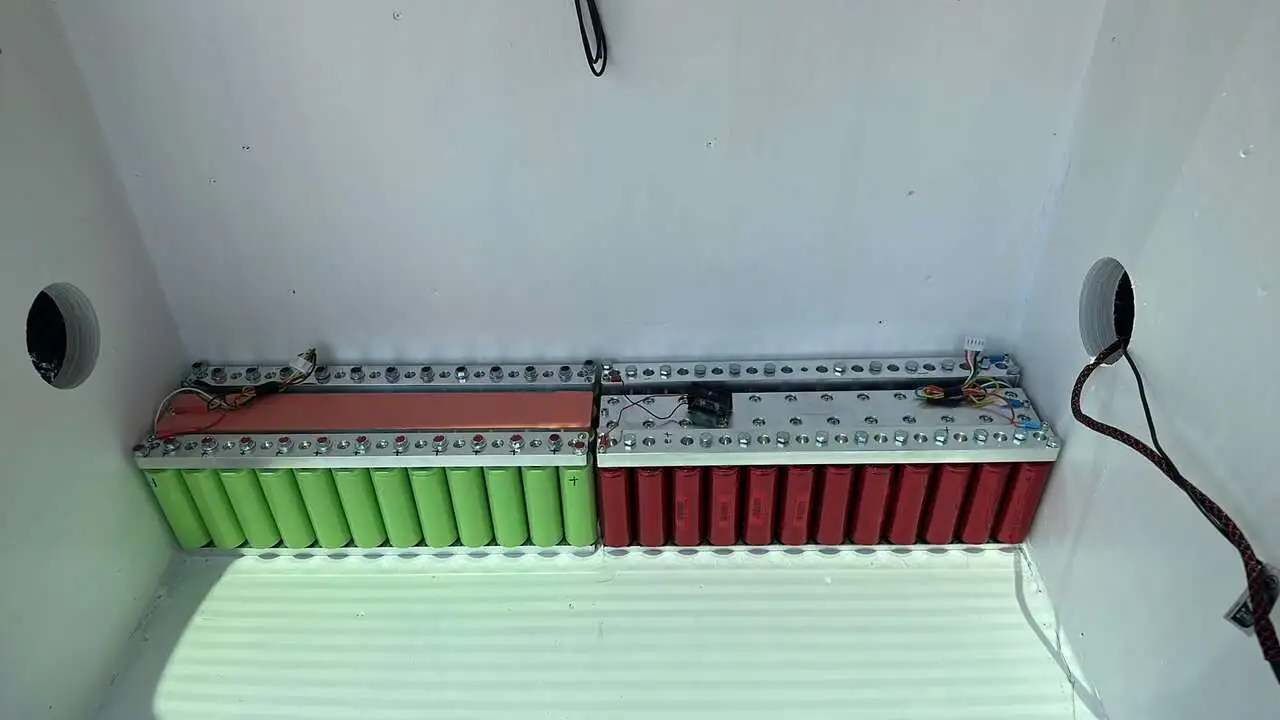

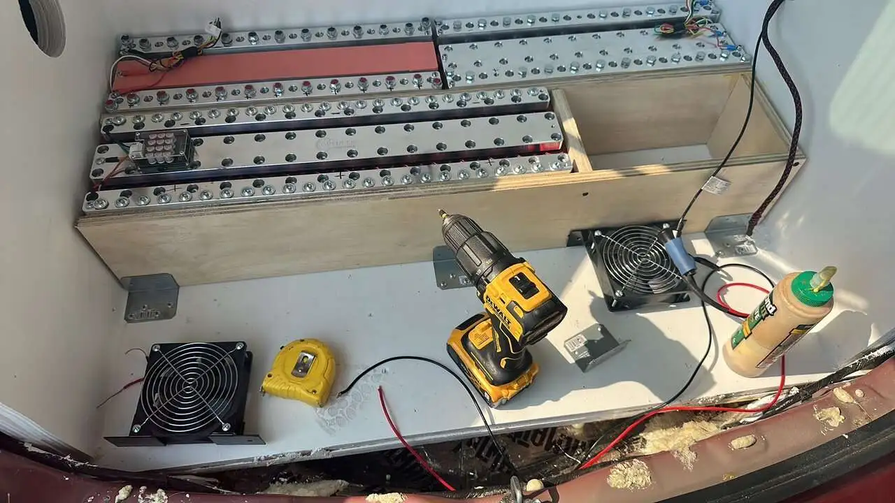

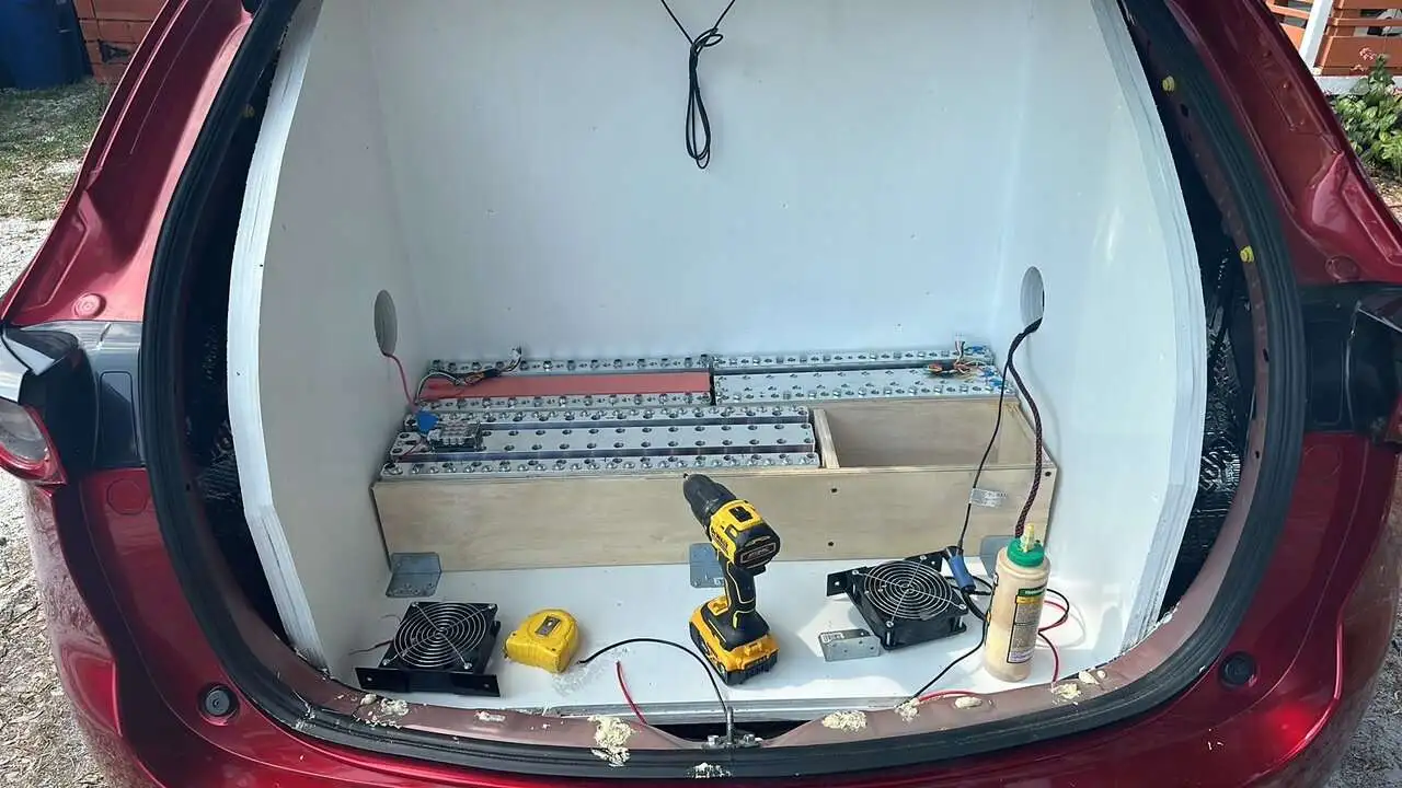

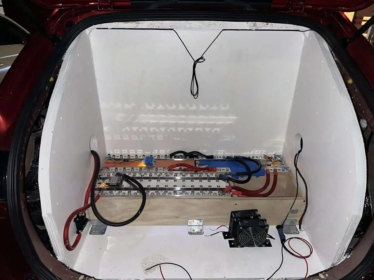

320ah of headway 38120 lithium cells (stock battery not being used)

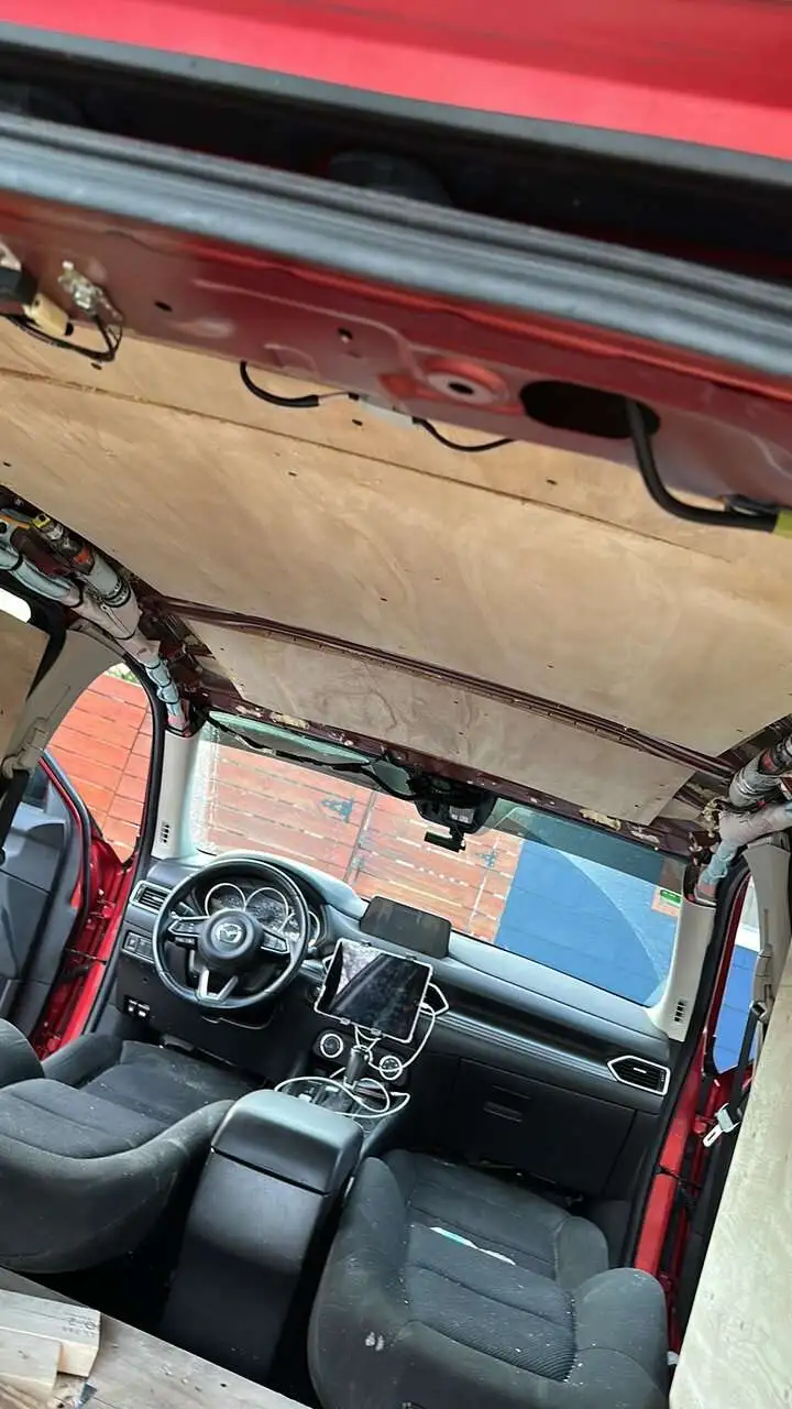

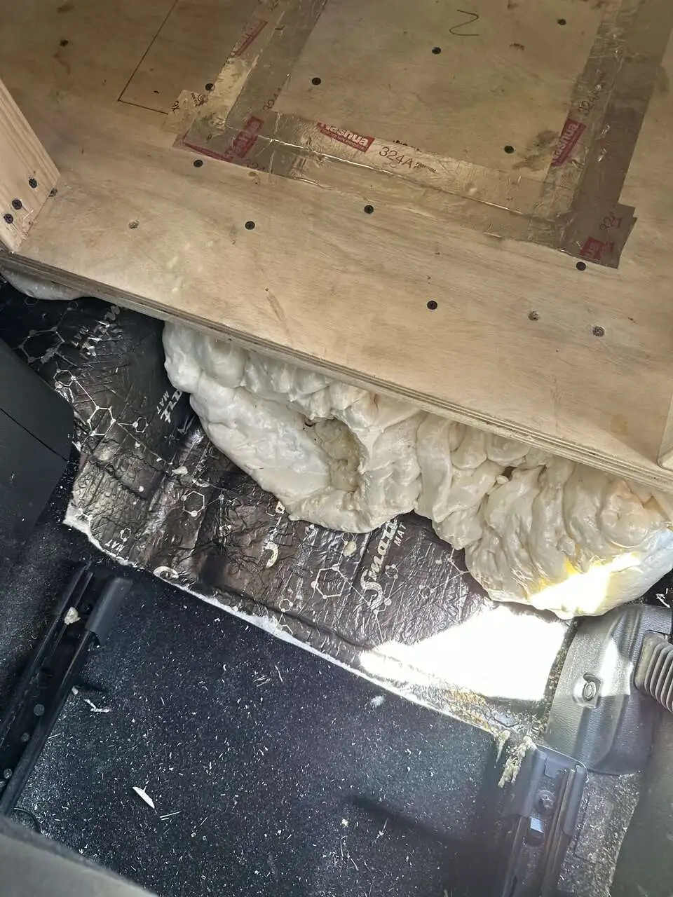

About 200lbs of sound deadener
Brand X 250a alternator en route

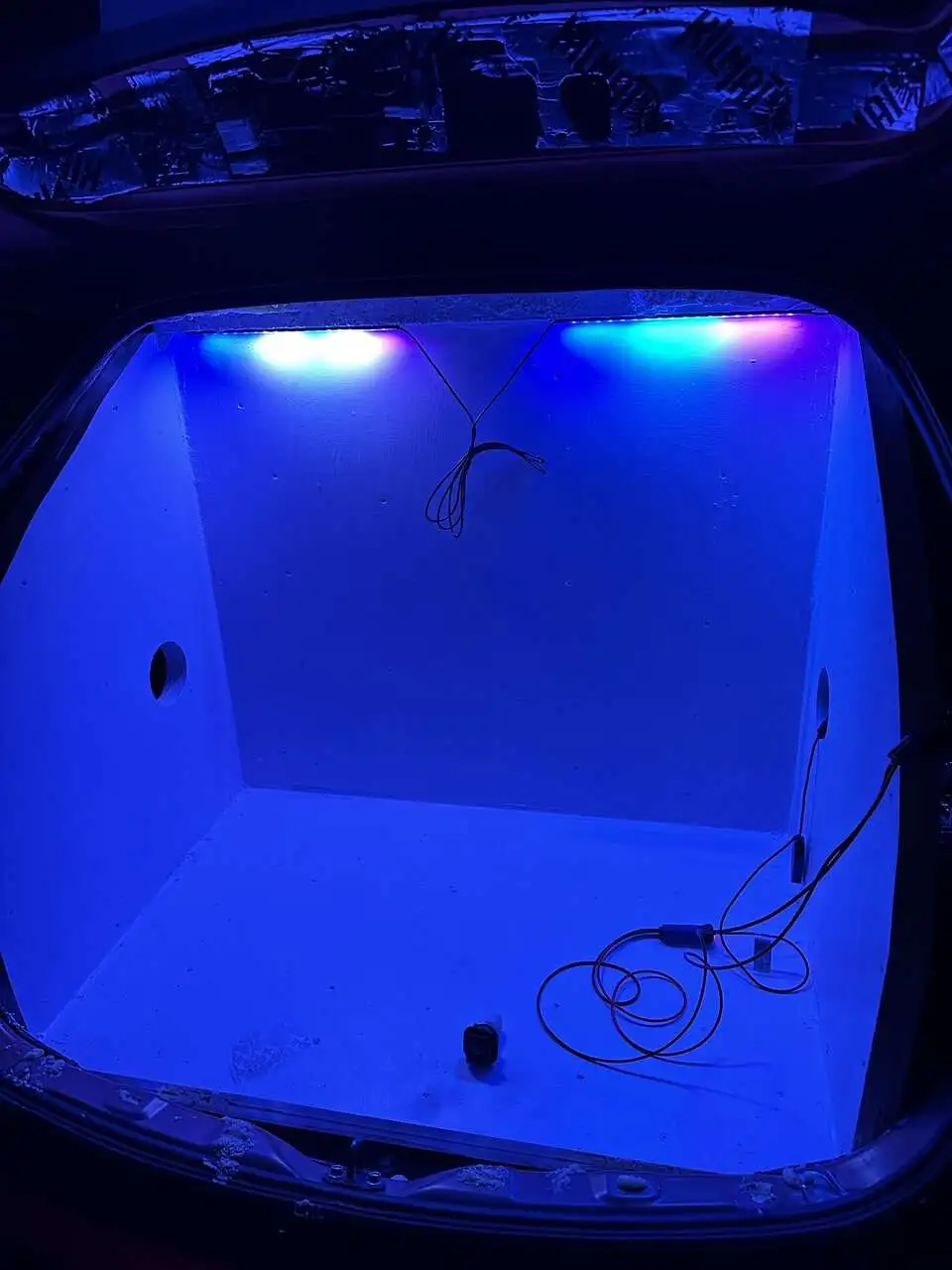

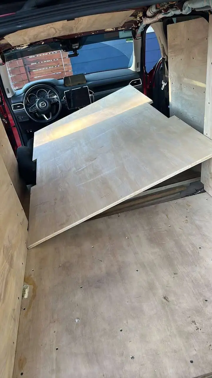

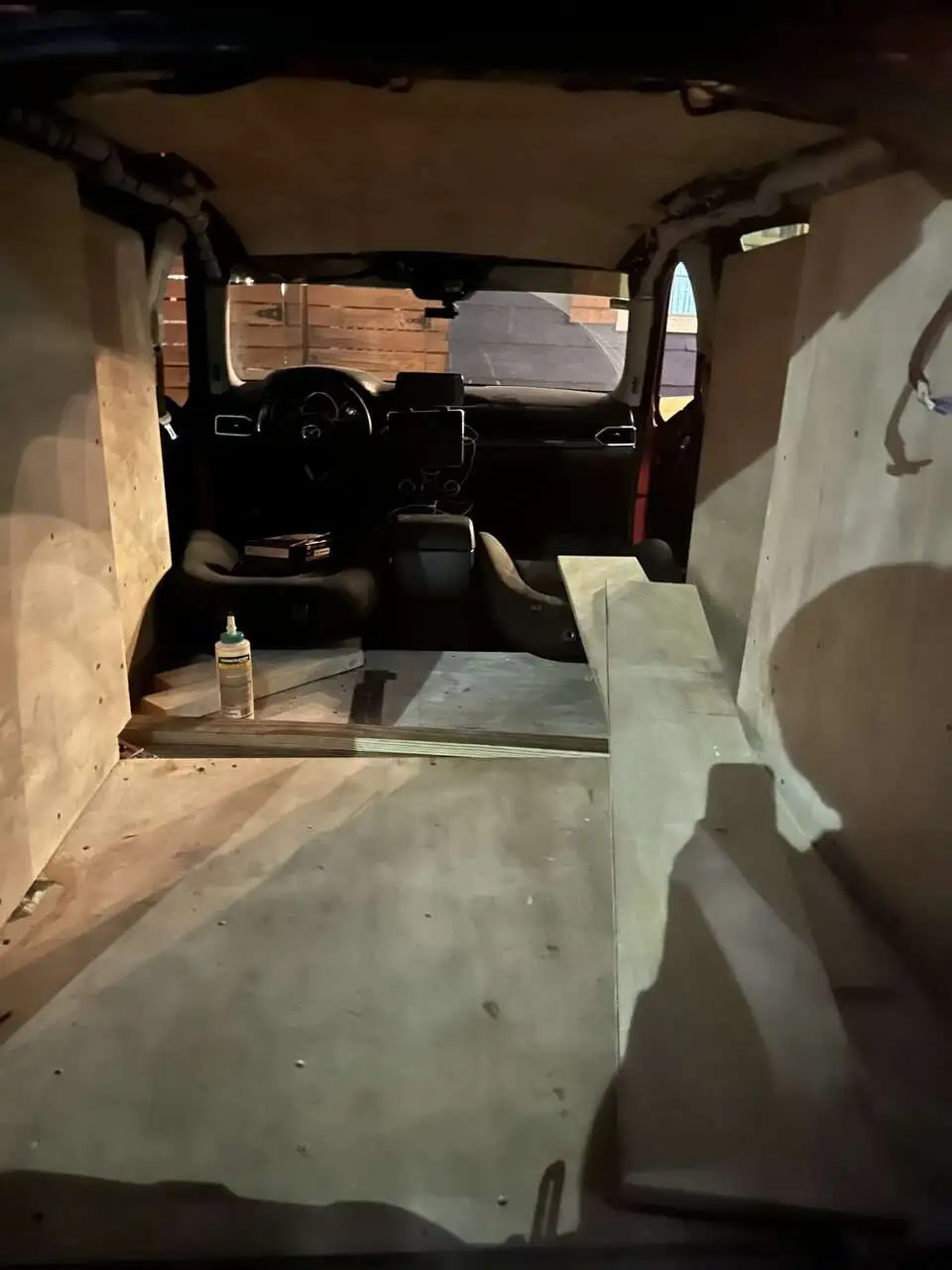

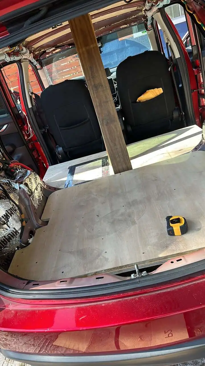

14 sheets of wood @ 70lb each is 980lb, figure 900lb after waste.
2 gallons of wood glue and 32 tubes of PL Max is probably about 60lb.
The subs weigh 226lb.
The amps are probably about 200lb.
Lithium is about 150lb.
All the wiring is about 400lb.
Deadening is 200lb.
Roughly 2100lb

You used 14 sheets of plywood? Is that double thickness 3/4" for the box? 14 sheets of 4'x8' plywood, really?
How come you went with plywood rather than MDF?
Again, that's crazy and impressive!
Did you, or are you planning on, beefing up the suspension for the additional weight?

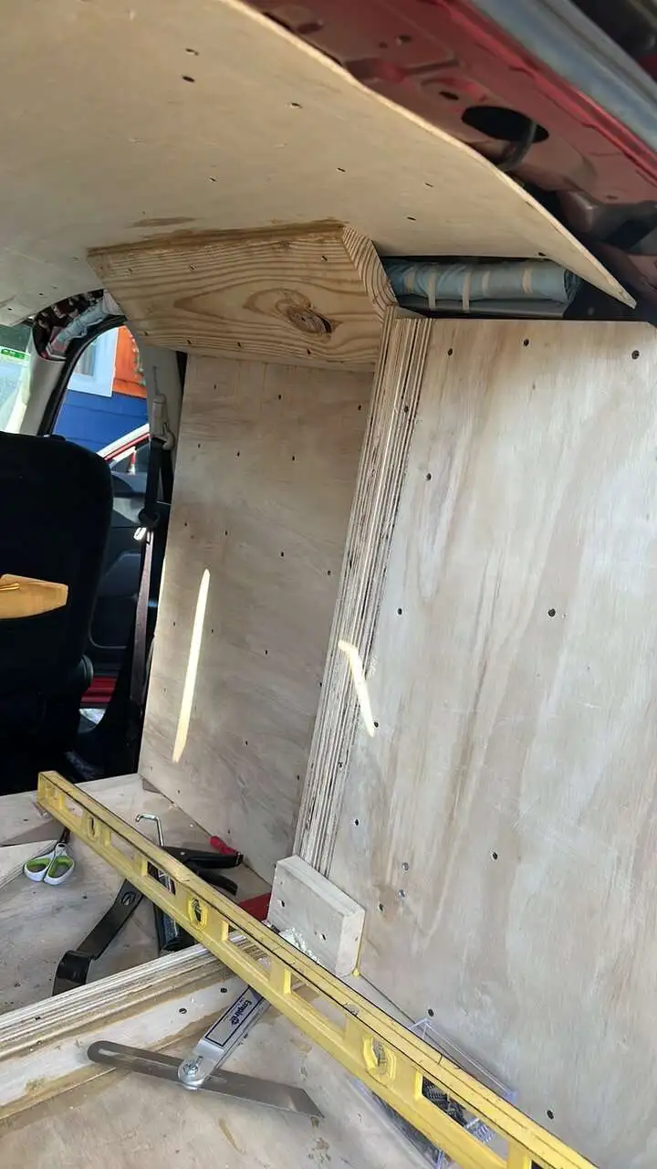

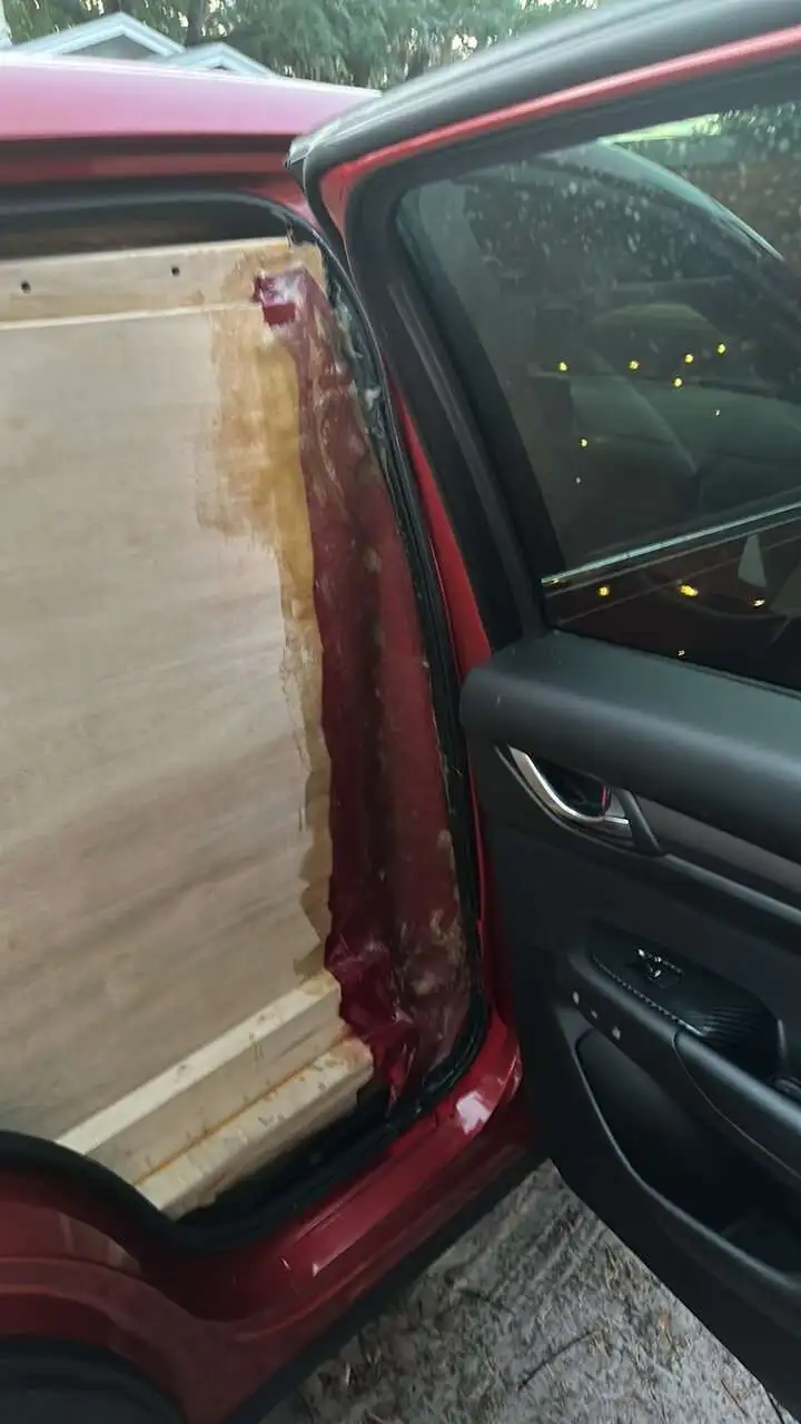

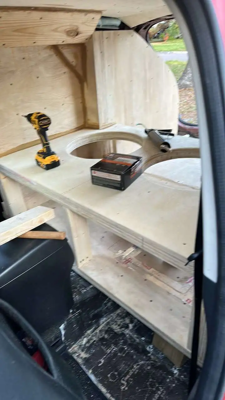

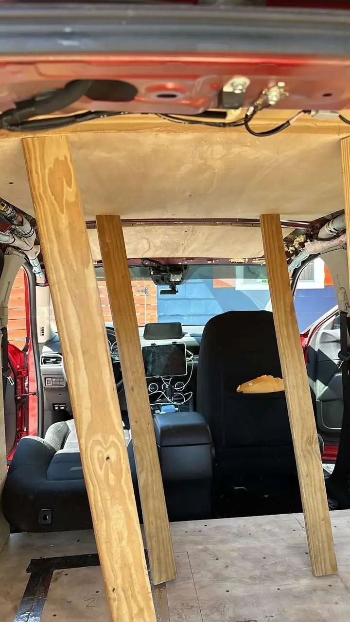

Basic birch veneer 7 layer ply. Yes everything is minimal double layered, with baffle being triple layered and roof being triple layered for the front half and 8 layers at the rear above the port. MDF would have been significantly heavier and wouldn’t hold up as well in Florida rain and humidity.
Suspension will be redone once it starts to fail. Figured no real reason to beef it up until it’s needed. But will likely go full airbags when the time comes. Thought about switching to the cork sport lowering springs just for the 40% stiffer spring…but undecided there. I haven’t had any issues with bottoming yet 🤞
