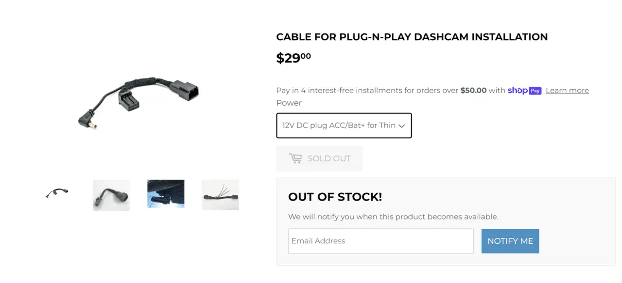

To power the dashcam, I initially thought to use the OBDII adapter, like in my Civic. But I'd rather leave the OBDII port alone in the CX-5, because I had to disable the dashcam when I had my Civic tested for emissions. The other option was to use fuse taps. It would free up the OBDII port, but I'd rather not create a headache for myself in case I accidently make a mistake and use the wrong fuses. That's where the HomeLink adapter comes in. Since I wanted to use a Thinkware camera, the Dongar adapter was out. Further Google searching brought up this Thinkware adapter from MX5Things. Do note that it only works with framed HomeLink mirrors, as the adapter utilizes the connector behind the mirror, not the radar cover.
This not only allows the use of the U3000, but helps maintain parking mode, too. Though there are limitations with this adapter. While MX5Things markets this for the MX-5 and the CX-5, it clearly works better in the MX-5. It just fits in my application. If I purchased a dashcam powered by USB, it wouldn't be an issue. However, the power input for the Thinkware camera is too short. As a result, I had to mount the dashcam on the radar cover. At first, I thought it would be fine, making the dashcam less noticeable. But to my shock, the radar cover is not flat, which resulted in a tilted dashcam.
				Cable for Plug-n-Play dashcam installation
Note: this item is compatible only with USA/Canada Mazda 2016-2023 cars equipped with Home Link (with ten pin connector):  Cable for powering the dashcam from the rearview mirror (using a 10-pin connector). It can be used with any 12V or USB-powered dash camera. DC plug OD 3.5mm / ID 1.8mm or...
					mx5things.com
