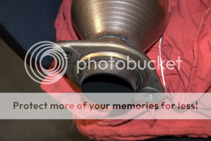

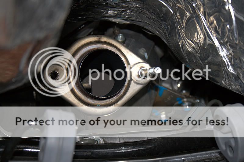

Front flange
There is no possible way that the supplied bolts would fit. The bolts used the wrong threads, and were way too short. The front flange has about 3/4" pipe extending through it, and the flange itself is not flat.

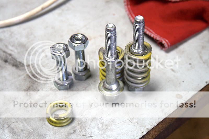

We ended up using the existing bolts, but they had to be modified. Originally, we tried to open up the holes on the racepipe's flanges, but that thing is SOLID. We ground the inner lip on the bolt and had to cut 1/3 off of the spring. We used the existing donut, but didn't use a gasket.

The front flange looks like this
Another look what the front flange looks like
A pic with the modded bolt installed
Cut the springs

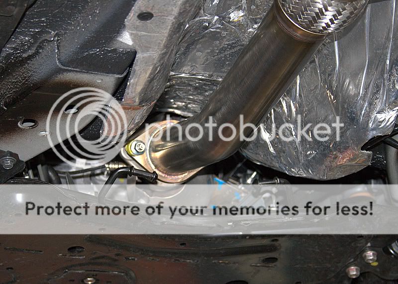

Finished
