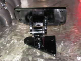

mods this is for the community and i am not trying to steal usersWell we have been hearing about this for over a year and since no one is going to take the time to build one..... we did.
The solution was to get rid of both the lower aluminum mount and the upper rubber/aluminum part. We have seen a few of the lower brackets break and fail at the bracket not the bolt. So a simple replacement will not work for those looking for a real replacement.
The ones pictured here are way over build with 3/8 inch plate steel. The production units will be made out to .250 material and all the hardware will be grade 8 or higher.
There is some additional vibes with this set up, but nothing more then you would expect with a performance mount. These will be the fix for the failing stock mounts and will end up being a necessity for those going big turbo or SST/modded stocker.

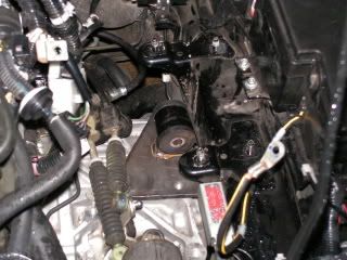

1. top plate in car (prototype)
2. lower plate in car (prototype)

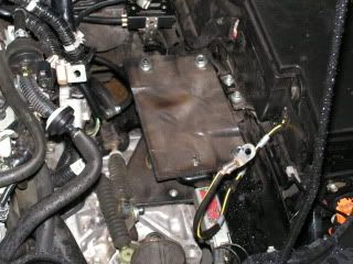

3. finished unit painted

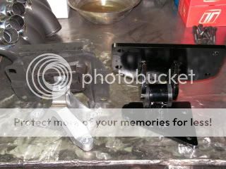

4. finished unit next to the stocker
