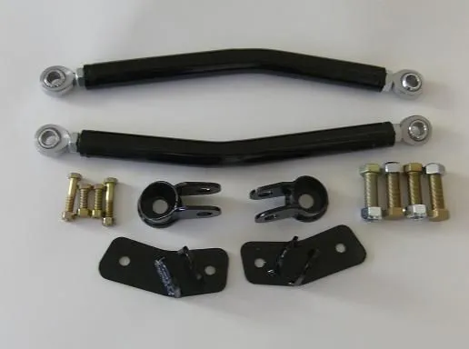

Just got a reveiw from the test car!!!!
These are awesome!!! Basically all the wheel hope was GONE!!!
For those who are wondering about the bend, it's a 9 degree bend for those who are running a larger dia wheel and more leavage

how much????? and is this going to just stop wheel hop (cause there are so many mounts out already for that) or actually do what it says and give traction? All i get now is wheel spin. I need TRACTION

Traction bars historically don't increase traction. They allow you to create controlled wheelspin, as when one wheel breaks loose more readily than the other and you need them to be the same. On rear wheel drives, they also called them "slapper bars", because they were adjusted so that on the side that didn't spin easily the bar would literally slap the leaf spring, shocking the suspension and making that tire break loose. That way both tires spun in a controlled manner. Of course, I'm only familiar with traction bars for RWD. It could be a completely different concept for FWD.

You got the concept, and your right, these wil help the tires catch some grip and stop spining

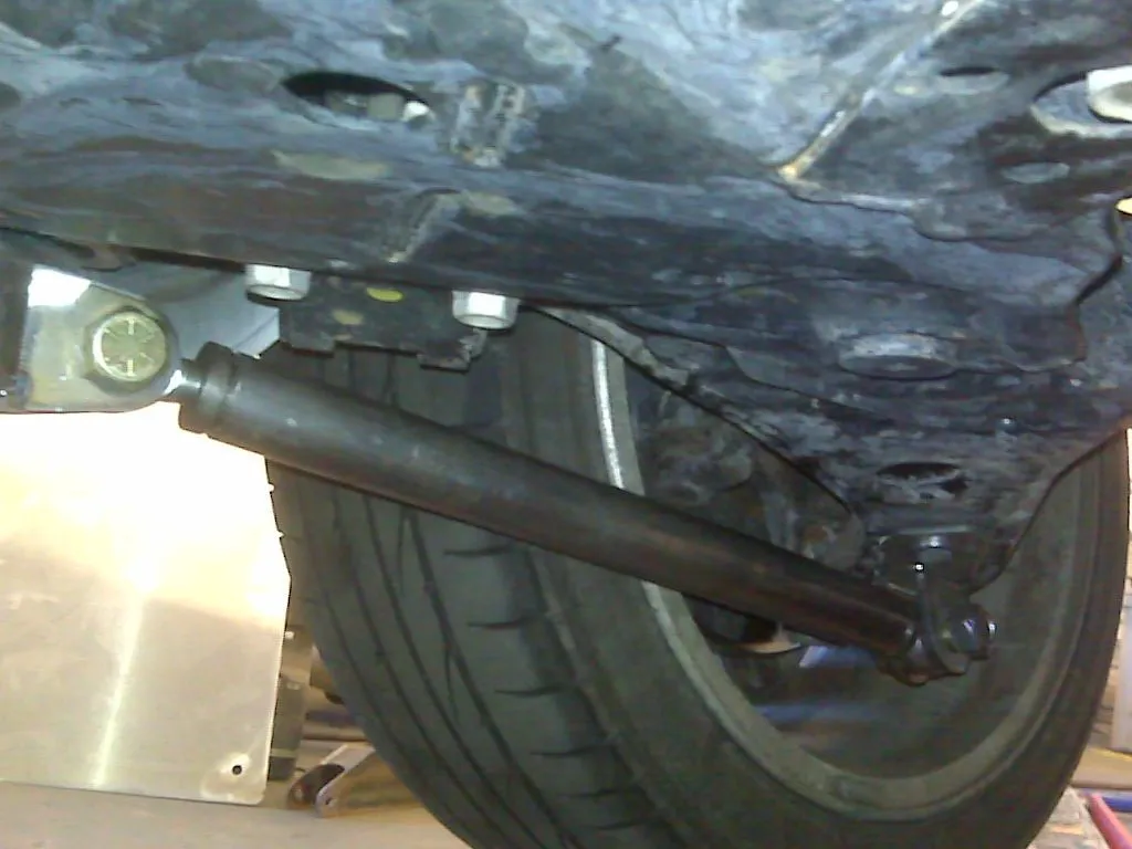

I'd really like to see a photo from directly underneath to get a better idea of where the mounts get installed.

Its supposed to prevent axial twist. So if you launch hard and its trying to put all the power to turning the wheel, its to prevent any other parts from turning with it.
