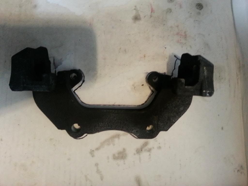

quick post for TonyC. The carriers are identical from gen 1 to 2. in fact, damn near all of the front and rear suspension bits and subframe was identical between my MS3 and Mz5.
Gen 2 carrier compared to Gen 1 trace:
