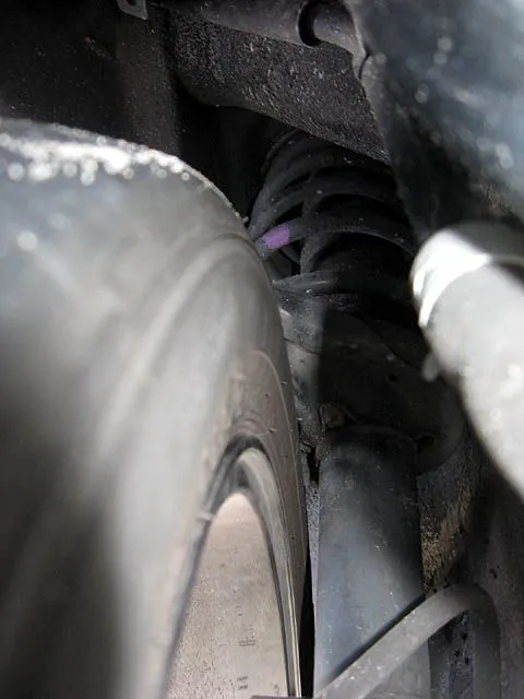

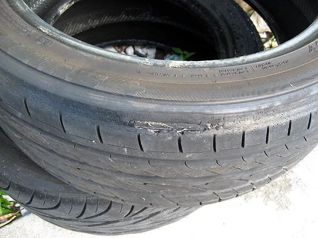

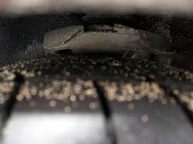

just saying, with a +55 offset on the 17's on my p5, and a tire size of 225/45 both my rear tires were hitting my struts, both at the base and the stem.
looking at them now, even with 5/16 spacers (basically 8mm, making them about +48 offset) gives me less clearance than Im actually comfortable with.
check the images for reference.
(and yes, those are pretty much brand new tires too, wish I had caught it when I first got the car as the rims/tires came with it) :(

you aren't listening... with 215/35-18's they will fit fine. thats a much smaller tire size than your 225/45-17's. MANY people have run 215/35-18's on protege's with ZERO issues. your tires are over an inch taller, and a half-inch wider. you never said the width of your wheels, but even if they were the same width, yours are too big for a protege.
I am listening, it seems you are not, it is the offset Im talking about. my tires clear (barely) with a +48 offset, but they would NOT clear with a +52 offset, so he will need spacers, that was ALL I said, that he would need spacers, maybe I was wrong in my size recommendation for the spacers, but that doesnt change the fact that spacers ARE going to be needed to clear the strut's.
and yes, my tires are an inch bigger than the 35's, but the 18" rims are an inch bigger than my 17" rims, so there isnt going to be a huge difference in the overall diameter.
