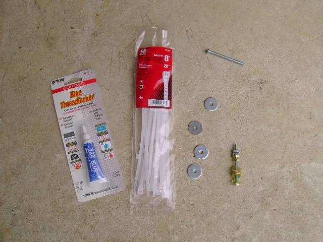

Tool List
14mm socket
17mm socket
Rachet
Extension (s)
14mm Wrench
Locktite
Socket Swivel
Pry-thing (flat head screw driver)
Elbow Grease

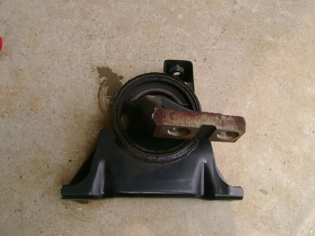

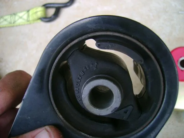

Passenger side mount.

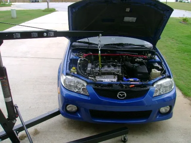

1. Jack, or lift the engine to take stress off of bolts you will be removing
2. Remove Hardware securing mount to frame using 17mm socket
3. Remove Hardware securing mount to engine using 17mm socket
4. Without ripping a A/C hose, remove mount from engine.
5. It should look like this---->

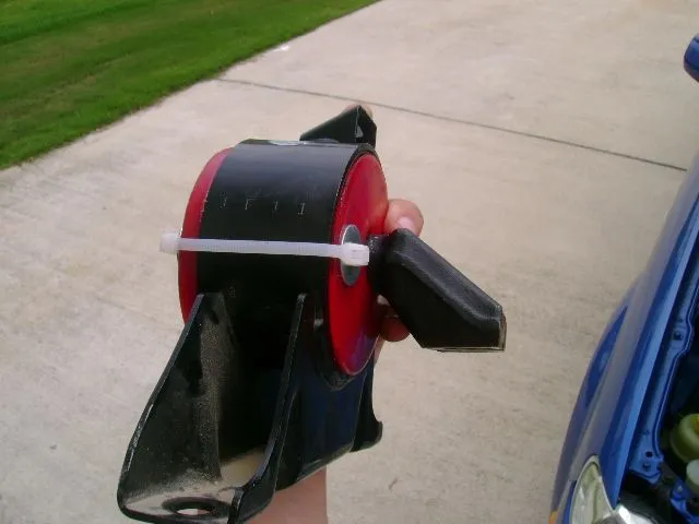

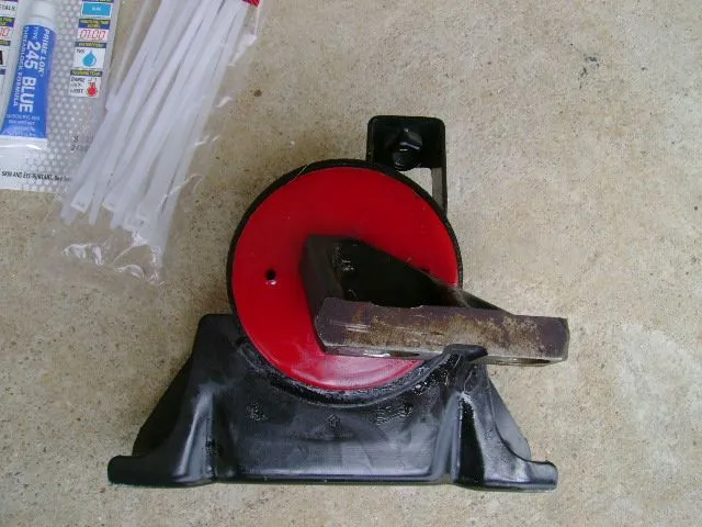

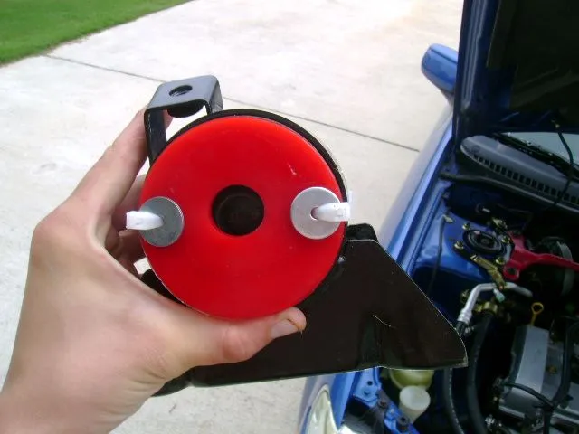

After you have pulled the mount off, you need to put in the red bushings
The one that "slides" over the flange, PITA!
I used dish soap and lube-d it up to make it go on easier
It will go on, it will take some swaering and pulling but it will get there.
Then, use zip ties ( in my case) to secure bushing togather. I bought some hardware that would have worked but it was a 1/4 to short. so. slide the zip ties through the holes. I used washers to even out the pull on them as to not tear the bushing. PULL TIGHT!!!! ARRRRRGHHHH!

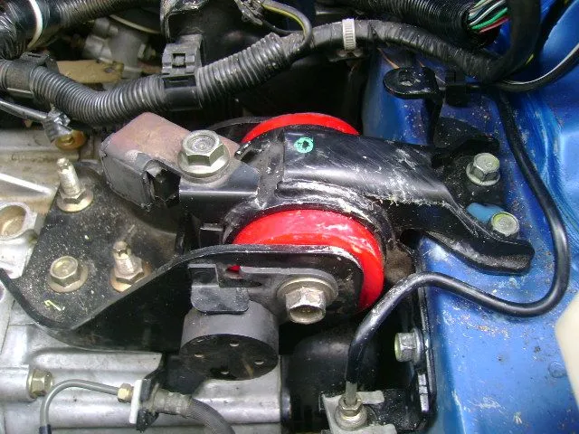

Now slide the mount back into its original position.
Locktight the bolts the hold the mount on.
Using all of your might, secure the Hardware back onto the bolts.
Do the same for the mount-to-frame side

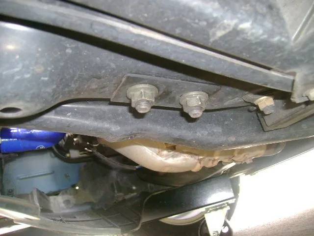

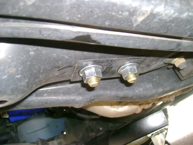

Still using A lift or jack, keep pressure off the bolts/nuts.
Get underneath your buggy and take these two bolts off FIRST!

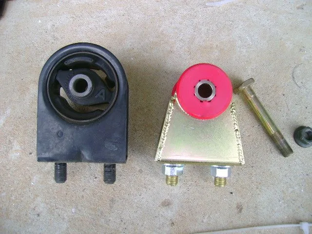

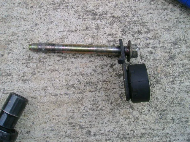

Remove long bolt that holds mount on.
This on sucks, i had to use a big metal tube to break it loose.
Remove tore up old pile of crap mount And install shiny new one!

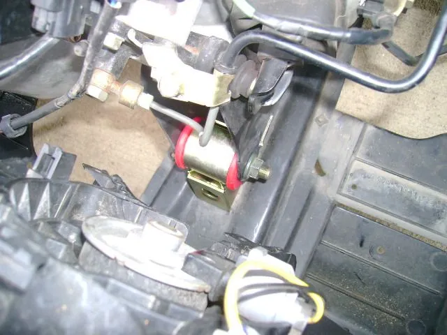

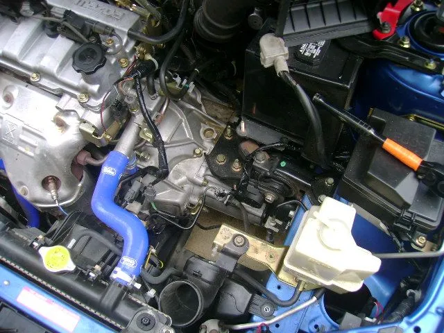

Now, Drivers side mount......
This one just pisses me right f off......
You have to remove these first, in this order.
1. Strut brace
2. Intake Box thing and filter
3. Battery
4. Then battery tray (duh)
5. Battery Tray.
It should look like this BEFORE you begin
Gimme a half hour and i will finish this as there is a slight rain delay......
BEER RUN!!!(cheers)

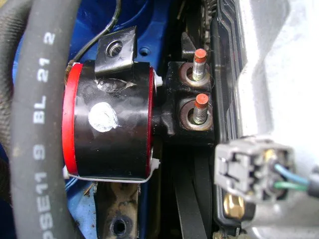

Ok, now that the rain has cleared

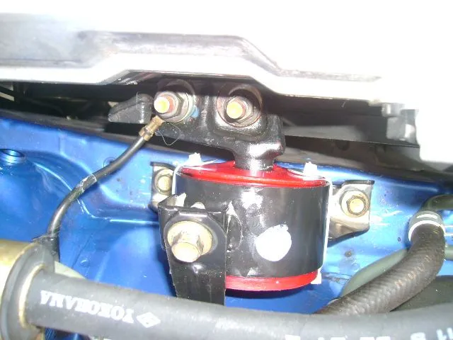

YOU HAVE TO HAVE THE FRONT BOLT ------OUT------ TO INSTALL THE DRIVERS SIDE MOUNT THINGS!!!!!
If you dont have it out, you will never get the drivers side bolt through....
Heres what it looks like after you install the bolt and have them in
By the way, all of the little nuts that need to come off are 10mm

I suggest getting a breaker bar, and a lift if you can.
A jack will make this process a lot harder.
