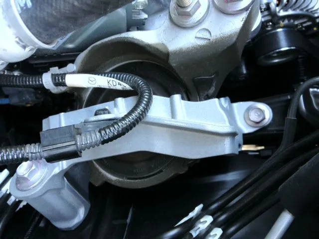

Does anyone's front passenger motor mount look like this? I remember reading that some of the early CX-5's had to have this mount replaced and it looks like mine failed/leaked, unless that discoloration on the metal is normal.

Mine looks the same. I guess it's normal unless mine is bad too. I think it's some adhesive overspray from the manufacturing process.

Exactly that the black coloration is the adhesive used to bond the Rubber to the aluminum bracket.
