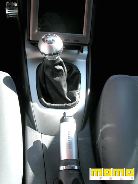

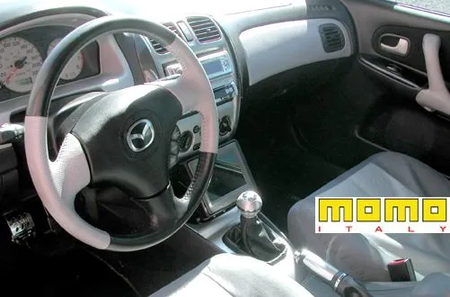

Here somes new pics of some momo accesories I just added.
I think it adds a real nice touch.

hey nice! i wanted to get that ebrake :( hehe. i bet those things (boots, handle, shifter) cost a pretty penny. nice work - chris
i want that ebrake but i dont know what adator to use at the top to make it fit. do you have a part number for it?

G_MAN75 how hard was it to stall the momo ebrake. I have been thinking about doing this mode.
Well it was tough at first, but now that i know that it won't just slip on over the original one(after trying everthing, lube, soap)
The rubber must come off. Then what i did was wrap some rubber hosing over the bare metal ebrake, so it wouldn't flop around, tighted the the allan key screws it came with and then i used the factory black boot that came with the shifter on the car and slipped it on.( couse without one it look retarded). The chrome button of the factory ebrake is a screw on one to adjust the amount it sticks out. Worked out perfect. That boot you see on the shifter is actualy a momo leather boot.
Good luck.. I hope that helps
