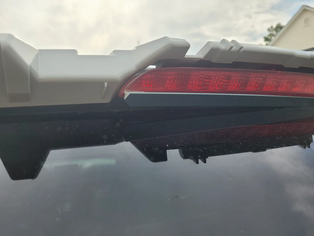

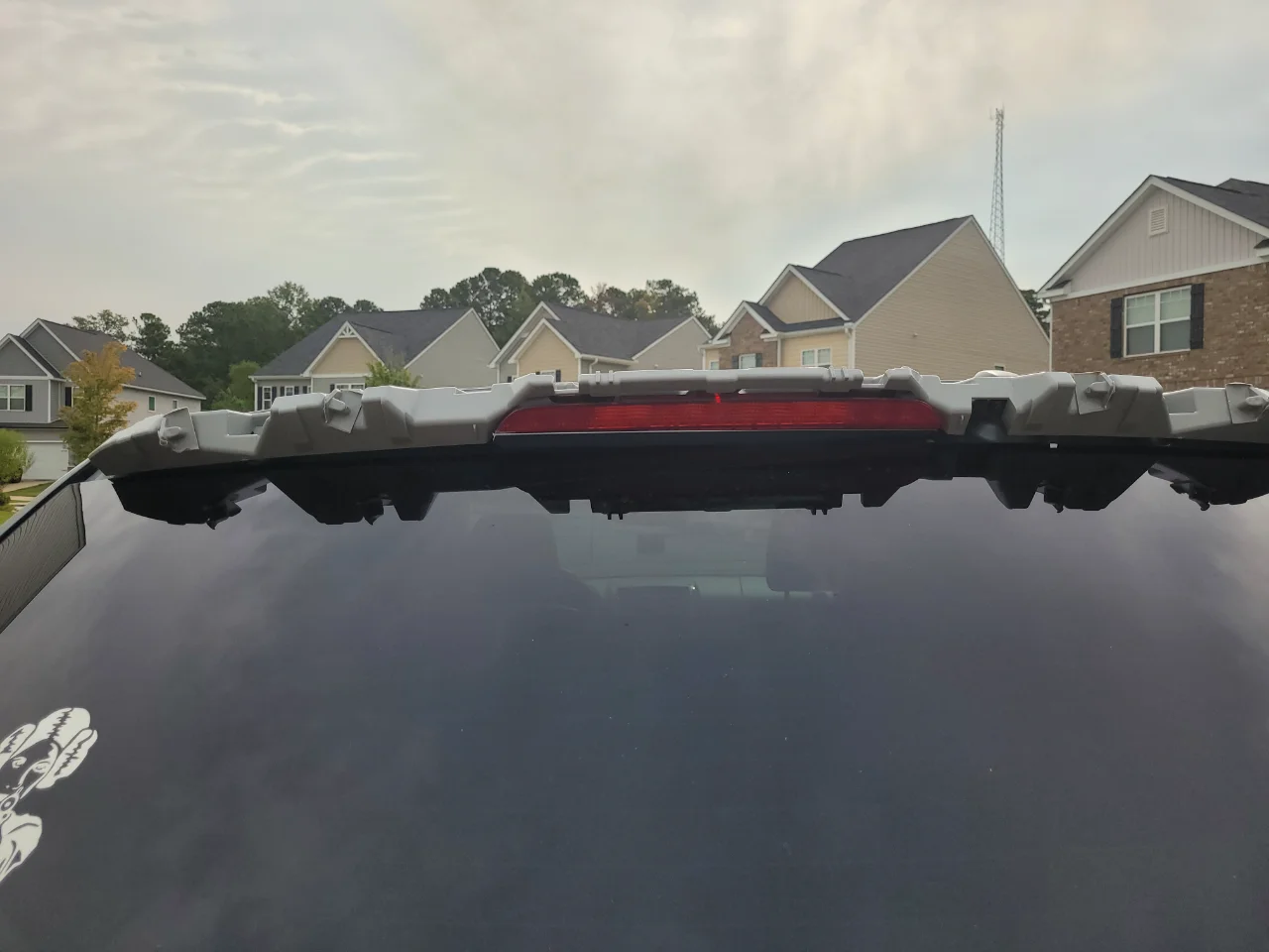

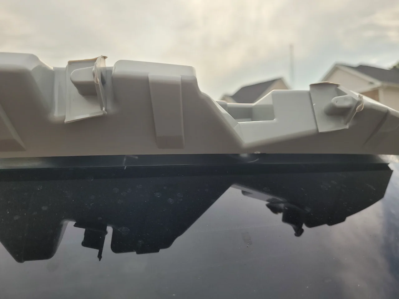

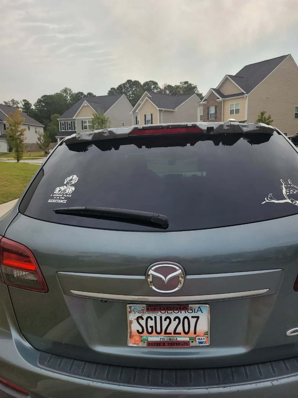

I have a 2013 cx9 grand touring. I believe at car wash the upper rear spoiler piece snapped off and I just noticed. Can anyone help me with what I need to replace.
Vin is JM3TB2DA8D0419376.
I don't know what piece I need. Any help would be appreciated. I attached photos of what's left of it. Thanks!

Looks like the spoiler is sold as one piece only. Part number TD11-51-960K-70, assuming your CX-9 is the Dolphin Gray colour. I don't know if a car wash could rip it off like that, you probably would have heard it happen. It may also be possible that someone just stole it off your car. Doesn't really matter either way though.
A brand new spoiler is almost $900 online. I would consider checking a few junkyards to see if they have any spoilers you can pull off yourself to save some money. Or maybe Ebay.

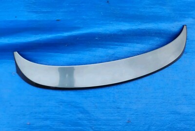

Thank you so much found one cheap does this look right to you? I really appreciate this.
Assuming that eBay part is the right color for you, and it appears to be, that saves you the additional expense of painting a new part. It seems to be a decent deal and it looks like all the clips are there as well so hopefully it's a simple install. Also good that your brake light remained on the vehicle so that the harness to connect the new one should still be fine.
Yep that one looks like the right part. Hopefully it's a fairly straightforward installation. Looks like you'll have to remove what's left of the spoiler on your car in order to install the new one as one piece. Also keep in mind that there appears to be a small scuff on the left side of the brake light, might want to just confirm that with the seller. Hope it all works out!
I know someone with a first gen CX-9 who had the spoiler fly off while driving. It was probably a 2008 (pre face lift) and this was like 2.5 years ago. So it seems to be an issue with these cars.
