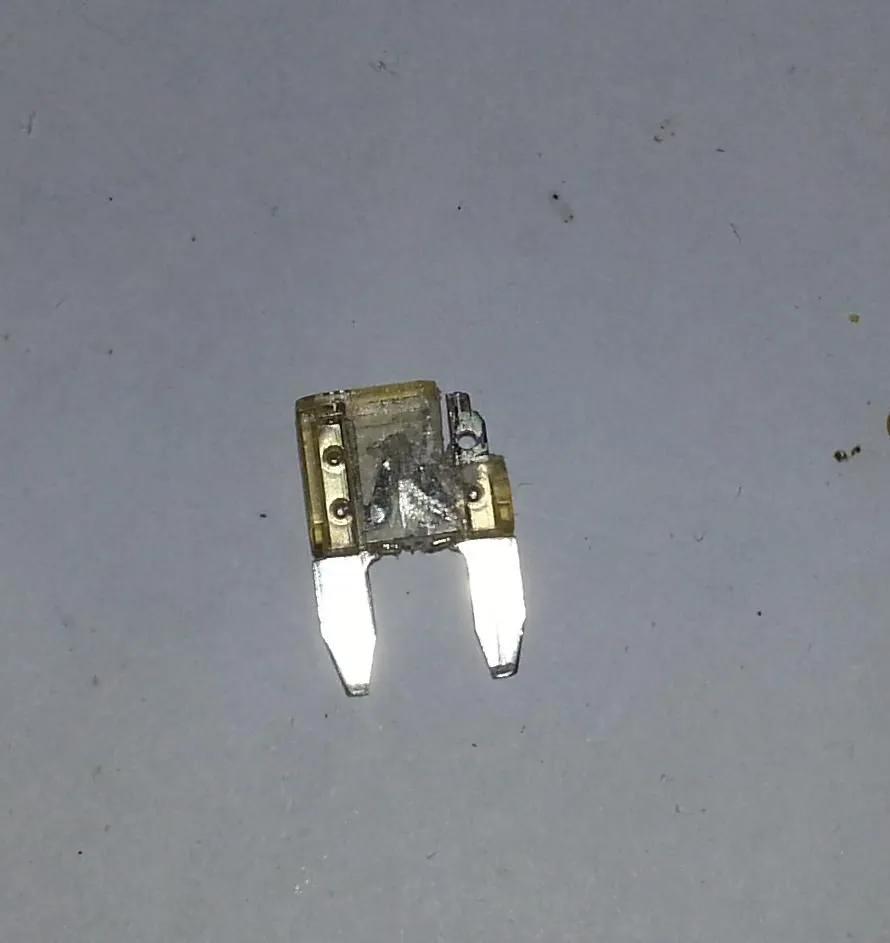

Start with the old/spare mini-ATM fuse (amp rating doesn't matter). If the fuse is not already blown, drill a hole through the fusable link in the middle to make sure the two legs are disconnected (THIS IS IMPORTANT!). I drilled up vertically from the bottom, but through the side is fine too. Verify the legs are disconnected from each other. Then use a Dremel or a sharp knife to grind/cut the plastic off the top both sides of one of the legs, so you can solder the wire to it. You should have something looking like this:
attachment.php

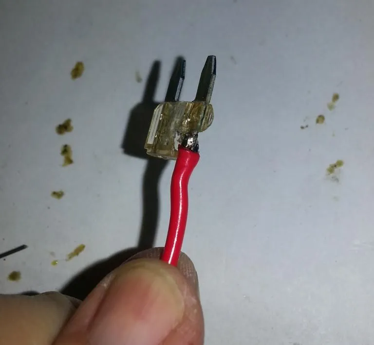

Take your piece of wire (make sure it's heavy enough gauge to carry the 12V socket current, ~14-16 AWG) and solder the end to the bared top of the fuse leg:
attachment.php

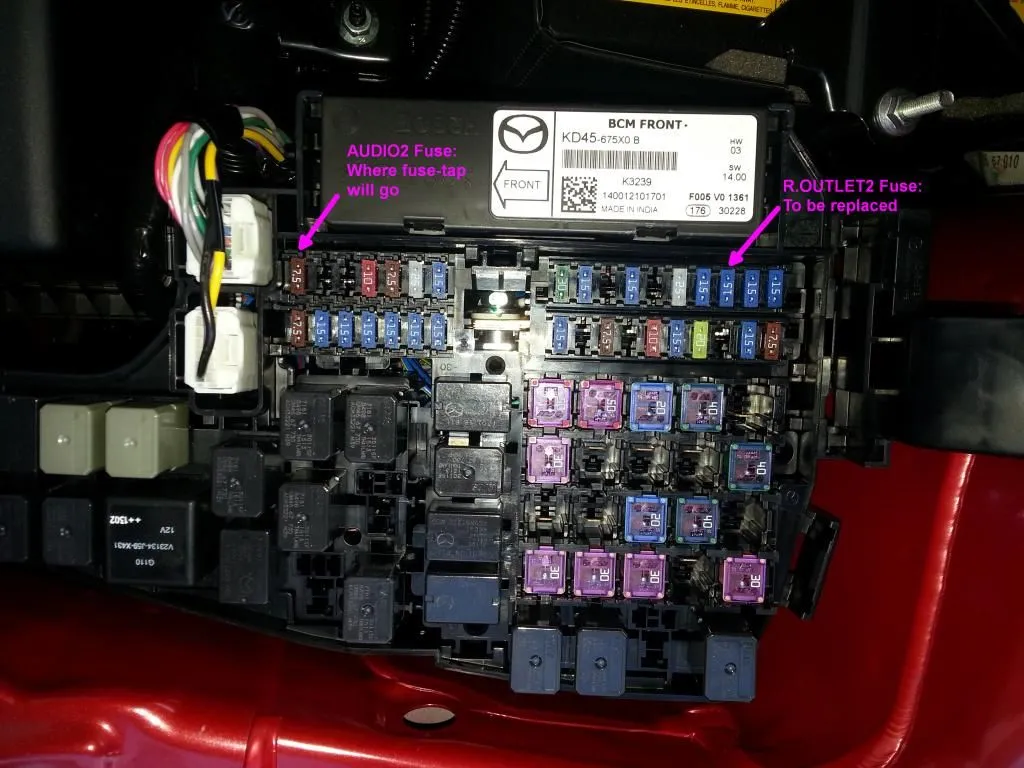

Unfortunately, the wire from the fuse tap is not long enough to reach the socket fuse, which is why we need the extra piece of wire. Here's the fuse block with arrows showing where we're placing all this stuff. Take your fuse tap and soldered fuse+wire and measure and cut it to length, so when you solder the wire together it will reach without too much slack (see the 'finished' photos in Post #2, to see where we're going with this). Remember: measure twice, cut once!

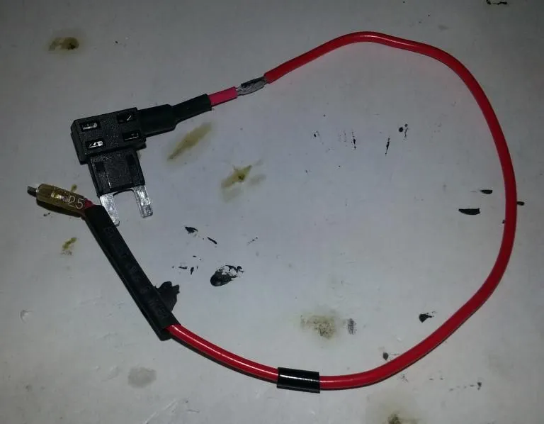

OK, now cut off the ends of the fuse tap wire and your spare wire and solder them together. Don't forget to slide on piece(s) of shrink-wrap first! If you don't have shrink wrap, you could insulate with tape, but not recommended.
attachment.php

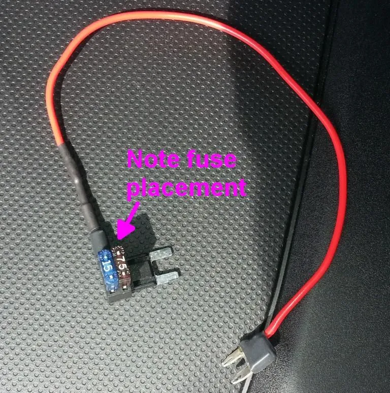

Final construction, shrink wrapped and the replacement mini-ATM fuses inserted. Note the positioning and ratings of the fuses:
attachment.php

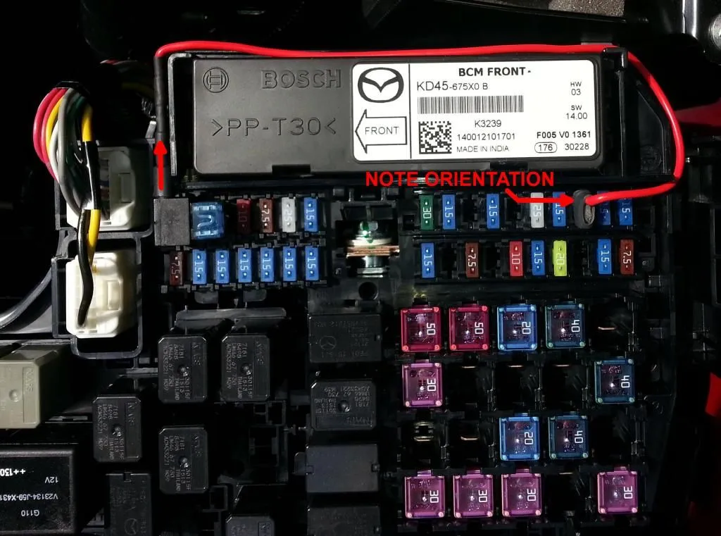

[CONTINUED] Lastly, remove the old low-profile fuses (stick them in the fuse box cover as spares) and insert the fuse tape and soldered fuse. NOTE THE POSITION AND ORIENTATION CAREFULLY!! If you get this wrong, you can connect the switched to non-switched supplies together and drain your battery, or even melt wiring and cause a fire. You don't want your nice new car to burn to the ground, do you?
attachment.php
Another view from a different angle, just to be sure & safe:
attachment.php
That's it! Now you can plug your charger in inside the console and forget it, without risking draining your battery. Yay.

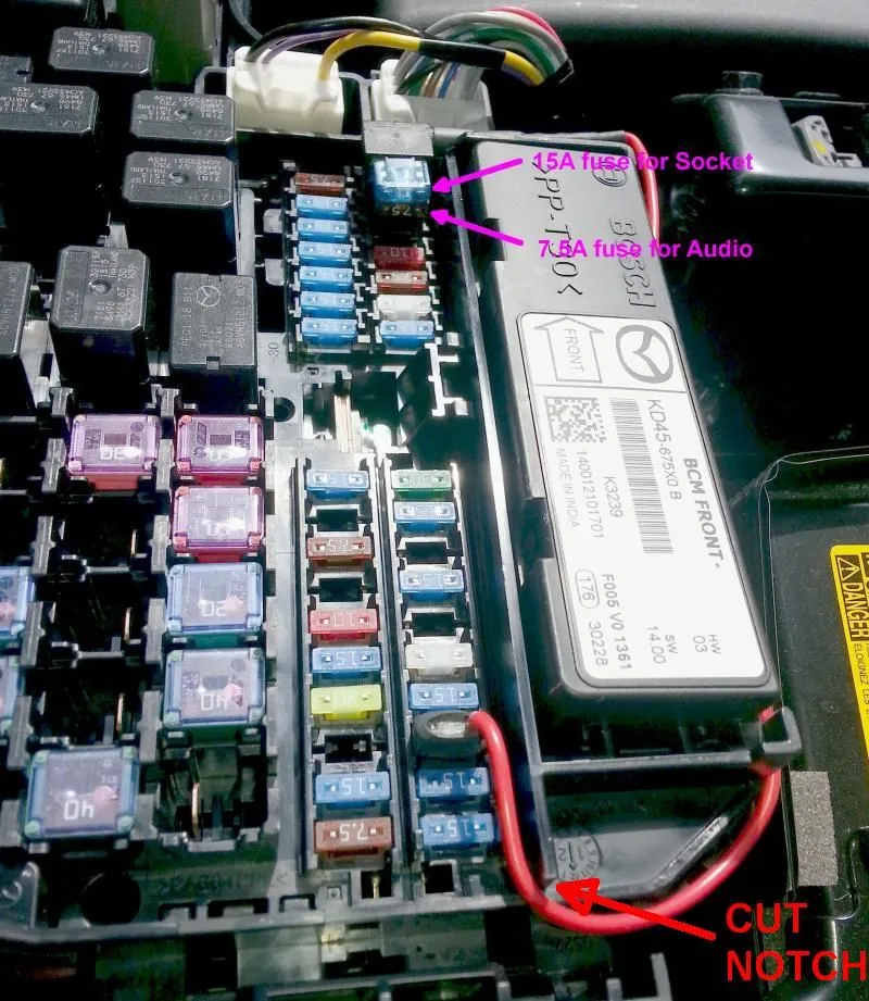

UPDATE: If you route the wire the same way I did, you'll need to do an additional step. Seems the clearance between the top and the bottom tray of the fuse holder is a little tighter than I thought and in one place it squeezes the wire. To avoid issues down the road, you'll need to cut a notch in the place shown for the wire to lie in. Either cut a "V" with a sharp knife, or better still, file a U shape with a small rat-tail file. The plastic is fairly soft, so this is easy (move the wire out the way first! :))
See photo...
attachment.php
