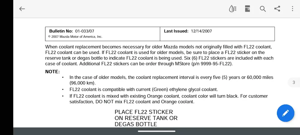

That's not true at all. Mazda Technical Service Bulletin No: 01-033/07 states
"FL22 coolant is compatible with current (Green) ethylene glycol coolant."
Ethylene glycol is the good old plain green stuff that's been around for decades.
The difference is, the old green is good for 5 years instead of 10.
I take this to mean that it's OK to add FL22 to old style ethylene glycol but not meaning to add old style to system filled with FL22.
"OK" in emergency, but you dramatically affect coolant life... you will need to change it after the coolant after it's 5 years instead of 10... you're better off putting in distilled water, so that it's not contaminated with inferior chemicals which affects coolant life
Right. The way it reads is that it's ok to mix new FL22 into regular green if necessary. That doesn't mean green will work well in a newer engine that requires FL22. The STB is from 2007.
All new syn oils are backward compatible with old dino oil. They mix ok and no ill effects. That doesn't mean it's ok to use dino oil in a newer car that requires synthetic oil. It won't ruin the engine immediately but engine life could be lower.
