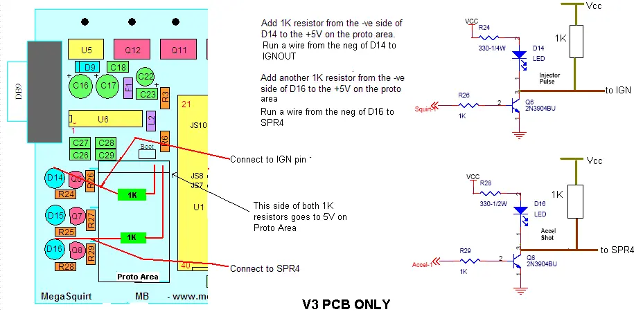

The image follow is how you need to wire inside your MS2 device if you assemble it by yourself, or you can show it to seller to let him configure.
Courtesy from dkarthik:
attachment.php
In my case im using a coilpack , because it comes stock with 98+ 626, basically its same type of setup, wasted spark, MS2 DIY kit comes with one coil driver, you need to have 2. Ask seller to add one.

Here are the circuit diagrams for anyone wanting to run the stock COP's without having direct coil control, just firing the built in ignitiors:
