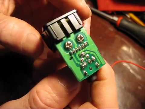

I know this is a Mazda CX-9 forum but luckily a Google search landed me here. I have the '08 Mazda 5 and was experiencing the same issue with the"Media" button on the radio console, as well as the "Mode" button on the steering wheel stereo controls not ever selecting the "Aux" mini stereo input jack next to the accessory power socket. The posts here helped me solve the problem. It was the internals of the little 3.5mm stereo input jack. For some (I think ODD) reason the engineers used a "sensing"-style 3.5mm input jack. When a 3.5mm plug is inserted into this jack it is supposed to "ground" its "sense" pin and this is used to electronically detect the presence of the inserted plug. This 3.5mm socket (and the circuit going back to the stereo) has 4 conductors. GND, LEFT audio analog IN, RIGHT audio analog IN, and this plug-SENSE IN (grounded = plug inserted). The stereo software will not allow the user to select the "AUX"/(media) input unless there is a plug inserted. Again, don't ask me why they would have taken this effort to disallow this choice w/o a physical plug inserted into the AUX input jack. The core issue was indeed that the little 3.5mm input jack's "plug detection" conductor was internally broken. The jack is soldered onto a larger assembly circuit board containing the interface plug back to the stereo system. I just removed the circuit board from the LDPE mounting housing and permanently soldered/shorted the sense pin to ground right on the circuit board. Now she works like a champ.. Thanks to all before who posted on the core issue of the jack being bad.
I had the same problem with my unit and shortening the ground and sensor pins (1 and 3 from the left on the internal PCB) worked a treat with in the Aux unit. Just pull it out using a screw driver and take off the casing to shorten it.
