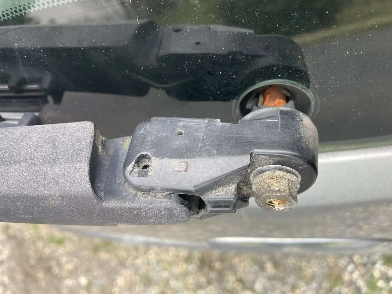

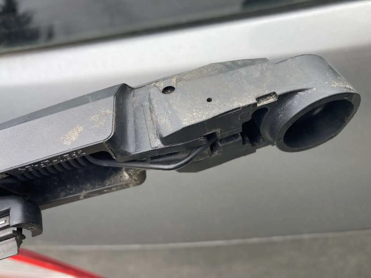

Once you pry off the plastic cover on the pivot, you'll see the wiper arm is only held on my an M6 nut (10mm socket):
Might take a little effort to get it off the splined stud. I used vise grips, with jaws on stud and behind arm to give it a little encouragement.

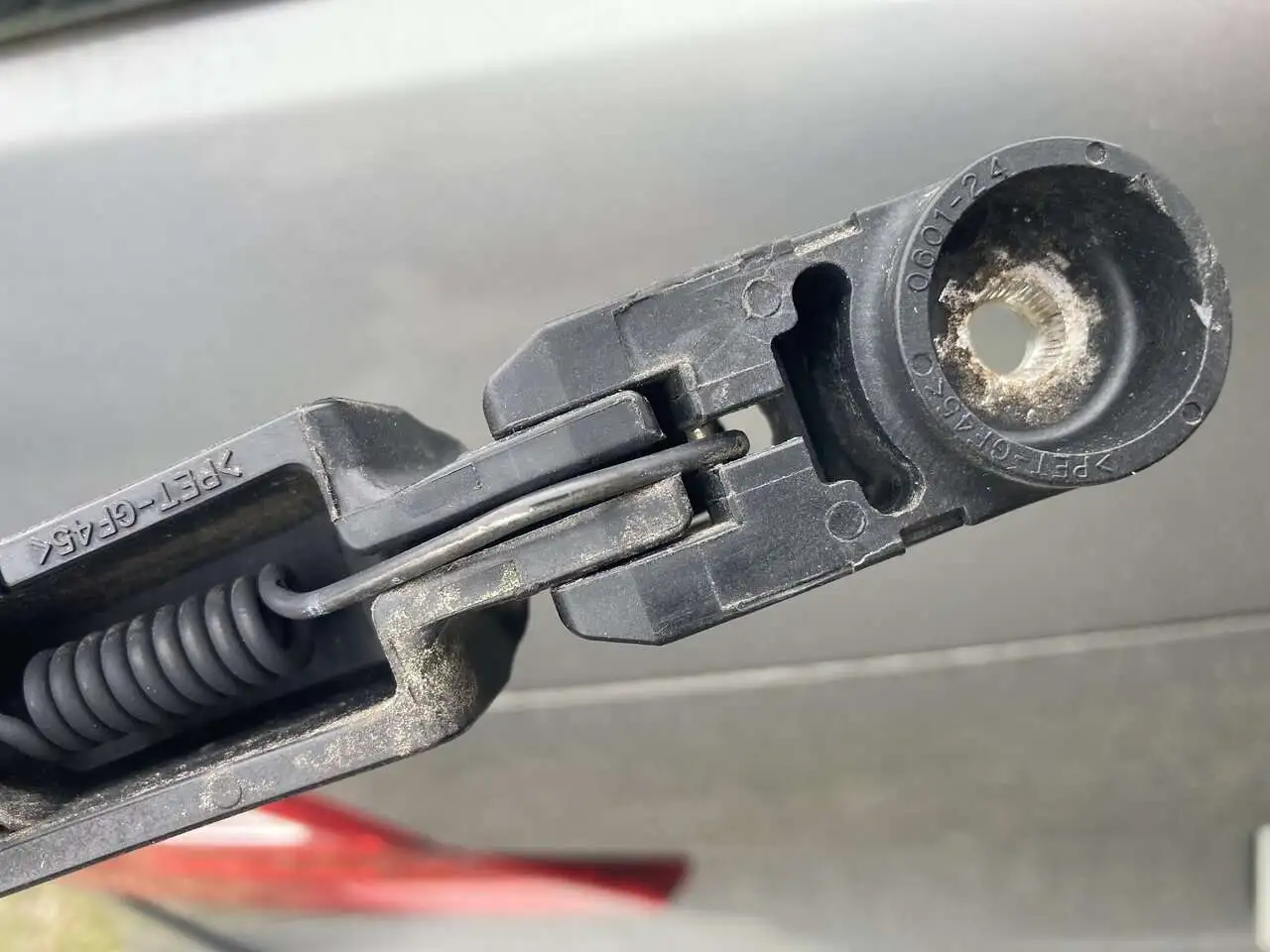

The spring on the back side:

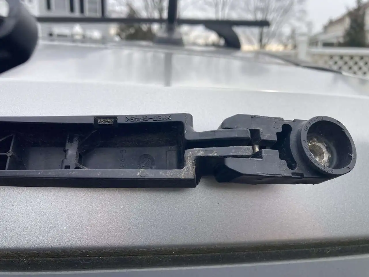

The arm without the spring:
Basically what I did was put a little more bend into the spring—the angled part of the wire. I bent it closer to 90º. Then I hooked the angled end around the metal pin on the pivot, and used a screwdriver to pry the other end back over the plastic bar on the arm.

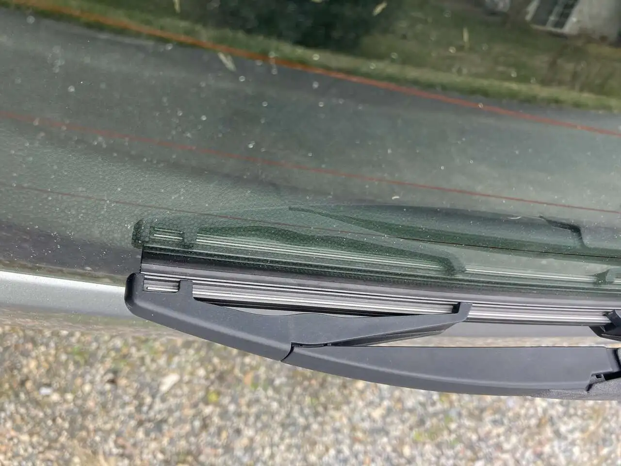

Now the blade actually contacts the glass along its whole length. Previously it was about 1/8" away from the glass at the ends.
