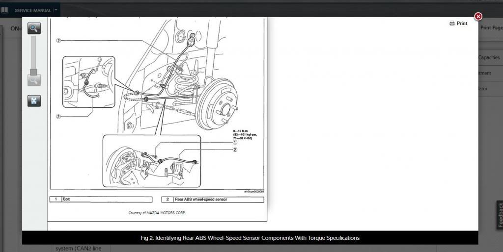

Unfortunately you guys will most likely never get alignment adjustment in the rear :(. ABS sensor on the 2's are pointing at the wheels and the sensor wheel is located on the back face of the bearing. The sensor shares a hole with the four hub bolts. Adding camber or toe moves the sensor wheel closer or farther from the sensor its self. causing bad reading and thus ABS/TC lights.

You may be able to shim the sensor, but thatll only work for camber.
