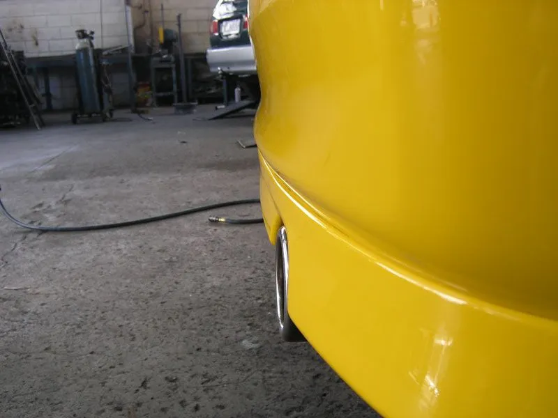

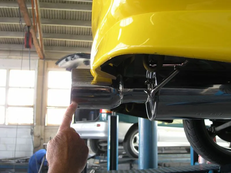

here's some pictures:
P1100160.jpg - stock muffler look from above
P1100166.jpg - stock muffler and mazdaspeed side by side
P1100172.jpg - mazdaspeed sticks out by 5 cm
P1100174.jpg - another angle
P1100183.jpg - it got cutted - no return point!

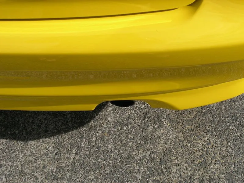

more pictures:

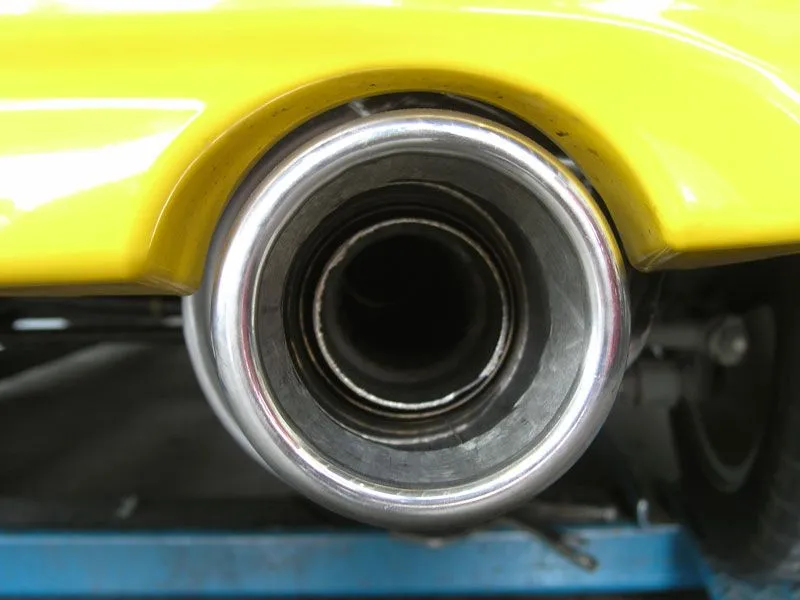

P1100188.jpg - ugh i forgot to check the orientation of the tip
P1100196.jpg - welded
P1100197.jpg - now this looks much better
P1100199.jpg - side view
P1100201.jpg - inside the tip

DeanSweet said:
question I have is the drain hole at the end of the tip in the right place?
so that's the drain hole, ugh?
i'm afraid i'll have to drill one myself. that drain hole is facing up.
