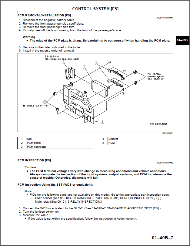

Under the carpet on the passenger side, under a metal plate held on by 4 10mm nuts. Wear leather or mechanix gloves when attempting to remove the metal plate, or you will get cut!!

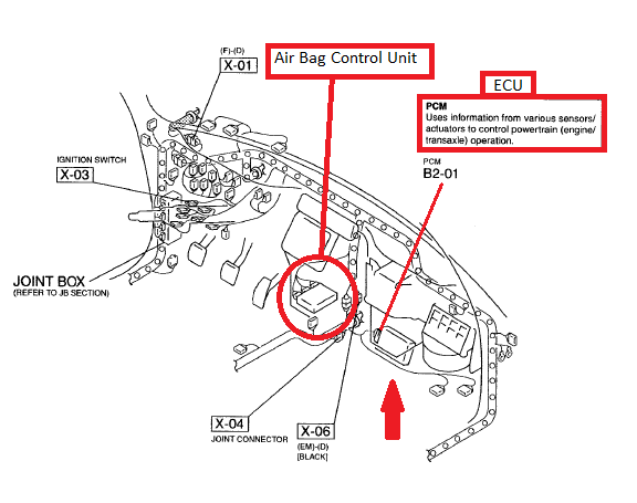

yes ive been eharing that... so what is it im seeing at the very front of the center console, in front of the shifter pushed back towards the fire wall?
sorry to bring up an old thread, but i stumbled across this thread looking for, what i believe is the answer to 02PROTEGE2.0's qestion and thought i would answer it, incase anybody else finds this thread.
the computer located under the dash and directly centred under the centre console is the Air Bag Control unit. you can acsess it by removing the two pannels on the passenger and drivers side.
Just a Visual for help.
If you're removing the PCM, be careful with that plate, as others have mentioned. Not only can the sharp edges cut you, but they can just as easily cut the insulation on some wiring. It's best to remove the plate, and then reach underneath, and remove the two 10mm nuts holding one of the brackets on, that holds the PCM in place. Slide that bracket off, and then the PCM should slide loose from that plate. Then remove the plate and get it out of the way.
I've actually taken the plate off atleast 15 times without cutting myself, not sure how, lol.
