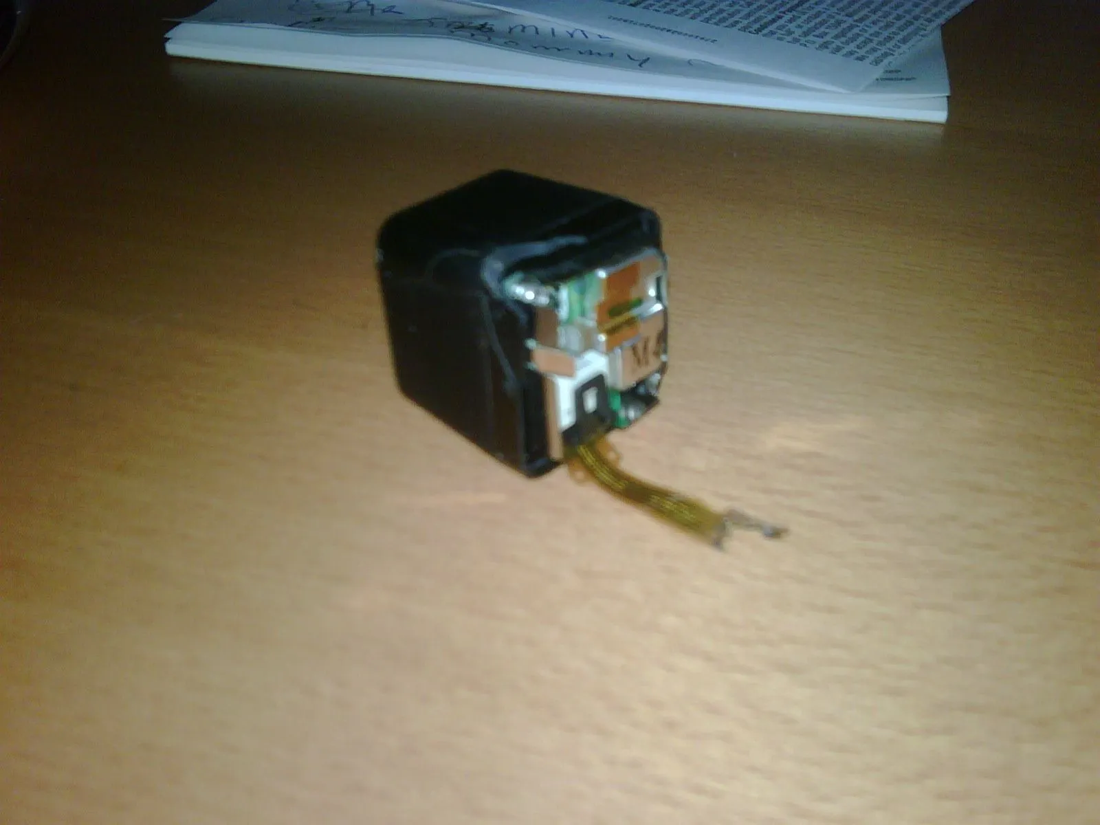

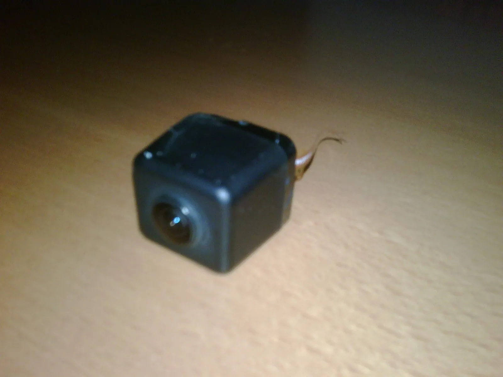

Does anyone have any information on replacing my 2009 Mazda CX9 GT Rear Camera? Someone tried to pry off my rear camera and completely broke it off...of course damaging while doing so. I've searched online for any parts related to it and nothing. Any suggestions/recommendations would be very helpful. I would hate to head over to the dealers or repair - $$$

I still have the camera. The thief must of tried to steal it by prying it off with a screwdriver. Basically, the camera looks like it was just ripped right off including damaging the wires. The camera was just laying on the ground. I suppose this can be repaired but I don't know anyone who's that handy with eletronics.

Well it could be time for you to become handy with electronics! If the damage was just a few wires getting ripped off of the camera you could try soldering them back on. It's worth a little bit of time and effort to try, even if it doesn't work because you'd have to replace the camera anyway.
Do you have pictures of the damage?
I've attached two pictures. It's a little blurry taken from my camera phone.
i'm not sure if i can repair these super small wires. maybe it can be replaced somehow.

There usually are two parts involved. A camera (shown) and a kit. The camera, IMO, is gone (ripped circuit strip). If I were you, I would ask for (or find) the part number of the camera, and buy it at lowest price on the web. Then, install it myself.

The problem with getting just the camera is that it looks like the circuit strip would have to be replaced too because it's cut off, as opposed to just disconnecting the camera and reconnecting a new one. Maybe there is an intermediate connection, but if not and it's one long strip all the way to the nav source, the whole thing will need to be replaced anyway.

How many wires are coming out of the camera? The mirror+camera kit uses 4 wires: green (+6V camera power), white (camera ground), red (NTSC video +), black (NTSC video -). So if your wiring matches that, it is the same camera and part 0000-8F-N07 would be the replacement. Also, that means it's composite video, so you can possibly replace it with a different video camera with composite output. There are some nice (seemingly) CCD cameras on ebay anywhere between $60-$160.
Captainbingo,
There's 6 wires and it's using ribbon cables...not composite. I suppose there is a difference between the cameras then. Not good for my sake.
Those flex ribbon cables are hard to fix. Without taking mine apart, my guess is that the ribbon cable is no longer than about 6 inches and mates to some type of sending unit in the hatch. The sending unit in the hatch amplifies and sends the signal via a shielded cable to the Navi system. Unfortunately, you cannot just buy the flex cable. As someone else recommended, search Ebay or a junkyard for the entire camera but even if you find one for say $200.00, you still run the risk that the item does not work.
