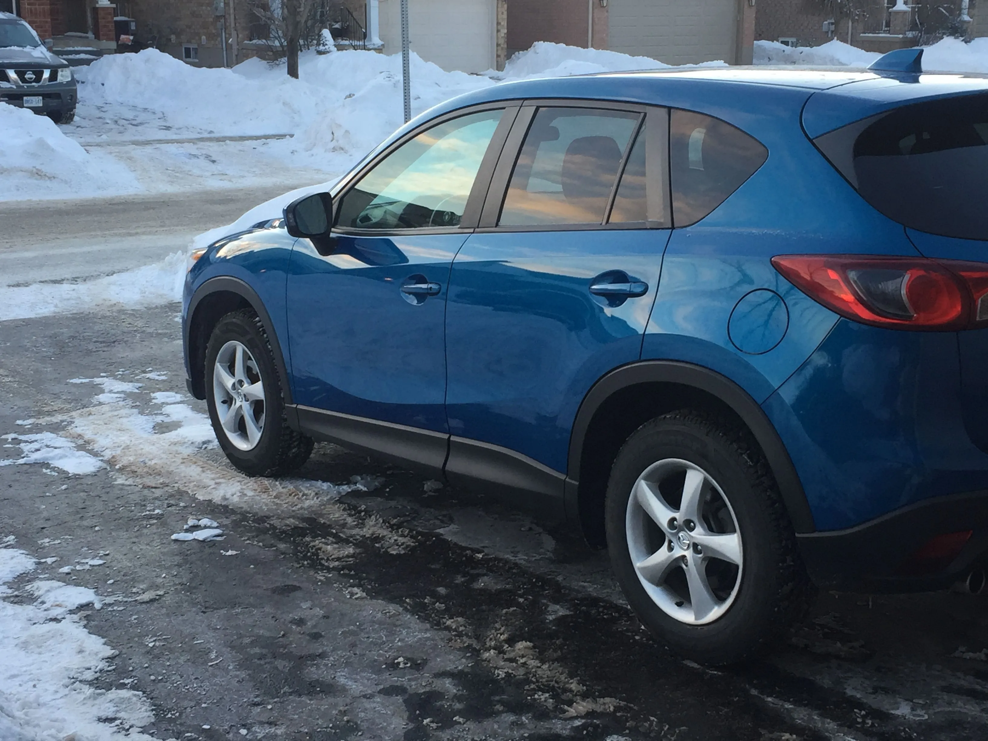

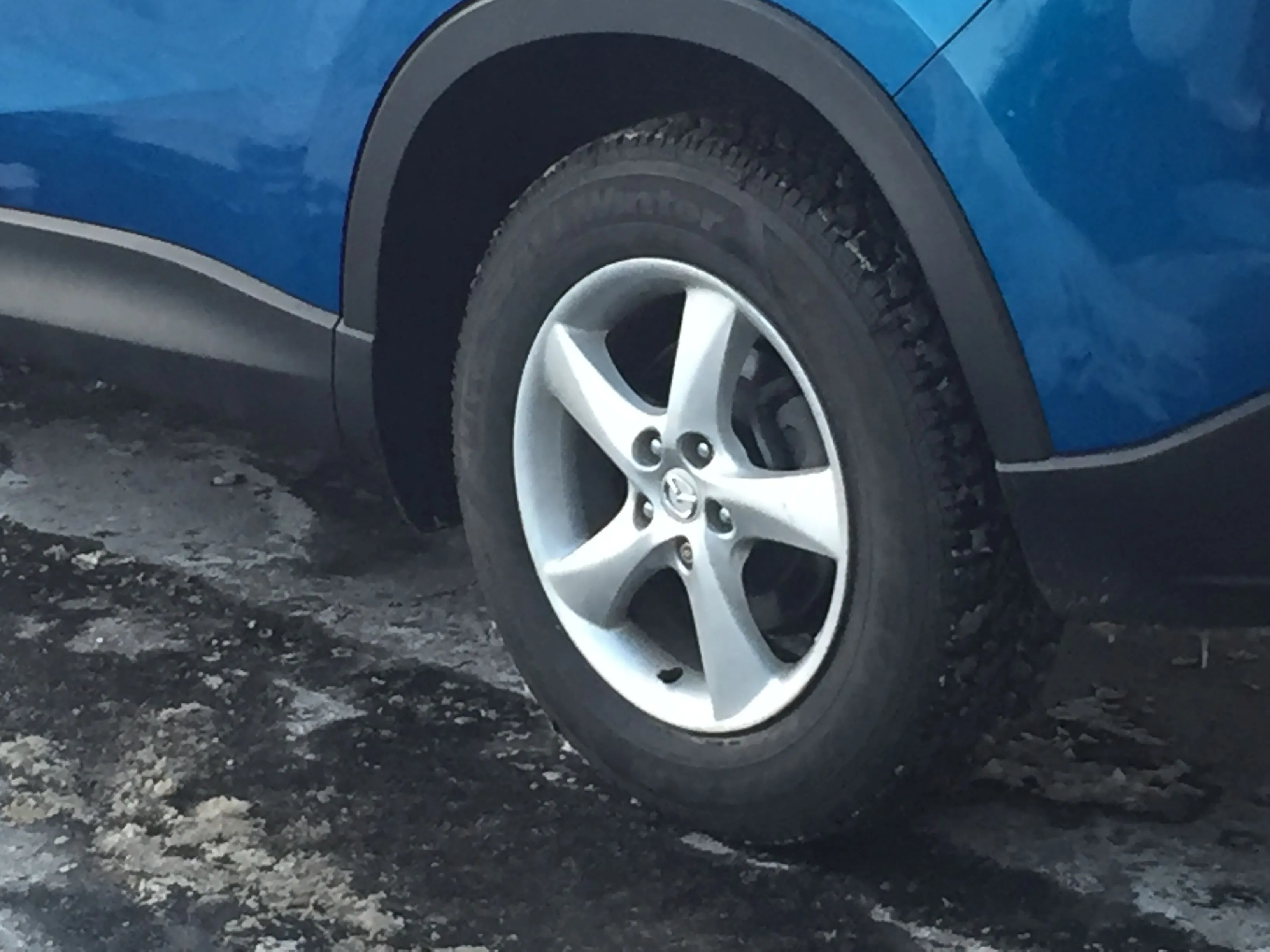

Installed! Mazda 6 rims and winter tires
Managed to get the tires and rims installed this afternoon. Everything worked well in the end. Thanks! ....and I think they look pretty great!
