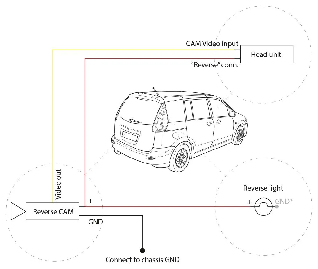

Looking at the car's wiring diagram I think the easiest way to connect the reverse camera is by connecting it's power to one of the back up lights (eventhough the camera preferably needs to be mounted in the tail gate and the backup lights are in the side units) . Removing the glove compartment to trace the signal there would be a lot more work.
My camera's video signal cable also has a wire for the signal to let the head unit know it's activated. In case of using the backup light as power source for the camera this be connected to the + of the reverse camera's power input which would result in the camera being powered as soon as you put the car in reverse which on it's turn also let's the head unit know the camera view should be activated.
Mocked up a quick schematic:
