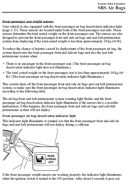

It will not deploy if the passenger seat is 66lbs or less... including 0 lbs.
Straight from the Onwers Manual...

Thanks..could not be clearer than that
I was just confused as the light never came on, with no pass.
You guys are awesome
love my 5
Yep, it'll come on for a few seconds for it's normal diagnostics mode at ignition, then it'll go bye bye until you get 1-66lbs in that seat. Good idea because it'd be annoying to have that light on 24/7 for an empty seat, but a good reminder for when you do have a small child riding shotgun.
