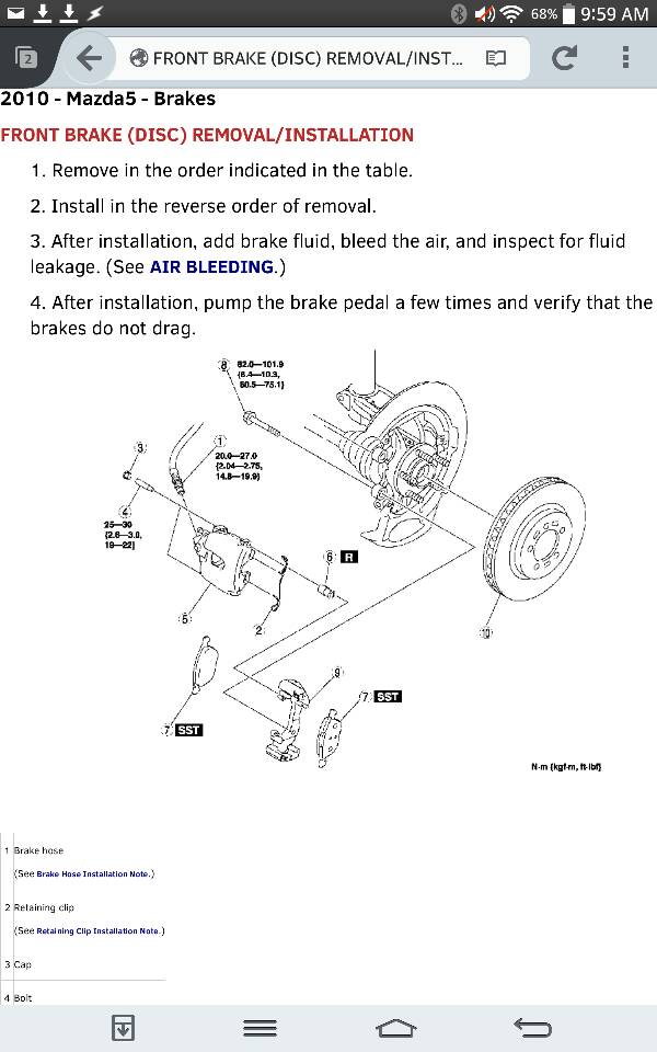

I am looking specifiaclly for the exact torque settings that need to be applied to the Caliper bracket bolts, Caliper bolts and the Wheel Nuts.
Thanks in advance
Mike
This is for the US spec Mazda5 2010
Wheel torque is around 85 ft lb

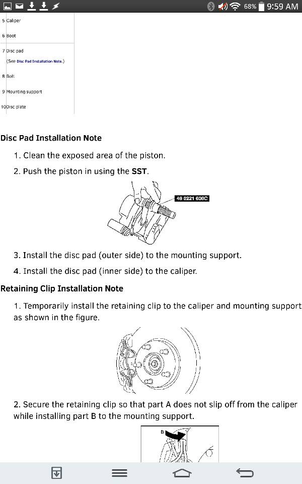

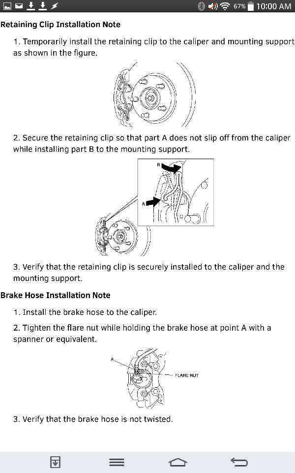

The instructions and pictures are very helpful.Could you confirm if i have read the torques correctly from the picture supplied
caliper bolt torque between (19-22) ft lb
mounting bracket bolt ( 60.5 - 75.1) ft lb
Disc pads installation note does not mention about the brake lubricant, Do you advise brake lubricant be applied at the back of the pads , on caliper bolt pins?
Do i skip the step to remove brake hose , if i do not have to add the brake fluid
Thanks Again
Mikehere
Torque specs are correct. On the back of the pads I use the orange brake quiet goop. You can use brake grease on the caliper pins if desired.
Not sure about the brake hose, I haven't replaced the caliper on this car
