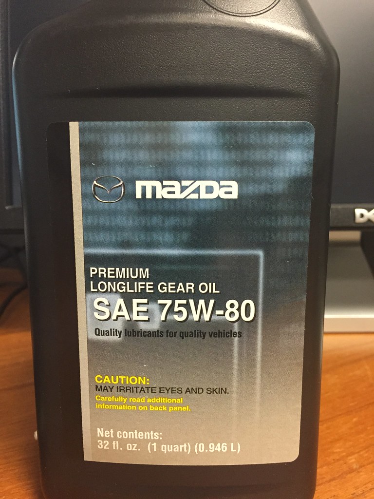

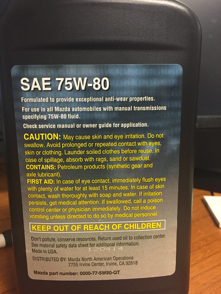

I decided to pick up two quarts at my local Mazda dealership. They cost $28.66 for a quart! They mentioned that their retail price for this is $42.99 and they were giving me a "discount." I do get free lifetime oil changes with the Mazda moly oil at the same location, which does lessen the sting a bit. This stuff is obviously available online for less, but when you factor in shipping it ended up being about the same. The bottle information is minimal. It only says "premium long life gear oil SAE 75W-80." No mention of any synchro additives or enhancers. I would normally associate long life manual transmission fluid with longer change intervals than 30k miles. I'm wondering if this is a newer product that was introduced for the SkyActiv models (like the moly motor oil). I'm at 31K miles and my scheduled maintenance book says the manual transmission fluid should be changed every 30k. My car was built in 04/2012 so maybe my documentation is wrong or they didn't have the long life formula when my car was built. Some Mazda 3 owners indicated that adjusting the linkage can help with 1-2 grind if changing the fluid doesn't help. I had narrowed down the alternatives to Redline MTL 75W80, Pentonsin MTF2 or Fuchs Titan Sintofluid FE SAE 75W. The Mazda brand fluid is probably designed for fuel economy. I'm not sure it's the best for enhancing synchro friction. The Pentosin and Fuchs are also quite pricey and run about $25/liter. Redline is around $15 per quart. I'll report back the results after I swap in the new stuff. If there is no change the next step may be CorkSport short shift kit.
For reference the part number is: 0000-77-5W80-QT
Here's some photos of the bottle front and back:
