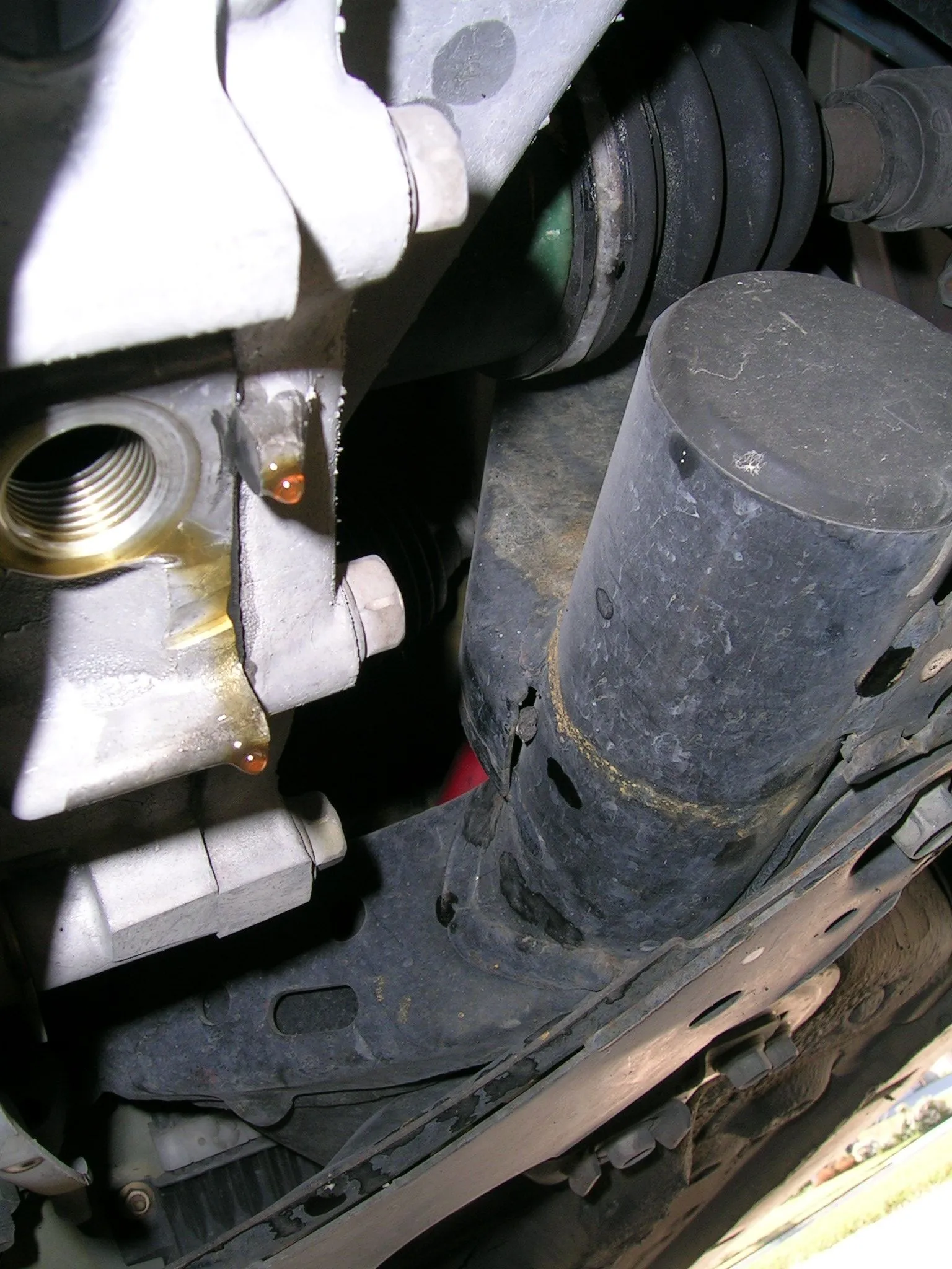

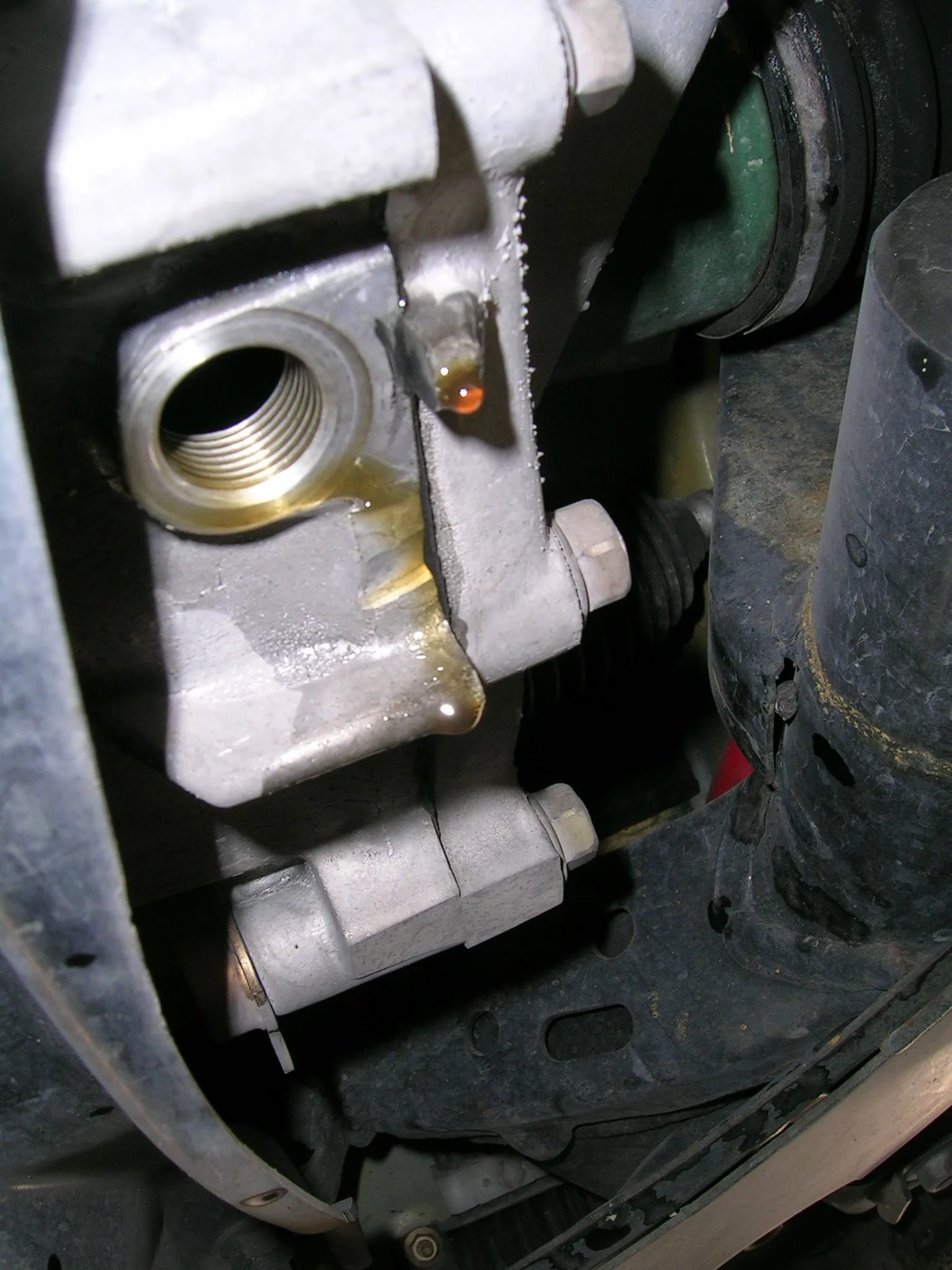

Transmission fluid FILL plug
I know this is an older post, but just wanted to provide additional photos for future search reference. Hopefully, this will assist others. Photos are from a 2003 Mazdaspeed Protege.

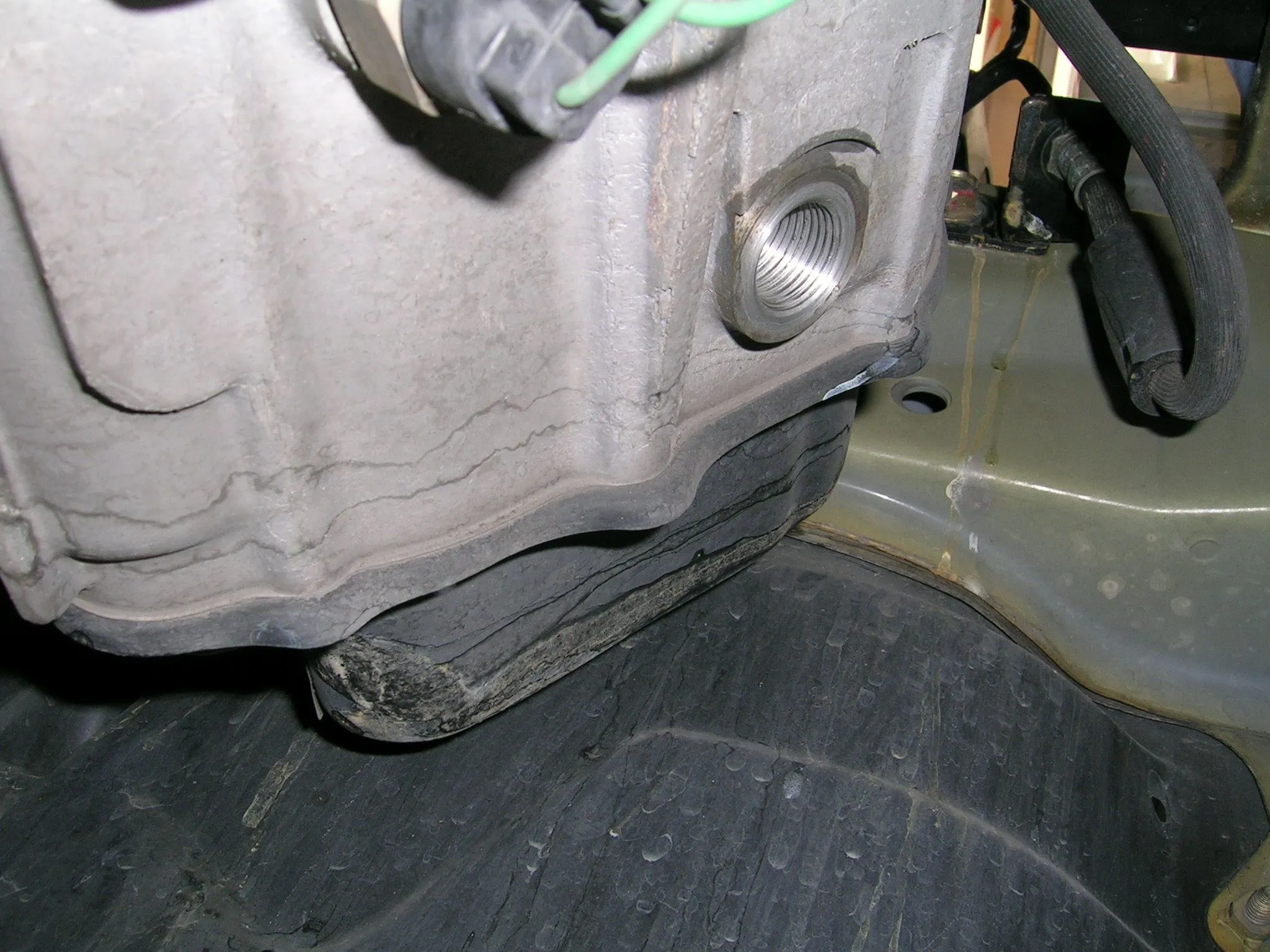

Transmission fluid DRAIN plug

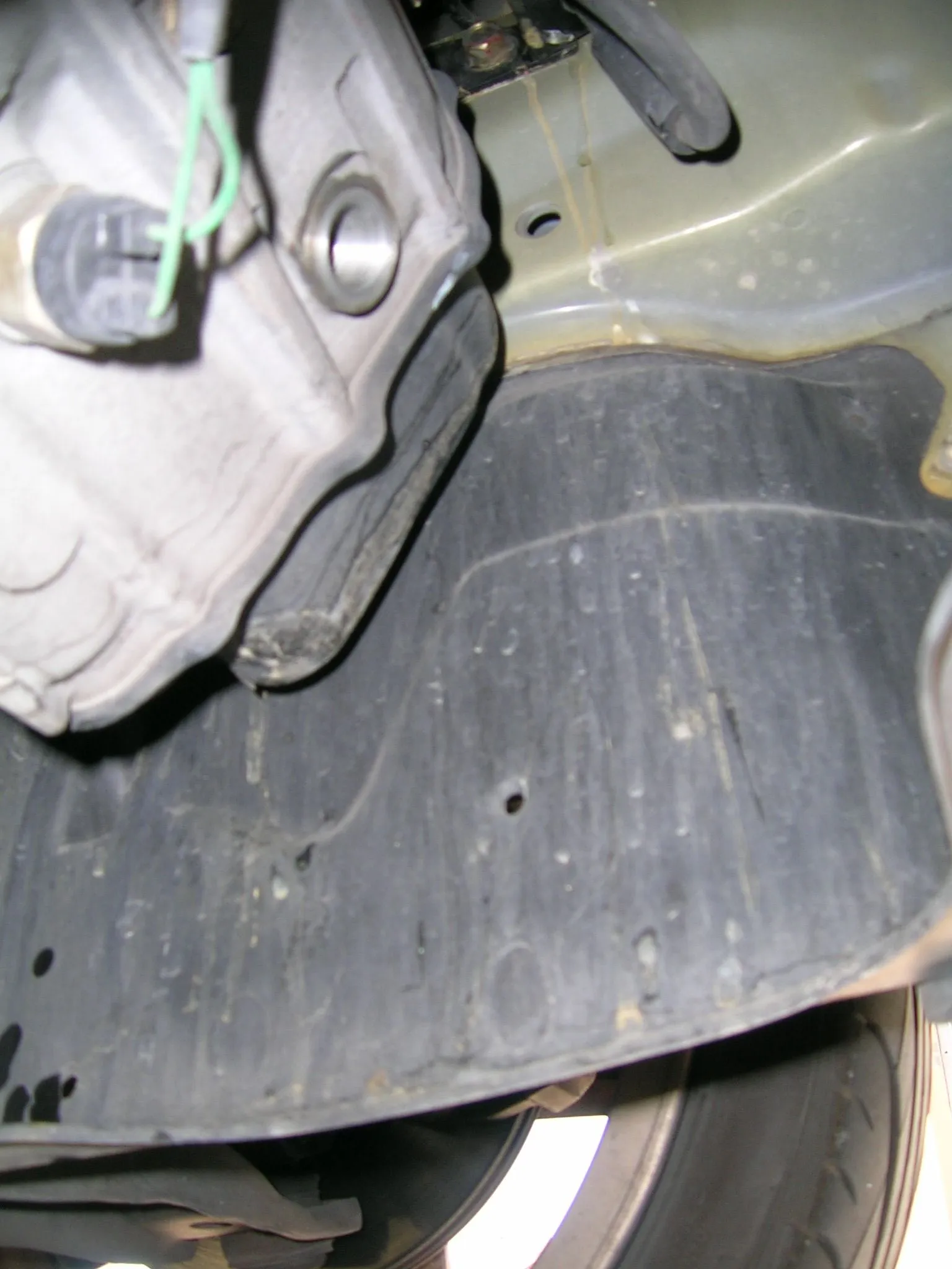

Transmission fluid drain plug

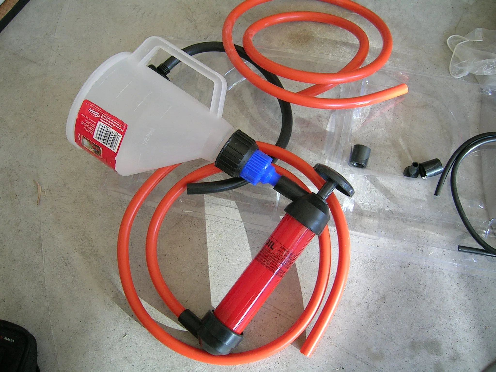

Hand pump makes the work easier
This is the hand pump I used. I did not use that blue plastic funnel cup, it did not work the way I wanted it to, so I did end up connecting both orange tubes to the pump. Worked out very well.
