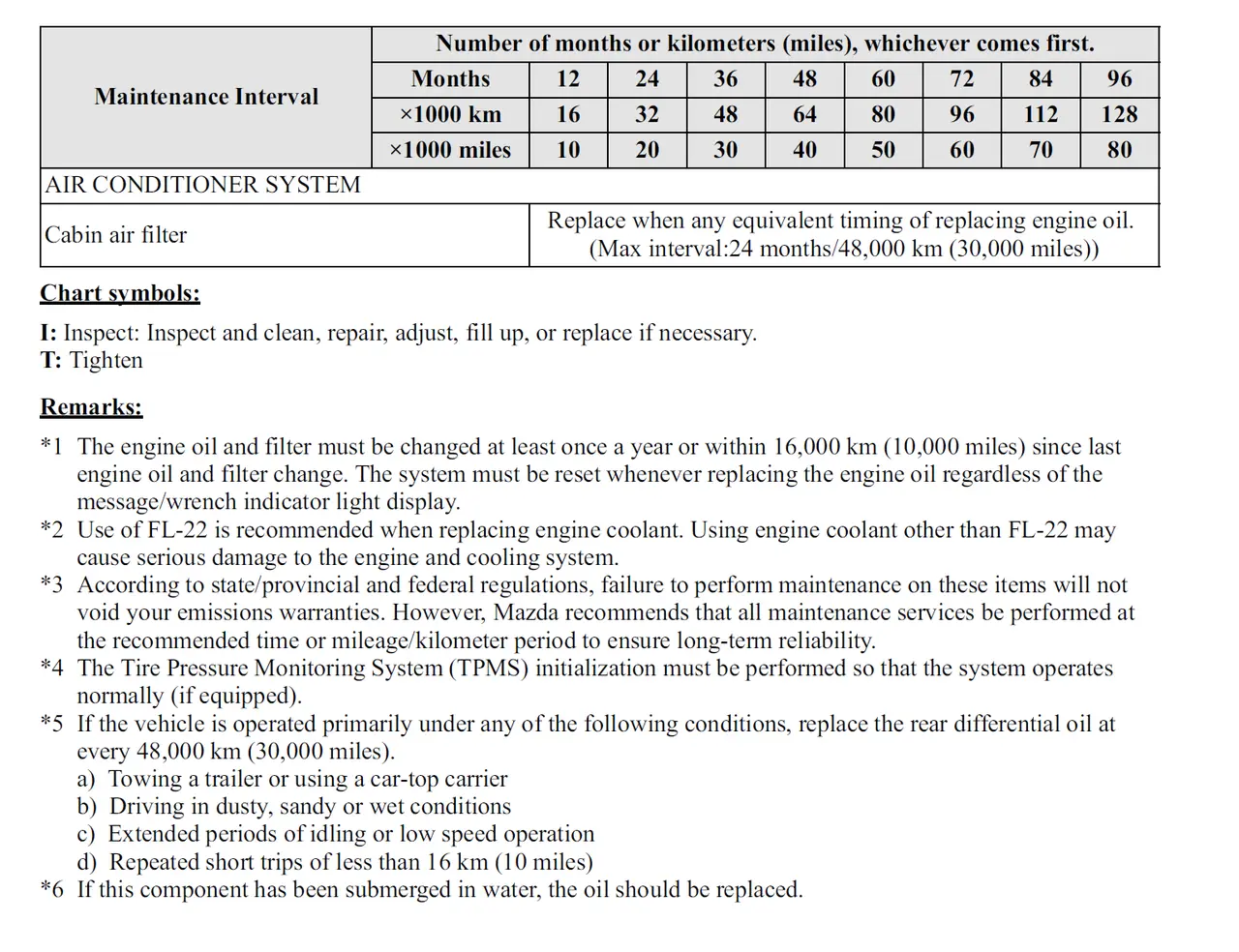

I will do my best to make this easy.
At your mileage, the only real thing you need to do right now is the drain and fill.

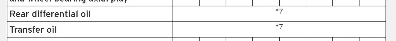

He also recommended the transfer case/rear differential fluid since mine is an AWD at $240 each.
I wish things were just black and white, ugh
Per the maintenance manual, rear differential fluid service is recommended only if you drove the car through high water.
It wouldn't hurt to familiarize with the manual of your car before you go to the dealership, that way you know when he's trying to take advantage of you.

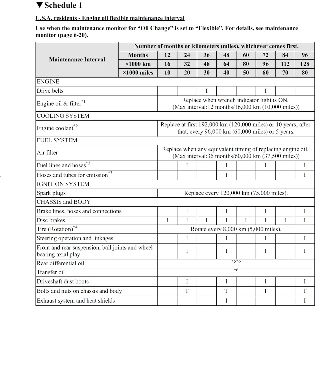

The previous screenshots were from my car's maintenance manual. Now I just noticed your car is from 2016 so there you go:
I'm actually on the far western side of Canada so I think I'm on a different schedule (2 in the manual)
Even still, things in the manual seem to be contradicted all the time by different mechanics and people here. How do I know exactly what to do when 5 mechanics/dealers I phone say to change the coolant only, and another 5 online tell me to do the trans drain and fill only. It's all just opinions I have to filter out and take a wild stab at what the right thing to do is.
I believe my car was manufactured in Nov 2015 (It's a 2016) and according to the manual coolant is required after either 10 years or 192,000kms
