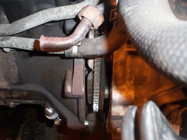

That location is the bottom of the transmission. Are there two bolts literally inside the tranny??
FINALLY, after MUCH searching, I found a pic. Looks like if I can just separate the tranny a bit, I might be able to get to these bolts. **** YOU mazda for doing this...
I don't know if you got it off yet. But I drilled two holes in the transmission bell housing to get to those bolts. Use a 1/4 drive and the thinnest 10mm socket I could find. Here's a pic:

I have no idea how you accomplished that. The flywheel is in the way. Even in your pics, you can see the flywheel... Crap!

If you look at the flywheel, there are slots that are grooved into it, so that when aligned vertically they give you access to the two bolts. You need to use the starter to turn it slightly until they line up.
Two ways of accessing them, pry the trans case a little (longer but better way) or drill two holes in the trans bellhousing (faster but not recommended way)

Well, I *just* finished getting the trans unbolted and moved over (after drilling the holes, but not realizing about the half moon access notches in the flywheel. s***... haha- there's a massive waste of time. It sure would have been nice of Mazda to document, you know, any of this in the service manual.

Because someone else will eventually want to do this, here's a pic for reference:

Yea Mazda's way of making things harder LOL. Yea I was trying to tell you about the two bolts hidden by the trans/flywheel in my first post. Should have included a picture as reference.
After dealing with it once, your first post makes perfect sense. Hind sight's 20/20. I guess it was a fun learning experience (or maybe not) haha!
eesh, I must have gotten lucky with the half moon access thing, cause I didn't have to move the flywheel at all. I have an atx tho, so there may be a difference...

holy crap!! talk about bringing a post back from the dead, i'm in the same situation too but u beat me 12hrs before i would have posted. i first tried loosening some of the tranny bolts but it didnt budge so i drilled the holes like in the pics. now i need to move the flywheel into position to access the nuts. i didnt temove transaxles, but had to take off the crossmember, the verticle bar (forgot what its called) and J-pipe.
