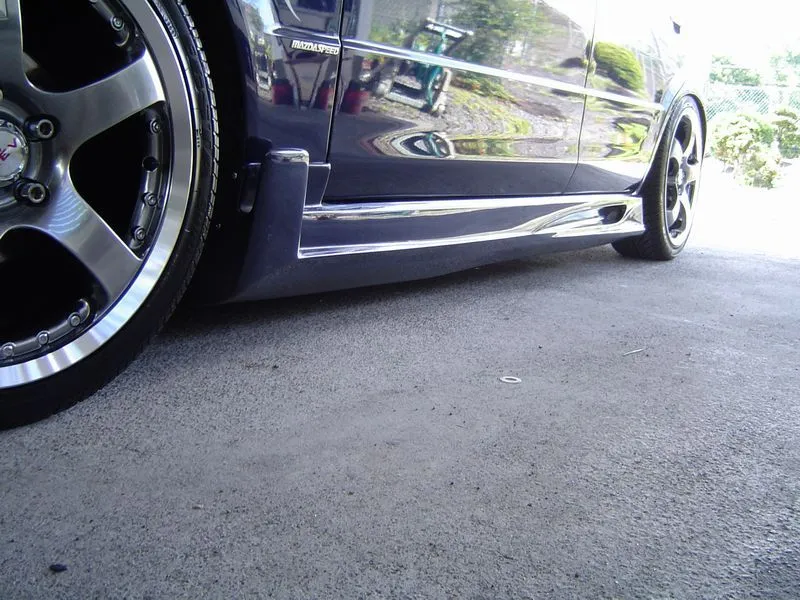

... wow really?? coilovers dont really drop the height eh? thats why my side skirts are about 1/2" off the ground now?

oh, skunk 2 coilovers.
pics ..

Nutari said:
ride quality is eh.. I got used to it.
pics ..
eh? Haha, as descriptive as it may be, was it a lot worse than stock or just a little? Those side skirts look really nice man, I'm thinkin about getting myself a pair of those since it makes the car look that much lower.

ride quality is pretty stiff. Lots of noise from the coilovers themselves, if you do a search on Skunk 2 coilovers, they are famous for being noisy. The only upside is that they drop lower than anything out there for the protege. Pretty much to the ground. mine are set only and half the drop in those pictures.
