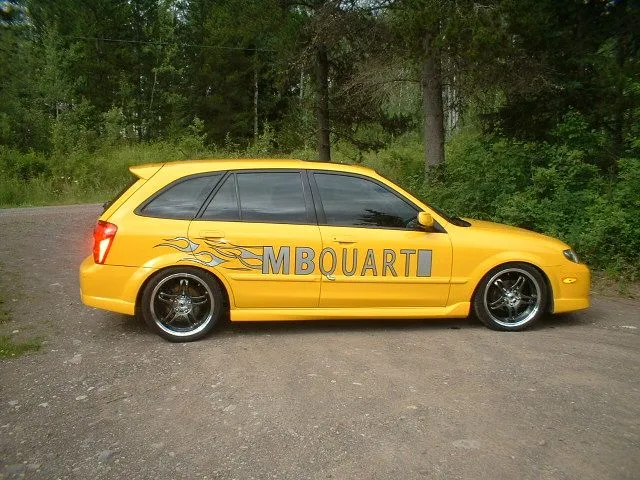

I just installed a set of coil-overs and when I move the steering back and forth, they make a clunking noise. After a week of driving it got worse. The top of the strut shows obvious friction damage. I lubed the top of the coilover and took it for a drive. The steering was lighter and less noise. What gives? I made sure the painted part of the strut points at 10 o'clock on passenger side and 2 o'clock on drivers. Help, I hate rattles!!!!

What type of coilovers and what type of rims do you? Size of wheels and offset? If you have the ground controls then if you could show us a picture of what it looks like installed.

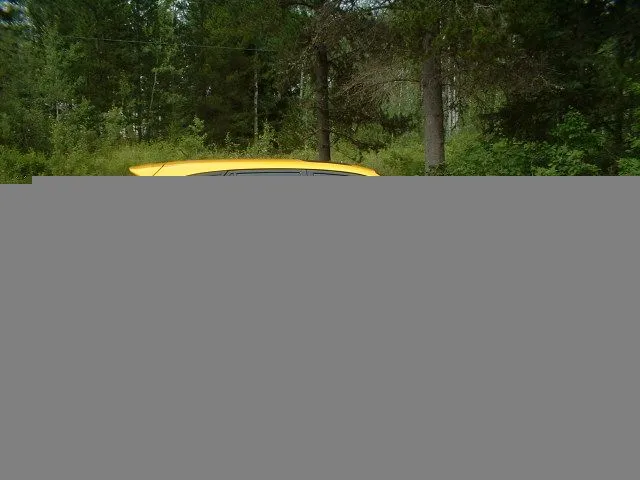

I'm using G-force coilovers. Basically a Skunk2/ Ground Control knock-off. Quality is OK. 17" Konig Holes rims with 205/40/17. The Holes have a +45mm offset so no problems there. I jacked the car and there is a lot of obvious friction between the inside top of the front struts and top of the spring plate on the coil-over unit. The whole strut twists a lot front to back as the steering is turned front to left. I assume that this is normal and with regular springs they would flex instead of rubbing back and forth and making clunking and squeaking noises???? Has anyone else with coil-overs had these same experiences?
