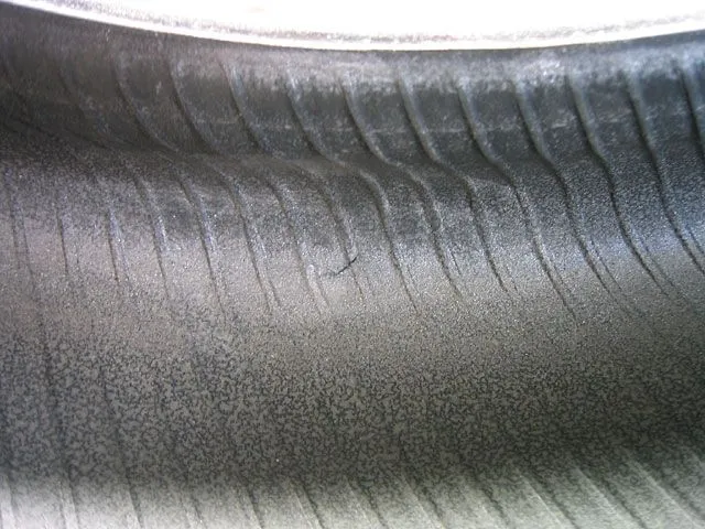

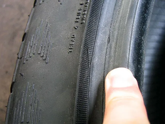

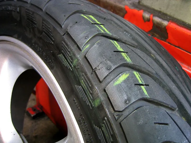

anyway, that tyre is history. there is a puncture on the shoulder which instantly reminds me of a "non repairable area" pic i saw. the shop owner said it's very difficult to repair on that part.
also there is another wound on the rim protector.
i did hit a hand-sized stone with that tyre a few weeks ago (construction sites and inconsiderate trunks everywhere), still no idea what caused that puncture exactly. i even examined the ground the other day at the gas station.
