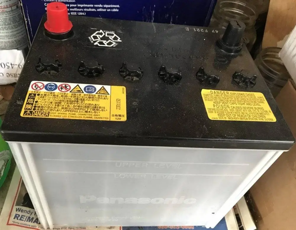

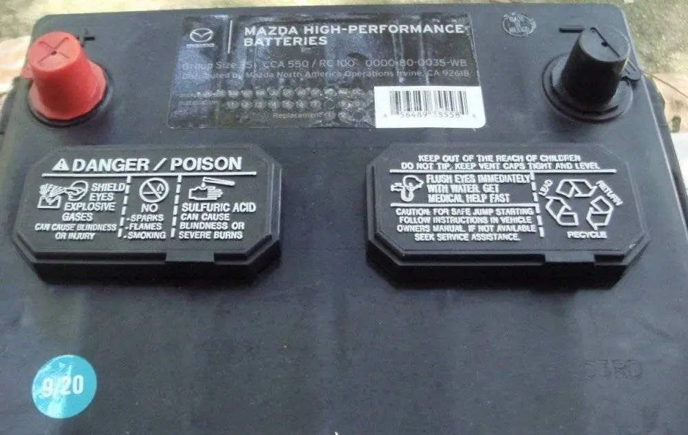

Mazda OEM “High-Performance” batteries sold in US Mazda dealers are made by neither Panasonic nor Yuasa but by Interstate.
Hmmm.. my bad...the original stock in my car has Japanese writing and is a YUASA 53D32L..the specs are approx. 32 lbs. My car must of been built in Japan and shipped over.
Good catch. Had assumed this was what was sold by the Mazda dealerships as the replacement stock #. The YUASA seems to be available online from different websites although shipping may be added cost. If Mazda only sells Interstate replacements, it's possible the battery weighs similar to the current weight of Interstate MT35 which is 550cca at 32.3 lbs. By comparison the interstate MTX35 AGM weighs 42 lbs, way too much for me.
So far the factory batteries we’ve seen in CX-5 for the US market are always Panasonic, as all US CX-5’s are imported into US from Japan.
Good catch. Had assumed this was what was sold by the Mazda dealerships as the replacement stock #. The YUASA seems to be available online from different websites although shipping may be added cost. If Mazda only sells Interstate replacements, it's possible the battery weighs alot more than the original stock...maybe similar to the current weight of Interstate mtx-35 which is a whopping 42 lbs...way too much for me... It was way down on my spreadsheeted comparisons.

Hmmm ...the Mazda battery(with Mazda high performance logo) shown in your first picture of the previous post top view had cca of 550 which is similar to interstate part# MT-35 of 550cca and 32.3 lbs. and only $145 at NTB. The above Costco battery is 640 cca which is similar to the MTP-35 of 38.2 lbs. So it appears the interstate 32.3 lb is most similar to the Yuasa/Panasonic stock battery.
Your right..was
braindead and didn't think about inability to shipping lead acid batterys due to hazard. My apologies. Please forgive my brain fart.
As far as Panasonic versus Yuasa... Panasonic transferred it's Panasonic Storage Battery Ltd subsidiary and all lead acid battery manufacturing to Yuasa International in October 2015. So regardless of nameplate, it is or at least appears to be the same battery.

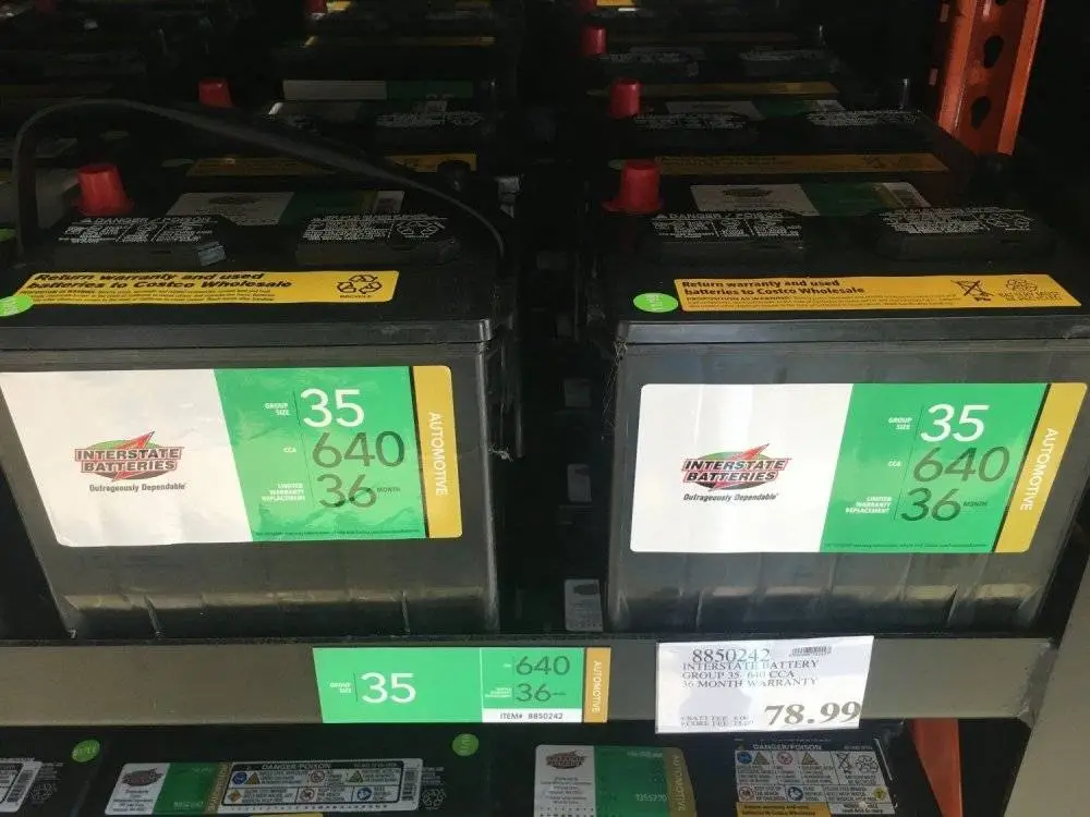

650 cca for $230 is decent enough, and if it only weighs 18 lbs that would be great.
Where can you buy this battery?
