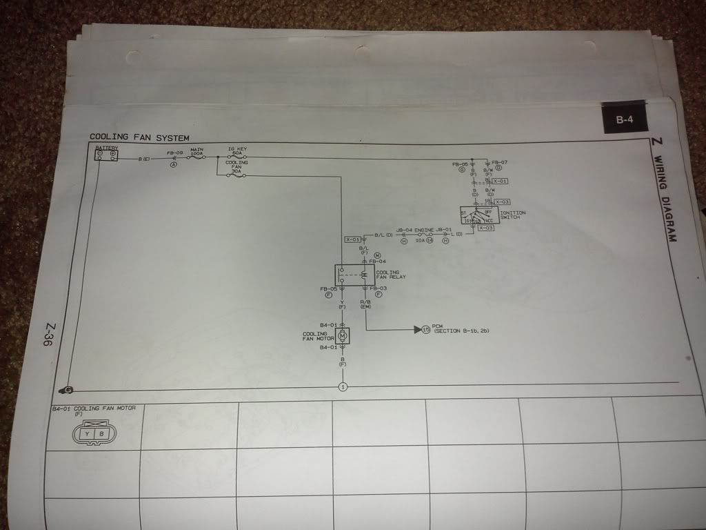

I'm just wanting that damn fan to work. It may have been too chilly lastnight for the engine temp to get high enough that the fan would come on - I never heard that relay click (the one under the hood in the fusebox), but I did check the fuse for the fan power - and it had 12.7 volts to ground. Power is there.....it's just that the relay isn't firing.
Maybe rev it up?
ihone i really thing the aftermarket relay setup is the best route for u to get it going quickly they can be bought at autozone or advance or other auto parts places..When I finished the swap I tried to have it exactly how u do now, but never got them working using the protege relay/wiring. Rather than spend more money and time on it i chose to y the relay setup and spent 15min wiring it up.
Just, to help you out if u want to keep the stock wiring and relay setup. You may need to give the protege ecu a rpm signal from the v6. However its not going to be correct. So, if you are doding what evan and I did and using a tach adapter for ur tachometer to work then, you can tap that wire going to the tach after the adapter and run it to the rpm signal wire on the protege ecu. Hope thats clear. I think the protege ecu activates the relay.
so....
v6 disty ------> Tach Adapter ------Protege ECU Input & Protege CLuster

ihone:
Here is the diagram for the protege fan wiring. As you can see the PCM controls the relay. However what variables the PCM needs to activate it are unknown to me. Im sure Temp, and RPM are likely the mandatory, but whether it needs a crank signal, cam position, emissions garbage, any of that is beyond what i know/can find. So, try giving the protege ecu a proper RPM signal and try that. If that does not work then I would ditch the idea and go with an aftermarket relay setup.

Well, until I get more money - I'm going to have to hardwire it to a switch. It's only a temporary fix until I get some more cash...
tomorrow is gonna be NO fun - gotta go to pulla part and get an intermediate shaft from either a 626 or an mx6 (94-97), and hopefully find a different PS neck for the reservoir feed line (the neck on mine is leaking something FIERCE!). I need to show ya'll the photo of my rear header too...the o2 sensor is 1" away from the power steering rack.....and I don't see any way to get it threaded in there, let alone run one in that spot. May have to weld a bung in the header in another spot just to make it work and plug that hole with a bolt.
yeah some of the chrome headers have that issues. As for the hardwire of the fan, wire it to key-on that way u don't forget to turn it on when the temp gets up there, also the stock temp gauge is so inaccurate i wouldnt trust it to judge when to turn the fan on.
good idea......It'll just be a temporary fix until I get it wired up right. I'd like to continue to use the factory wiring if possible - but as it stands now - I still don't have a tach adapter. Gonna have to wait for that.....

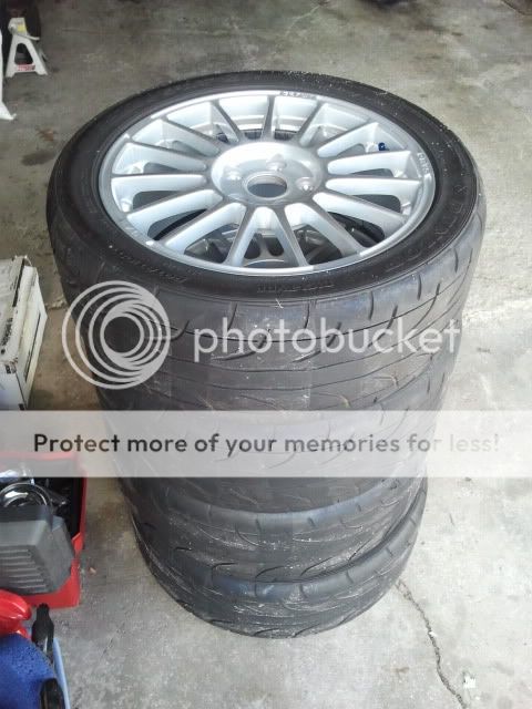

Well, I got yet another set of wheels for the P6. I am buying my roommates (fishdonotbounce) Rays.They're 17.7 +50 with Dunlop Star Specs 225/40-17 (IIRC) with Mazdaspeed center caps. And they are flawless without a single scratch. I'm super stoked. I was pretty jelly when he first got them. Gotta love Team Ohio!
I'm kinda over the whole "black wheels" thang so I'll probably strip my ASA's and paint them some crazy color like red for kicks. Or paint them silver and sell them but since the rubber is new I wouldn't get what I paid for for them so I'll probably run them a while.
