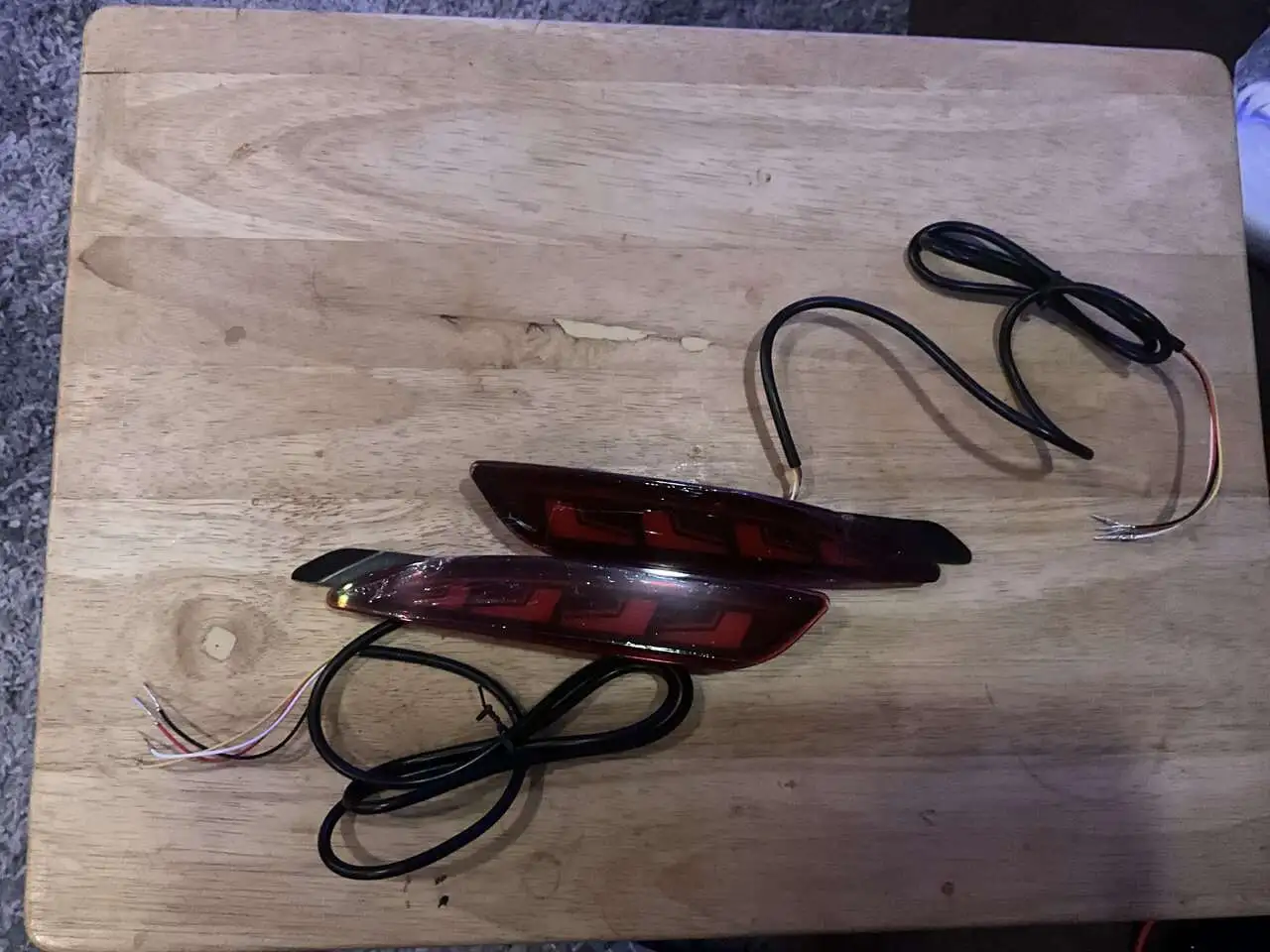

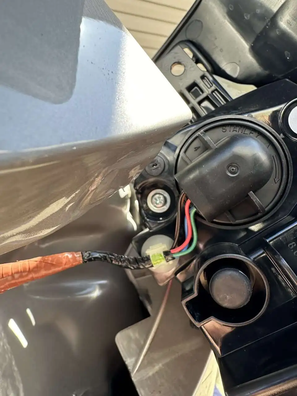

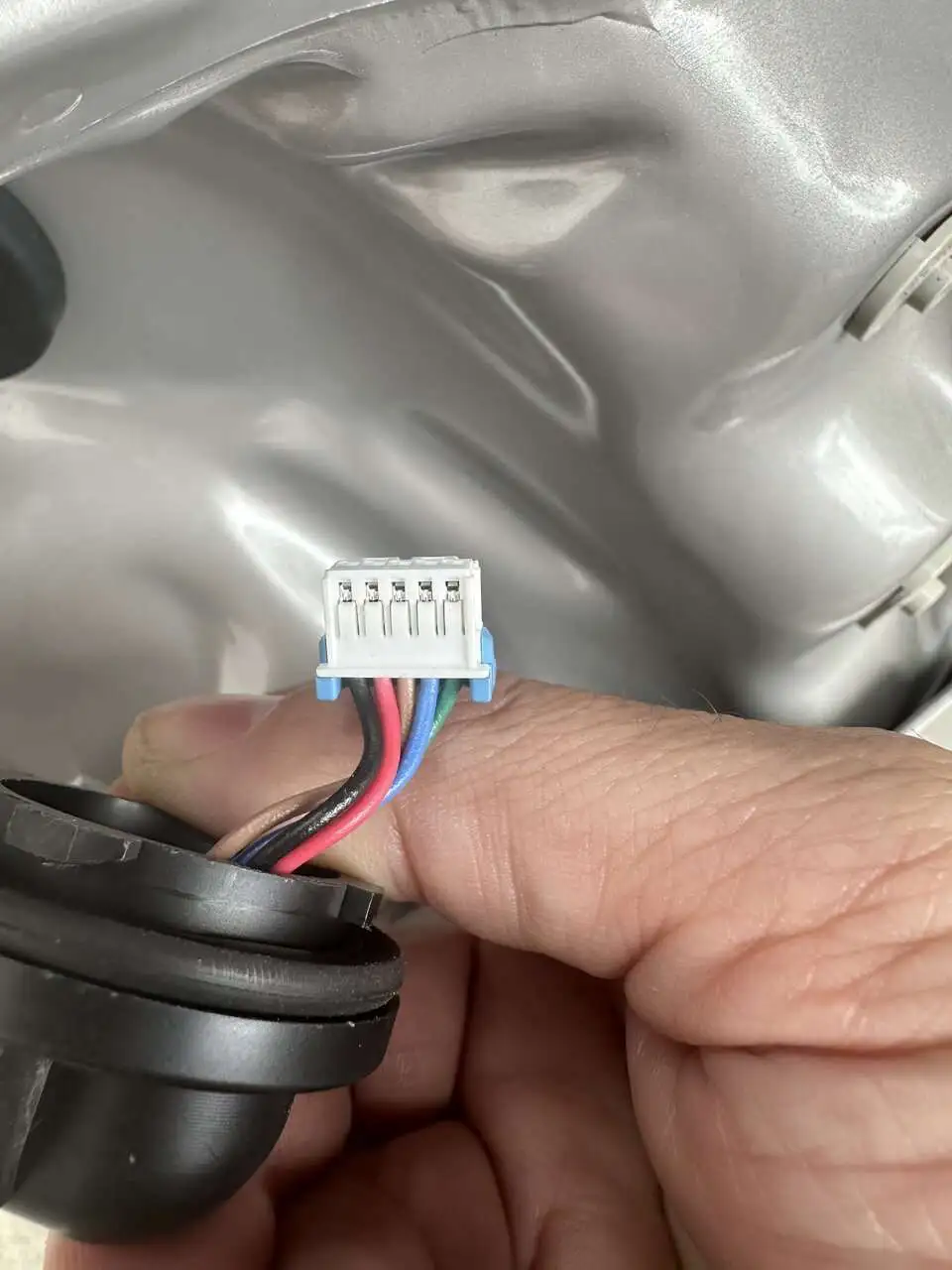

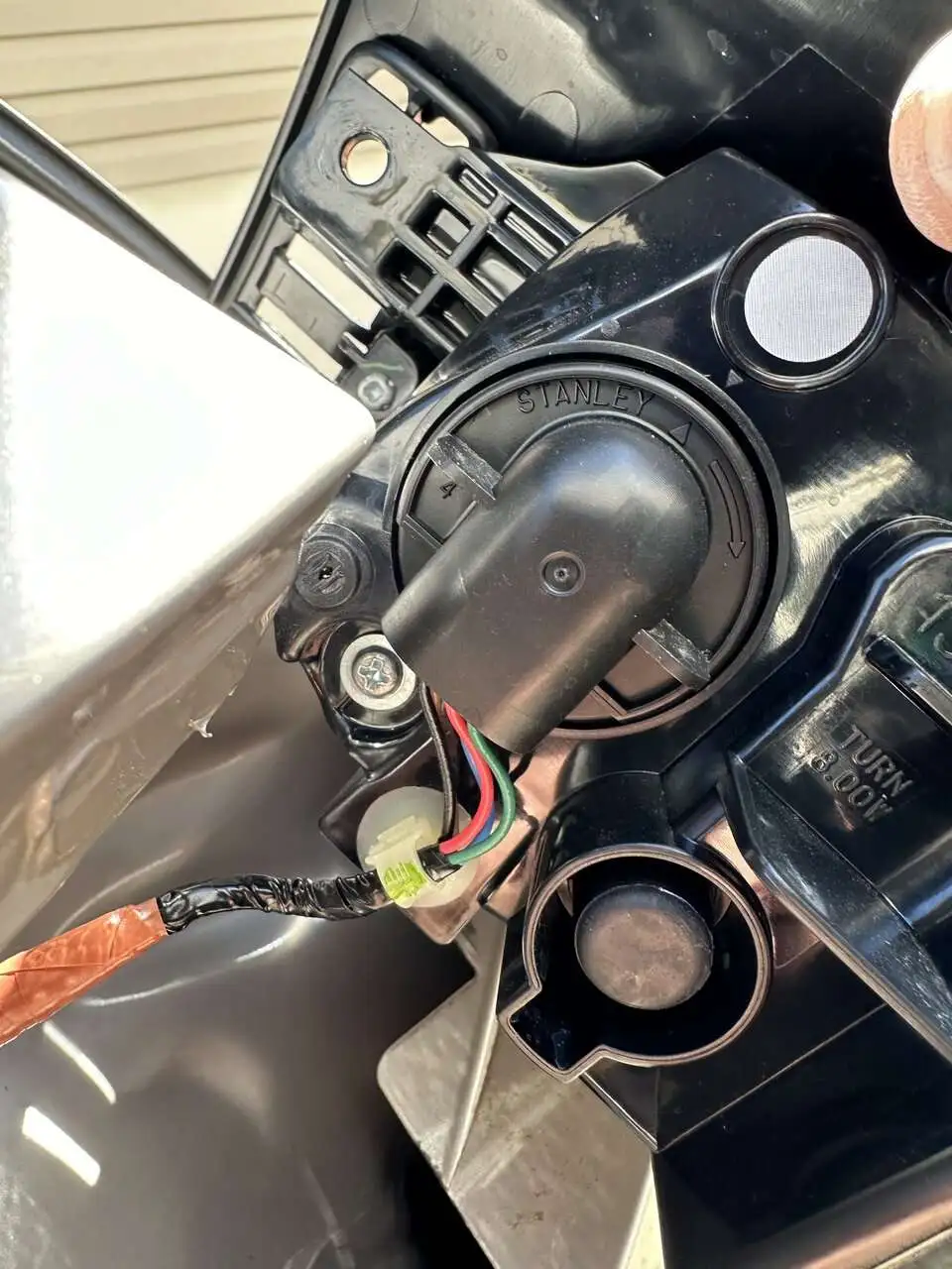

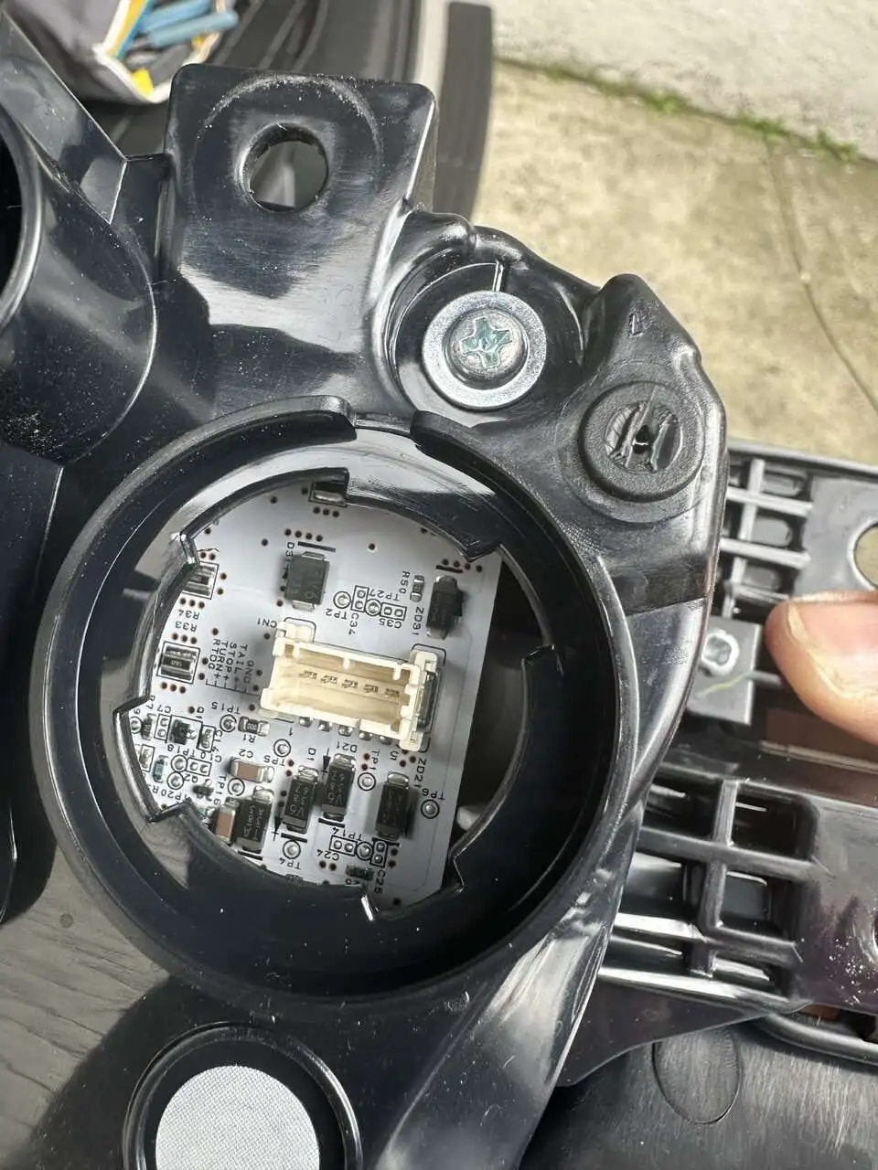

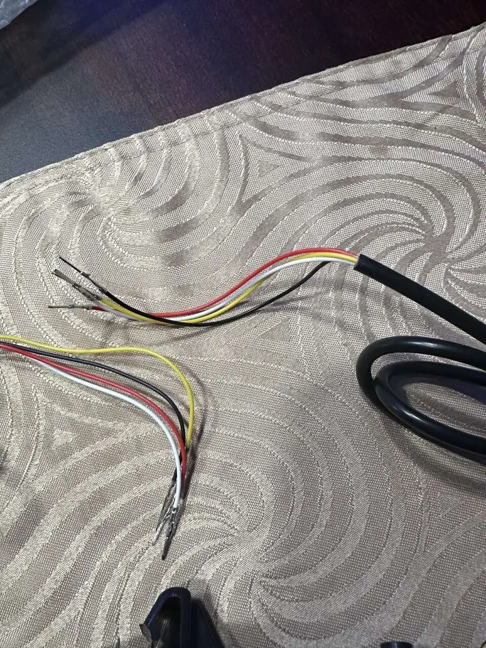

I'm installing LED Rear bumper Reflector lights. I need to know if anybody has identified the five wires that are going into the harness for the led rear lights? Any help would be appreciated it thanks

Send a link to where you purchased the lights.
You likely will not use the green wire in the OEM harness.
If I had to guess (again, a link to your specific lights would help):
Black light fixture to black OEM (ground screw or ground hub would be better).
White wire fixture (usually green but it’s a tail/running light) to red OEM.
Red light fixture (brake) to brown OEM.
Yellow light fixture (turn) to blue OEM.
