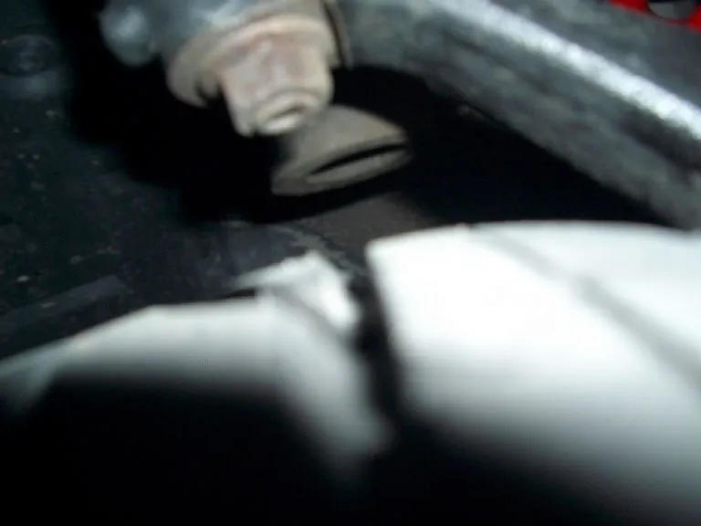

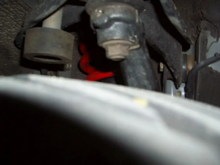

Can you check the clearance between the front tire and front suspension. I want to get the CE28N's but I'm trying to find out if I can get the 18x8.5 to fit.

I'll try to post a pic later, but there is about one index finger (width) of clearance between the tire and the suspension components and my wheels are 7.5 inches wide. The 18X8.5 ce28ns also have an offset of 52..so you will be 2mm closer to the suspension components w/ just the offset difference - if you factor in the extra width of the wheels, thats another 1/2 inch closer to the suspension components (1/2 of the width difference of 1 inch). I'm assuming that you want to run 235s w/ the 8.5 wide wheels so thats another 5mm (1/2 of 10mm) that will be closer to the suspension parts. the width of my index finger is about 1/2 inch. So right now I have 1/2 inch of clearance. 1/2 inch = 12.7 mm. Adding up the mm(s) closer you will be w/ the 8.5 wheels, we have +2mm (offset), +12.7mm (added wheel width), + 5 mm for 235s. Thats 19.7 mm closer in to the suspension w/ only 12.7 mm space. It might work with a 10mm spacer and then rolling the fender or might work with with 225s w/ 5 mm spacers.
Hope that made a little sense - long story short, there is not much room in there, but if you run spacers, it might be doable.

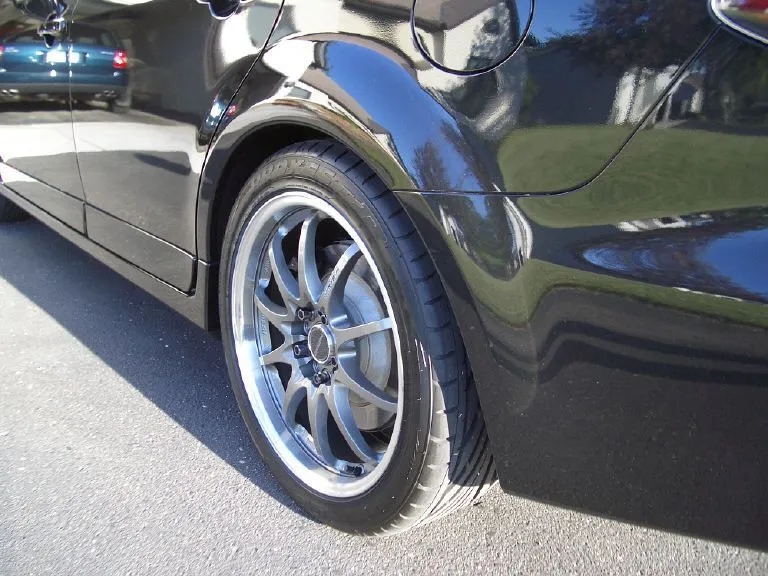

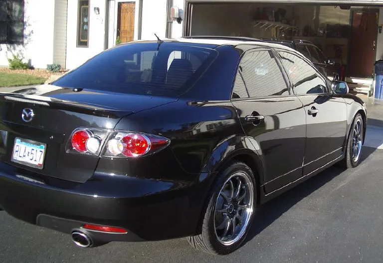

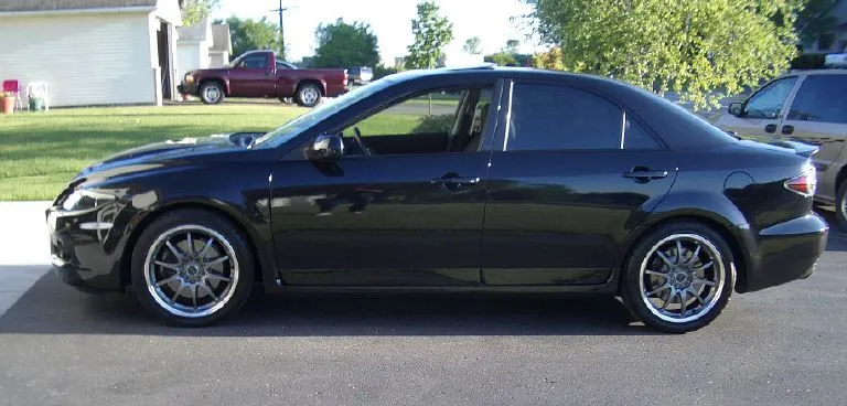

Thought I would update this post now that I've had the springs on for over a month. So far, so good. It has settled probably 1/2 inch or so lower and i still have not experienced any rubbing. I haven't scraped any steep driveways yet, but I have also been very careful. Driving impressions are still the same..slightly firmer ride with improved responsiveness. The car still has some body roll, but much less than stock. I haven't felt any more understeer than w/ the stock springs. The stock shocks seem adequate w/ the springs (for now) as the ride has not degraded or become "bouncy". I am keeping an eye out for replacement shocks (wonder if the konis will work) for when the stocks do eventually wear out.
I have developed a low speed clunk coming from the rear while turning that I need to investigate further...I don't have clue right now. Here are couple of recent pics..

Settled nicely...Nice stance...Do you have plans to do additional suspension mods?
How do the springs feel at high speed?
Thanks, shocks are the only definite future mod so far... Car feels rock solid at high speed even on less than perfect surfaces..no bounce...more settled than with the stock springs.
