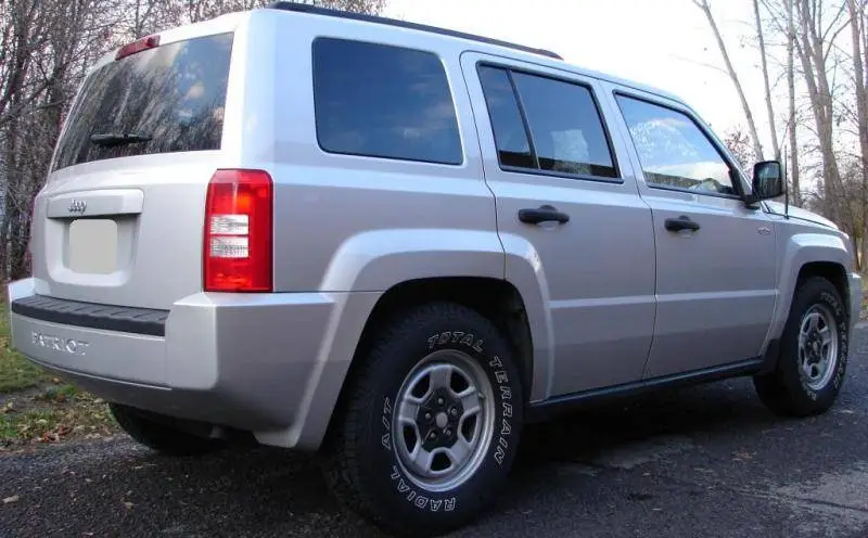

Pics of 235/70/16:
I'm looking at these photos to convince myself to spend the $1,500 this setup is going to cost to replace the average but perfectly usable Yokos. Comments welcome.
