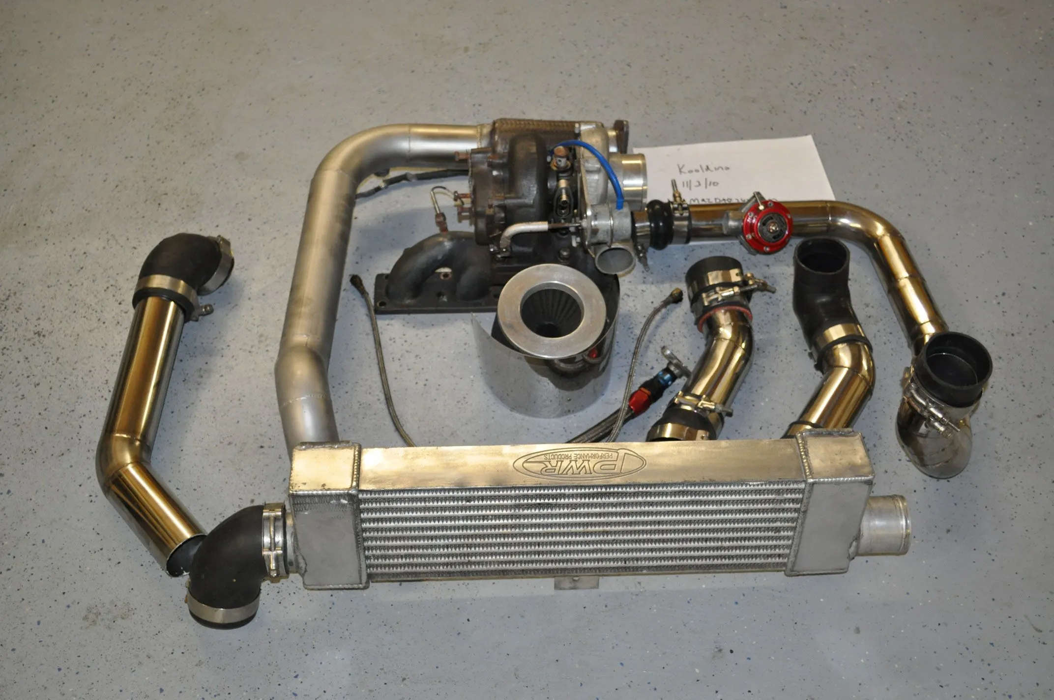

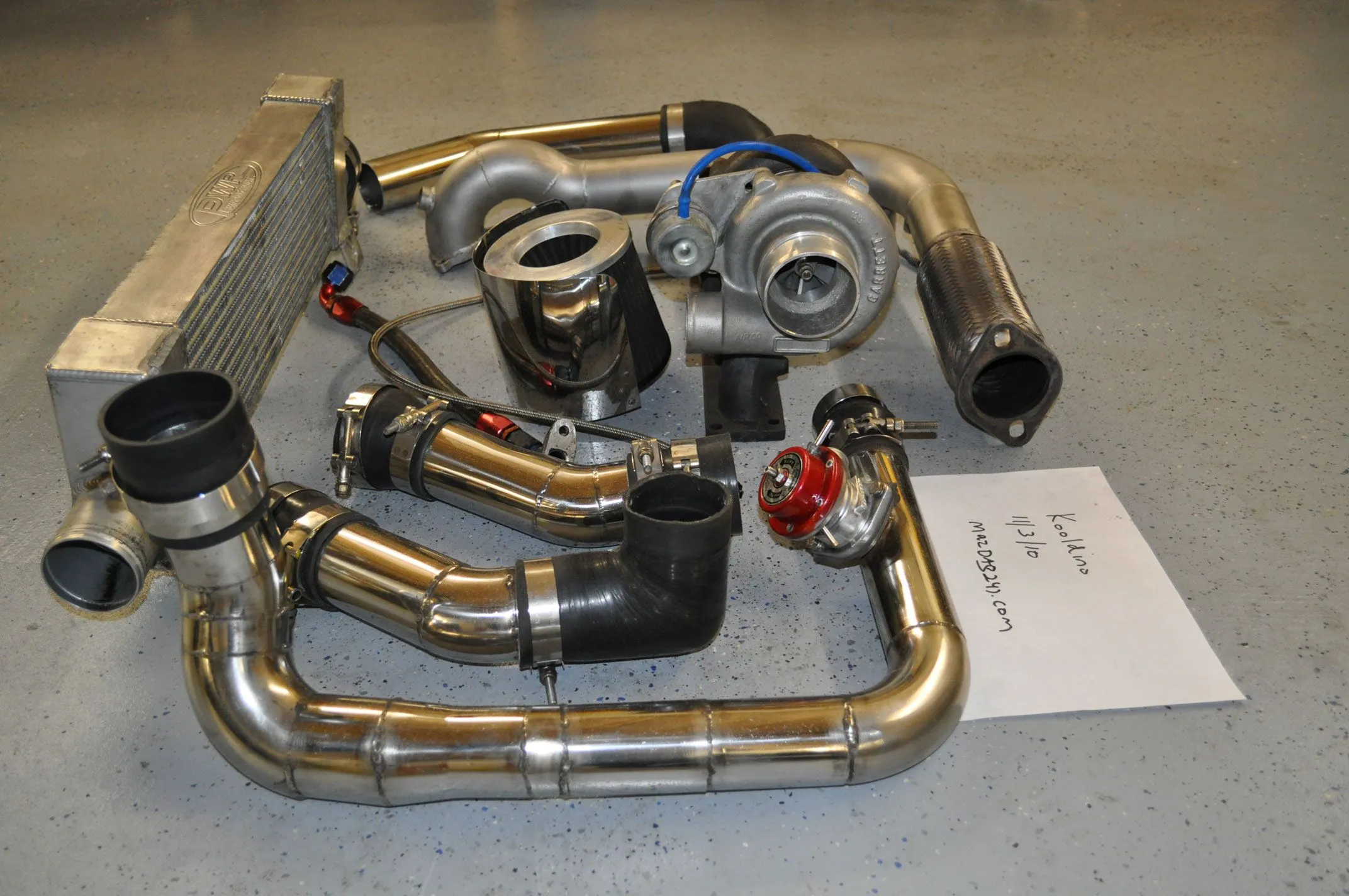

Selling my tried and true turbo kit off of my own personal car.
Includes a Garrett ball bearing 2871R turbo with less than 100 miles on it (I ran the kit with the 2860 turbo on it, but I bought this one as well).
Specs:
  • TIG welded Polished Stainless steel piping
  • Set up for both draw through or blow through maf
  • Genuine Garrett 2871R dual ball bearing turbo - barely used
  • Stainless oil feed and return lines
  • Powder coated Greddy Type S BOV
  • K&N Air Filter
  • Heat sheild for air filter
  • HKS Wastegate actuator
  • Cast exhaust manifold - jet hot coated
  • T bolt clams
  • Silicon Hose couplers
  • PWR Front Mount Intercooler
  • Bung for water meth injection
  • Wideband sensor in downpipe
With this kit on the car, my car ran low 13 second quarter miles at full weight on street tires.
$2200 obo
REDUCED TO 1900 obo WITH TURBO or 1200 WITHOUT TURBO
Attached are two pics of the kit off the car, and one pic of the kit on the car.
