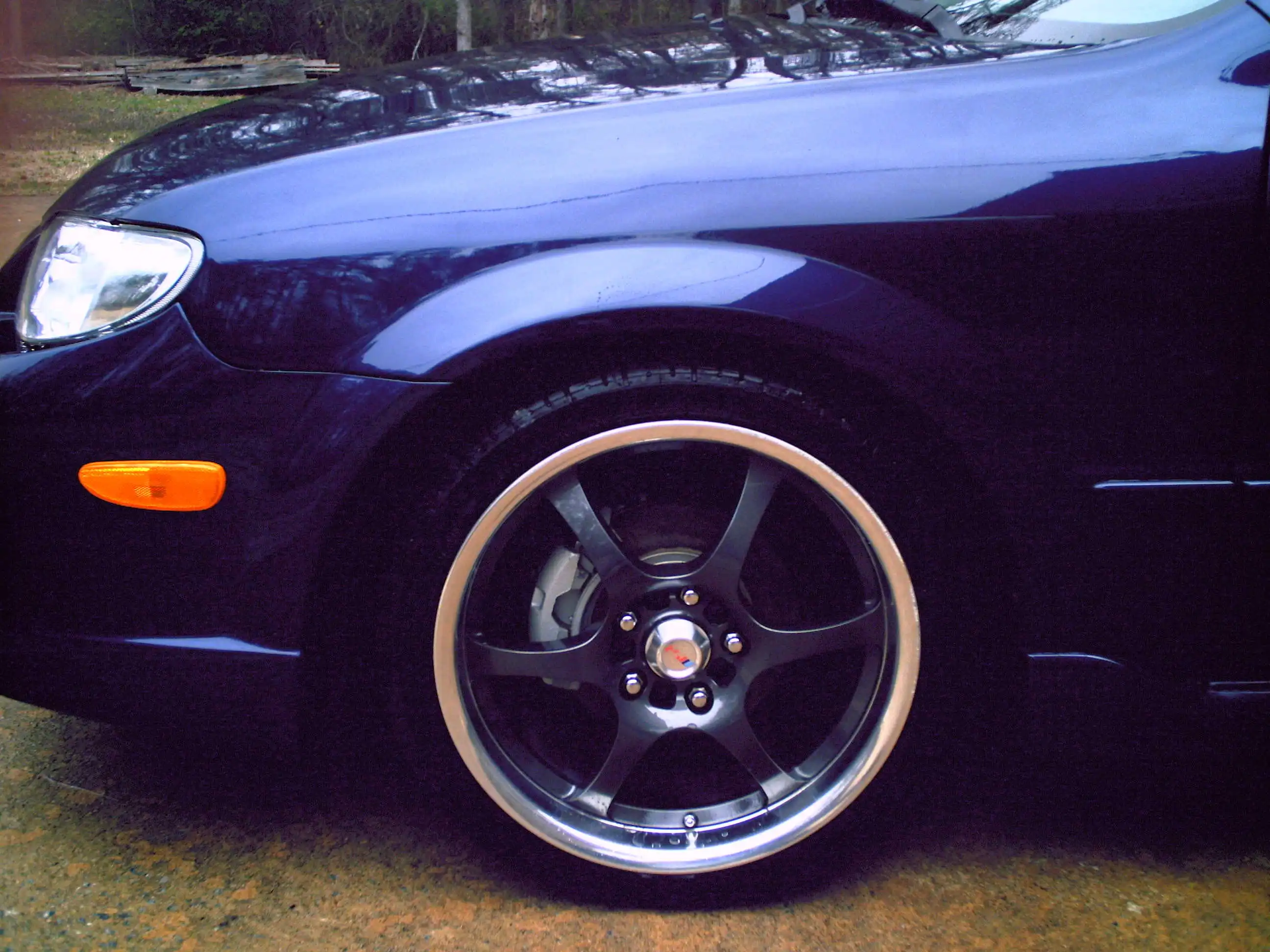

Got any big pics of your ride, cause if that's yours in the avatar it looks pretty clean. I'd like to see some close-ups.
CBD03 said:
I do but honestly I have no idea how to insert them or up load them or anything like that. If you could help, I would be more than happy to put some up.
Here they are, I tried my best and I will be taking more this weekend and put them up Monday.
