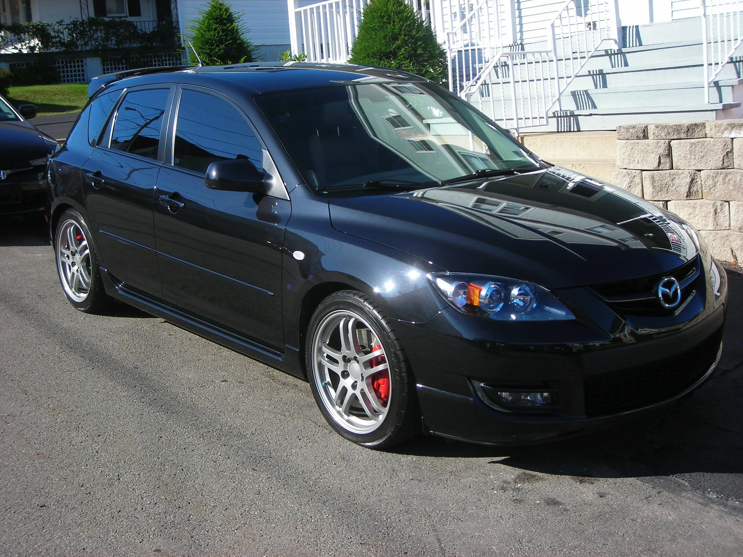

As some of you know, my MS3 was keyed. Just got it back and gave it quick wash. I have a few swirles to work out of it, but the shop did great matching the texture and even did well with color match since they stayed within the panels (i.e. no blend to the qtr). Threw in a pic of the old SVT just becasue (sssh)

The repaired the scratch, the scratch was through the clear, through the paint and into the actual door, so they sanded, filled, primed and painted. They are an excellent shop, I've used them in the past and plan on continuing to use them if the occasion arrises that I need to.

Yes, the entire doors were clear. Luckily my scratch left enough area to the front of the front door and the rear of the rear door that they were able to refinish within the panels. They took all the mouldings and hardware off my door, repaired the scratches, painted it keeping the color within the panel then completely cleared it. No need to blend to the fender or quarter panel, however anytime a panel is painted, the entire panel needs to be cleared, regarless the amount of the panel that actually has color blown on it.
To properly repair a bumper, it needs to be removed from the car, repaired (saneded, filled, primed), painted (partially if damage is contained within small area) but completely cleared. Also, the bumper needs to be overhauled as well, which just means any trim peices need to be removed so it can be cleared properly, if not, it'll peel over time. Once it's cleared, it should be wetsanded, then buffed. To be completely honest, with body work, you get what you pay for. There arn't many ways to cut corners and still have great quality work.
