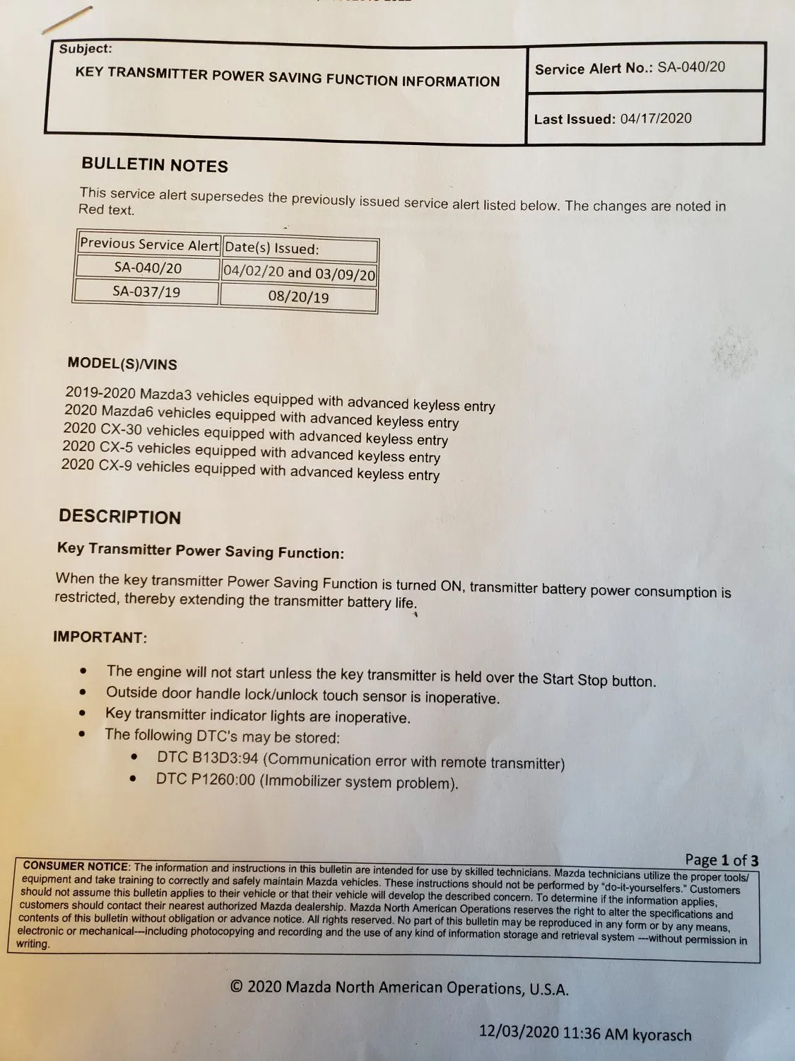

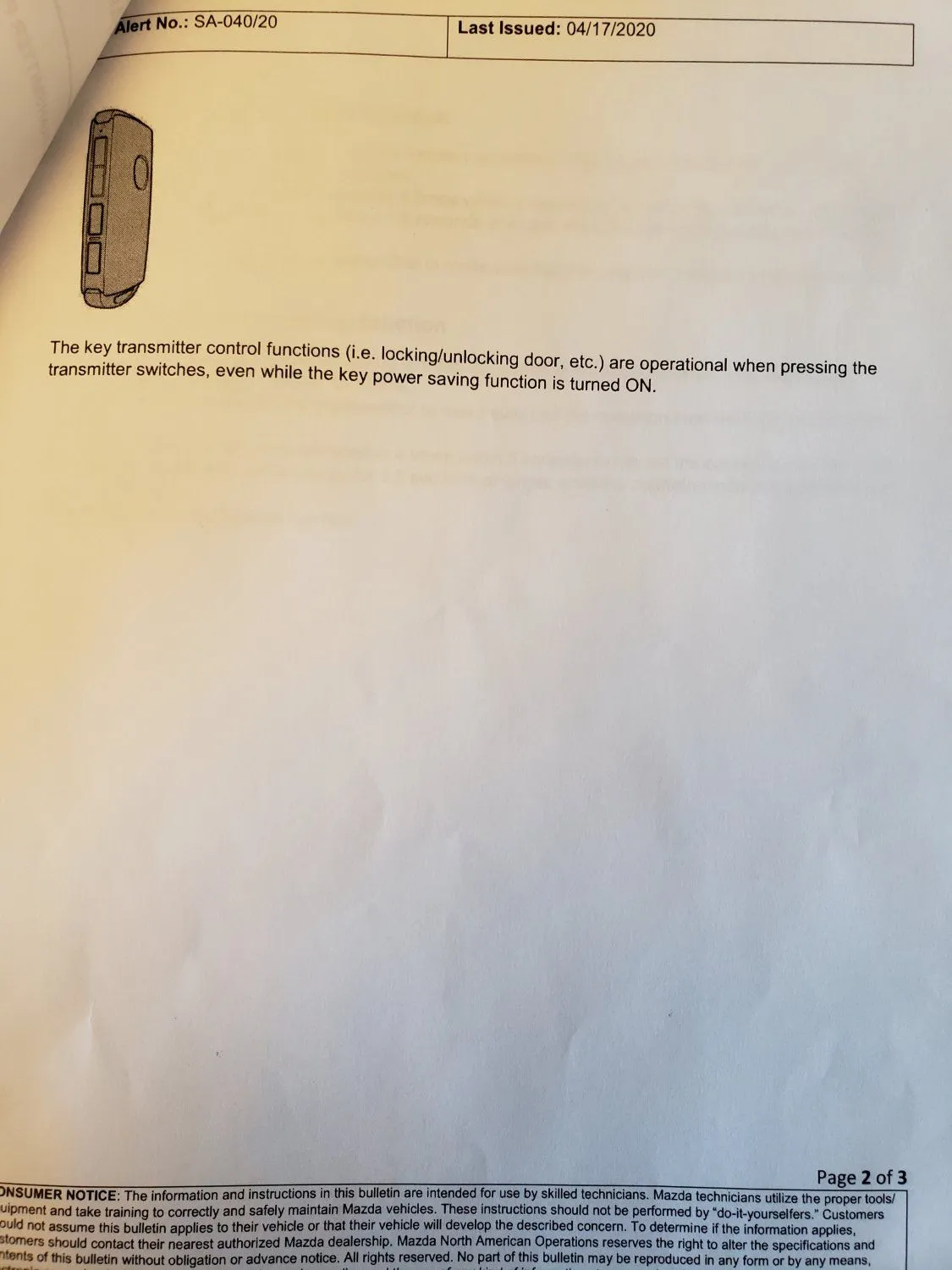

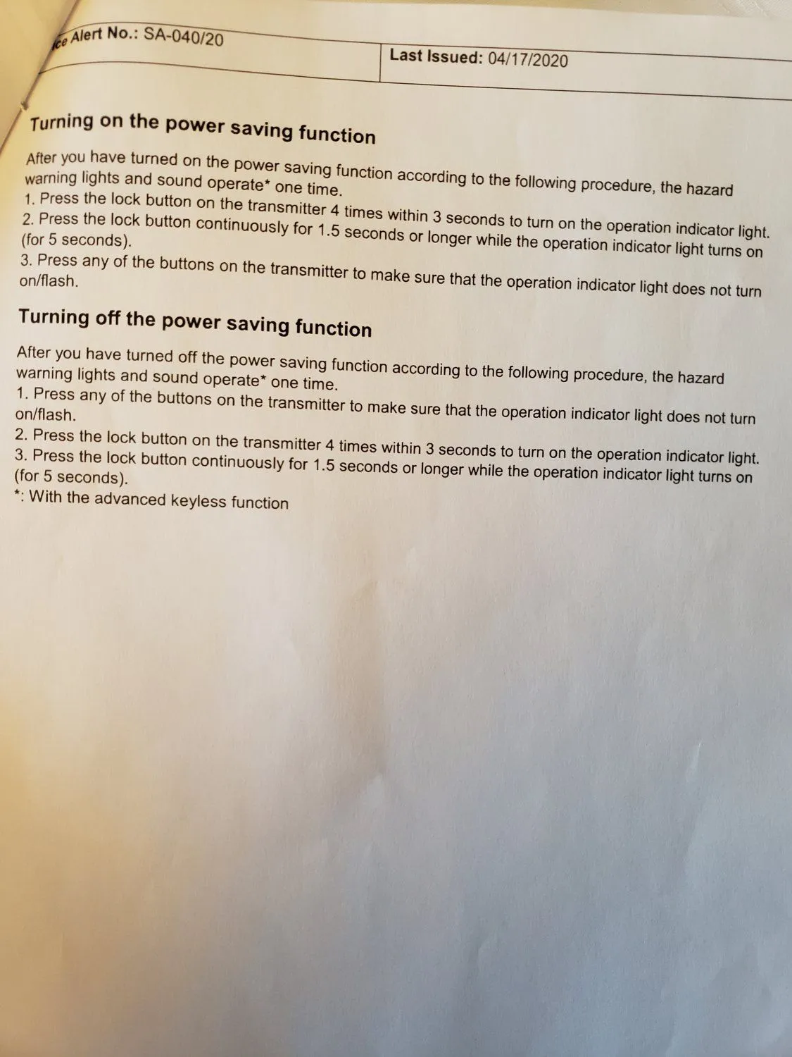

Update for everyone, id been having the issue of either the fob not unlocking the doors or getting the key not found after the car had been started, so I called my dealer and they looked at it for me today.
Turns out, there's a way to put the key fob into power saving mode...thanks mazda.
Next post is the print out of the issue and how to fix it
Zoom in to see the details
Damn! Wish I would have seen this thread 2 days ago. Had this exact issue and went in for service this morning. The fob worked fine and suddenly stopped working. We’re not sure why it went into power saving mode but using the note procedure fixed it.
