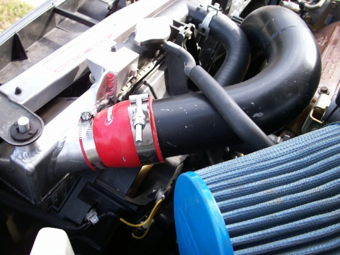

Here are some pics of my setup just to show you how I have it done.

pics...

Since we are in the mood of I'll show you mine if you show me yours...

********** said:
Where did you get that setup!!???
LMAO!!!!!!
Uhhh... I made it from scratch. Ya, I melted the stainless steel in my melting pot and then welded the pipes together myself!
Nah.. these are the pipes that I bought with the Street Unit SMIC. And they are working quite well!
