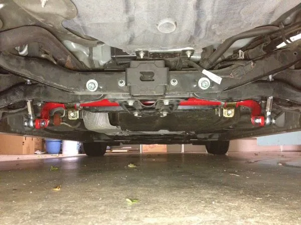

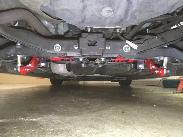

Decided to swap out my racing beat rear sway bar with one from JBR. The RB one was a little narrow for the 2012 5. It placed the brackets at the start of the bends and was eating bushing, breaking brackets and causing slight binding until the bushing were worn. Note: RB does not make a bar specifically for the 5. I used a 3 bar, removed the stoppers and added shaft collars to adapt it to the 5.
JBR Bar

RB Bar

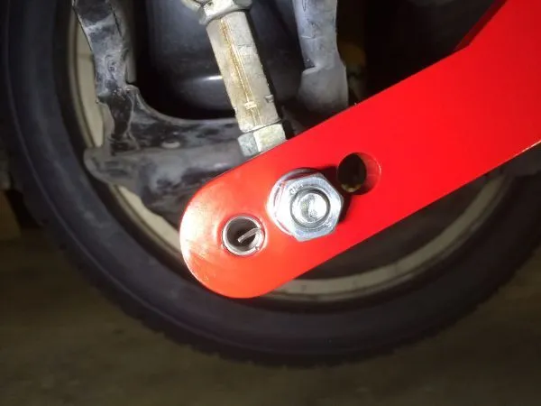

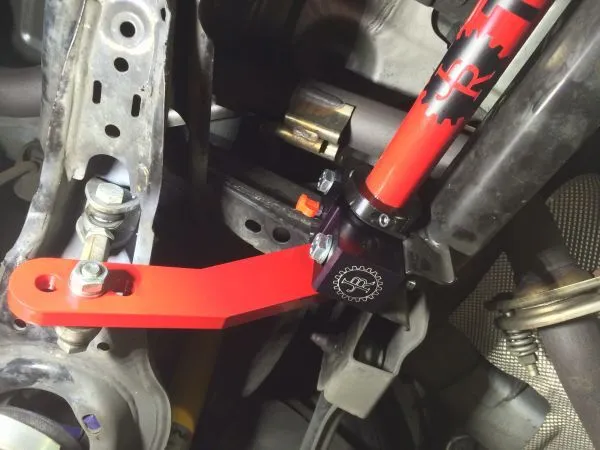

The first things I noticed with the JBR bar was it's much lighter. Quality and workmanship is top notch. It's thicker at 1.25in (31.75mm) vs racing beats 1.062in (27mm) but RB is solid. The JBR bar has 3 settings vs the RB's 1. The last thing I noticed is that the endlink holes are drilled at 12mm. (uhm) Both the 3 and 5 have 10mm endlink studs. A quick email to JBR yielded "All of our sway bars have the 12mm holes. We do this because the 2mm difference is insignificant. Also because many choose to upgrade the rear end links to the Mazdaspeed OEM or OEM equivalent and this wouldn’t be possible if the holes were only 10mm."

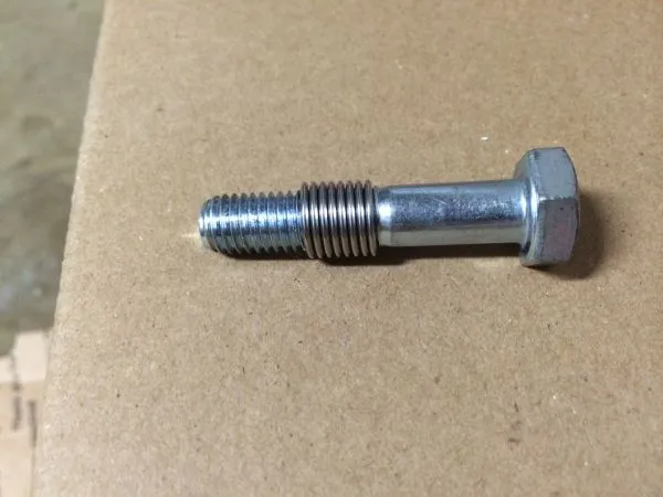

I didn't agree on the idea of relying on the clamping action to hold the endlinks in place so I set out to find or make a spacer. Going through my junks I came across some heli-coil inserts. They were the correct thread m10-1.5. I placed them on a bolt and voil! almost a perfect 12mm.
Heli-coil insert on bolt
attachment.php
Heli-coil insert in the softest setting

other notes: I opted for the upgraded brackets and have AWR endlinks. The AWR endlinks do make a little more noise but Tony's newest ones are 10x better that those I got from him just a few years ago for my NC Miata. He is using teflon inserts and big rubber o-rings to bring the noise down to a minimum. I switched to AWR's rose joint endlinks after breaking my stock set and 2 sets from corksport.

No problem. From what I understand, the MS3 endllinks aren't any stronger. Yes, they have a larger 12mm bolt but the rest of the hardware is the same. Plus, I already have AWR endlinks that are holding up perfectly well.

Nah, you really don't need such a stiff bar. But for the 2012, because the bracket mounts were moved further outward, the style of the bar makes it the most logical choice. As in my OP, the bends on the racing beat placed the brackets practically on the bends. Also, there really isn't a 5 specific bar. I didnt want to have to guess that it would fit.

With the RB bar, I went through 3 different end links. I didn't notice any difference in ride between them. The AWR link do make more noise though. The only complaint I have about the AWR links is that at stock height I feel they are too long. They are significantly longer than the stocks and place the bar at a less than ideal angle, reducing it's effectiveness. Now that I'm lowered it's a little better but ideally I'd still like them a little shorter. I may try to change out the threaded stud and lower male rose joint for a female joint. Making it similar in design to the discontinued tripoint one. I would loose the fine adjust-ability but 1/2 turn increments is still pretty adjustable.
