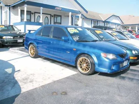

I just purchased this MP3 for a trade of my 2001 Honda Accord Coupe. I had a MSP in 2004 and I wanted to start my own turbo project. It is currently in the process of getting a 3-4-5 gtx gear change, MSP welded LSD, stage 3 clutchl, and fidanza flywheel, performance motor mounts. Pics will come soon, to bad I already started on paint interior piece that were yellow before I took pics. OOPS.
