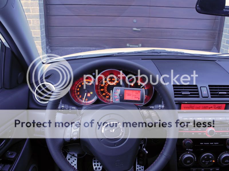

Here is how I had my DH set up a couple of months ago:
I have since moved it over to the right a little so that all of the gauges are now visible. The DH used to cover the lower part of the speedometer, which I got around by displaying the speed on the DH itself. Now that I moved it over a little, though, everything is visible. Basically, I moved it over so that the right edge of the DH is in line with the right edge of the console cover. The only thing that is really blocked is the odometer/tripometer (which I never care to look at) and the fuel gage idiot light.
