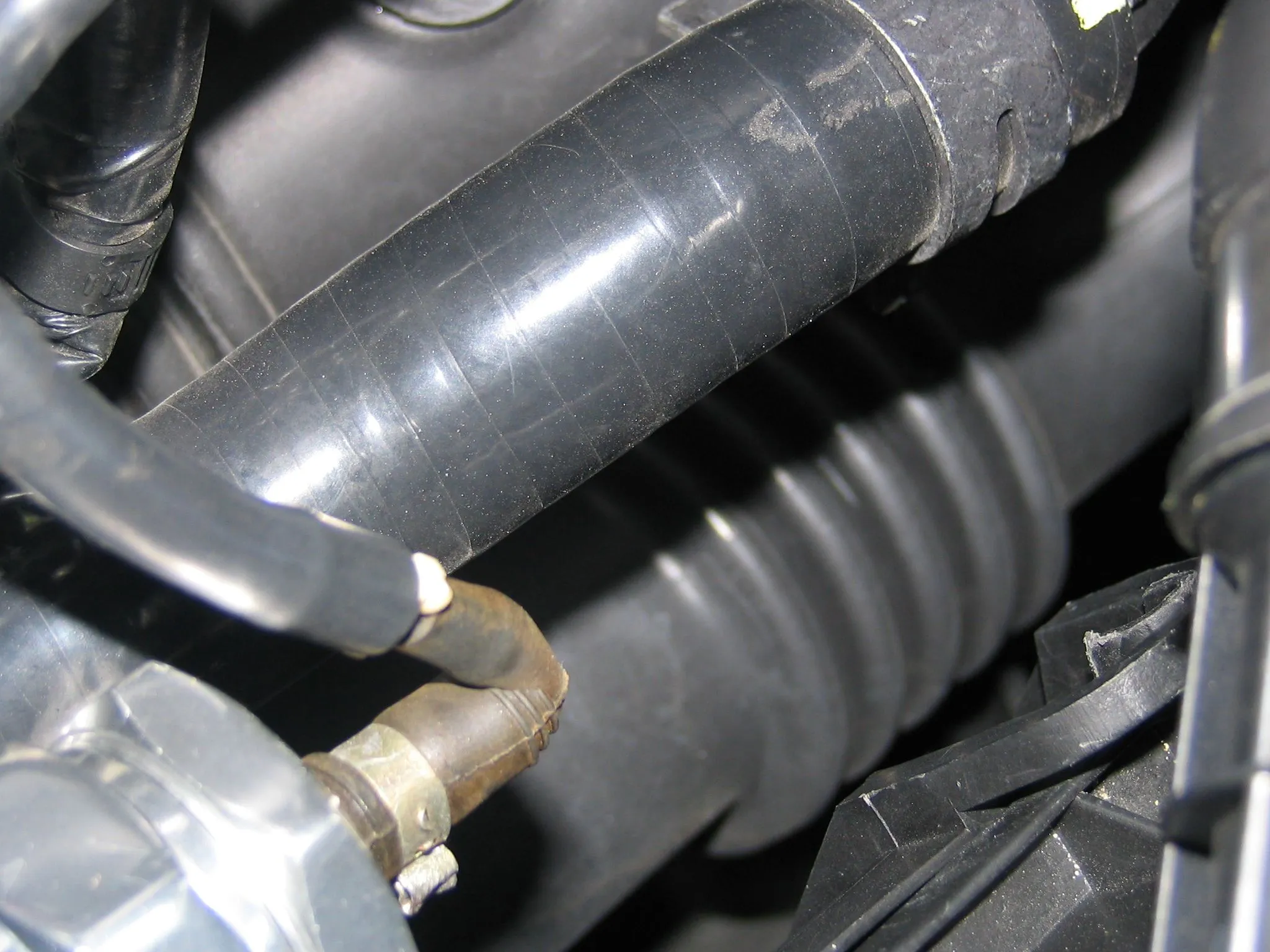

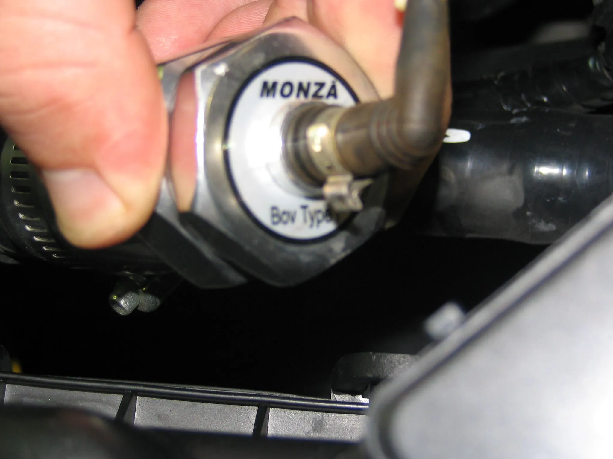

Took some pics at lunch of what I now know is a blow-off valve, not a boost controller, upping my boost. What do you guys think of the install and product?

If I am seeing things correctly, it looks like he put in a blow off valve and then blocked off the recirculating hose that goes to the cold pipe. From what I know a BOV can not change the boost setting. If you don't have engine management your car should be running like crap venting to the atmosphere.
If there is no other hardware running off the vacuum lines you may want to take a peek behind your glove box or under your passenger side carpet. Maybe there is some engine management with the boost controller right by the unit. Also check the waste gate to see if there is a spring between the waste gate arm and the cover. This is known as the spring mod, and would be hard to spot if you didn't know what you were looking for.
You should get rid of that stock rubber elbow, just use a longer vac line. It could easily pinch and then you'll be running very rough and stalling. I know for experience...
