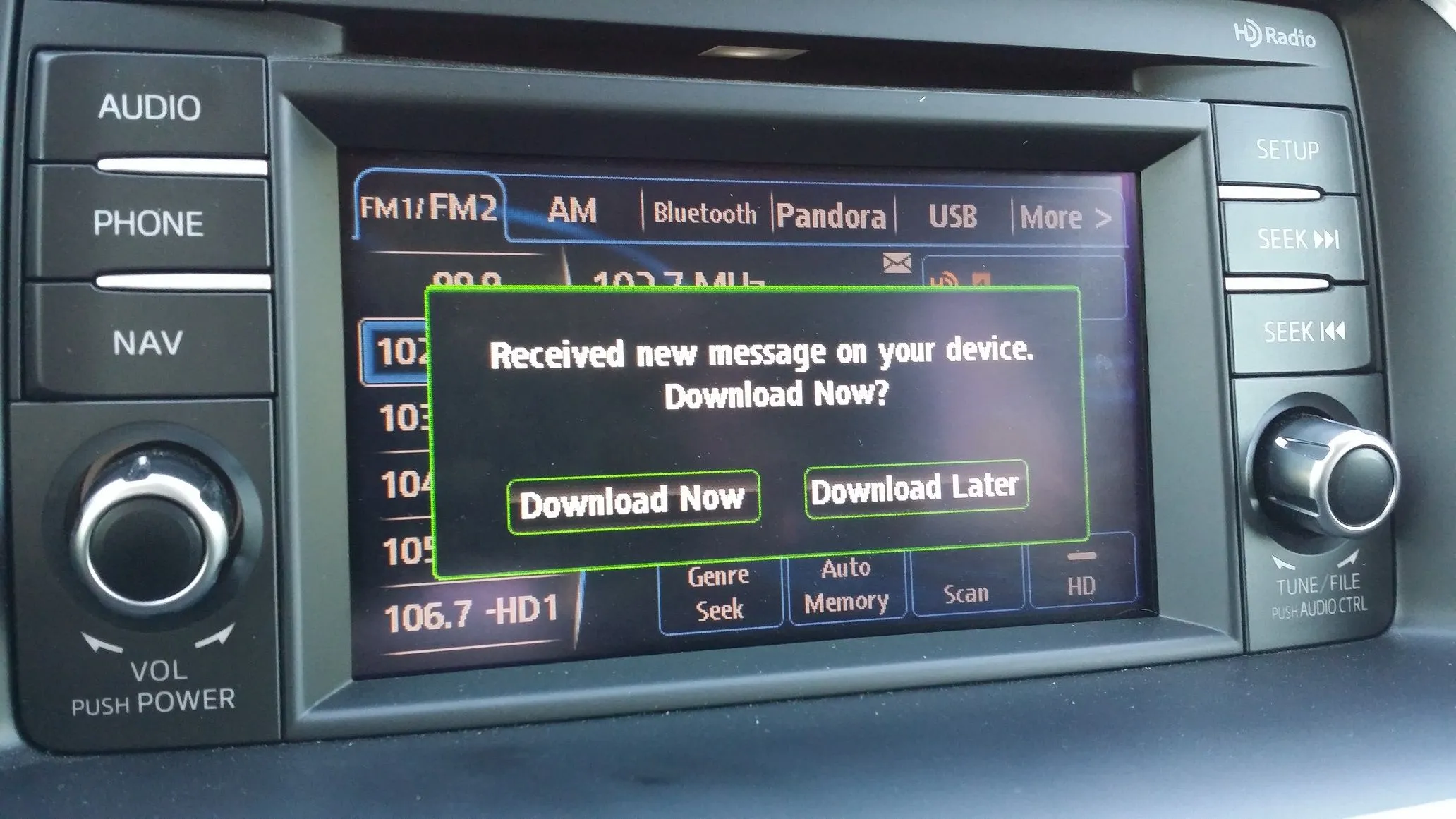

OK, here's how it works on my 2014 GT...
When a text messages arrives, this is the screen that shows:
After you tap the "Download Now" button, this is the screen that shows. You simply tap the little loudspeaker button (I have circled it in white) and the message starts to be read,
If you tap the other button by mistake while driving, you will get the following screen. In that case, just tap the "Read" button and the message will be read.
I hope that helps!
